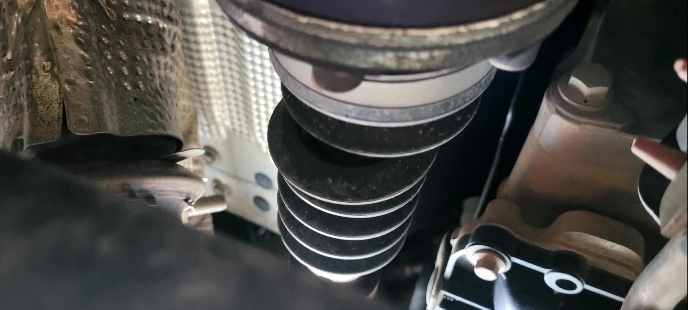

Well I have had this issue for a few months. Also had a burning smell since new, usually when raining. Figured it was the undercoating burning off but never really went away... today I found this. Front drive shaft boot is torn and missing a section... no grease for probably months. Bring to dealer tomorrow, who missed it for the last two oil changes, questioning their 83 point inspection.

At the transfer case or differential?
