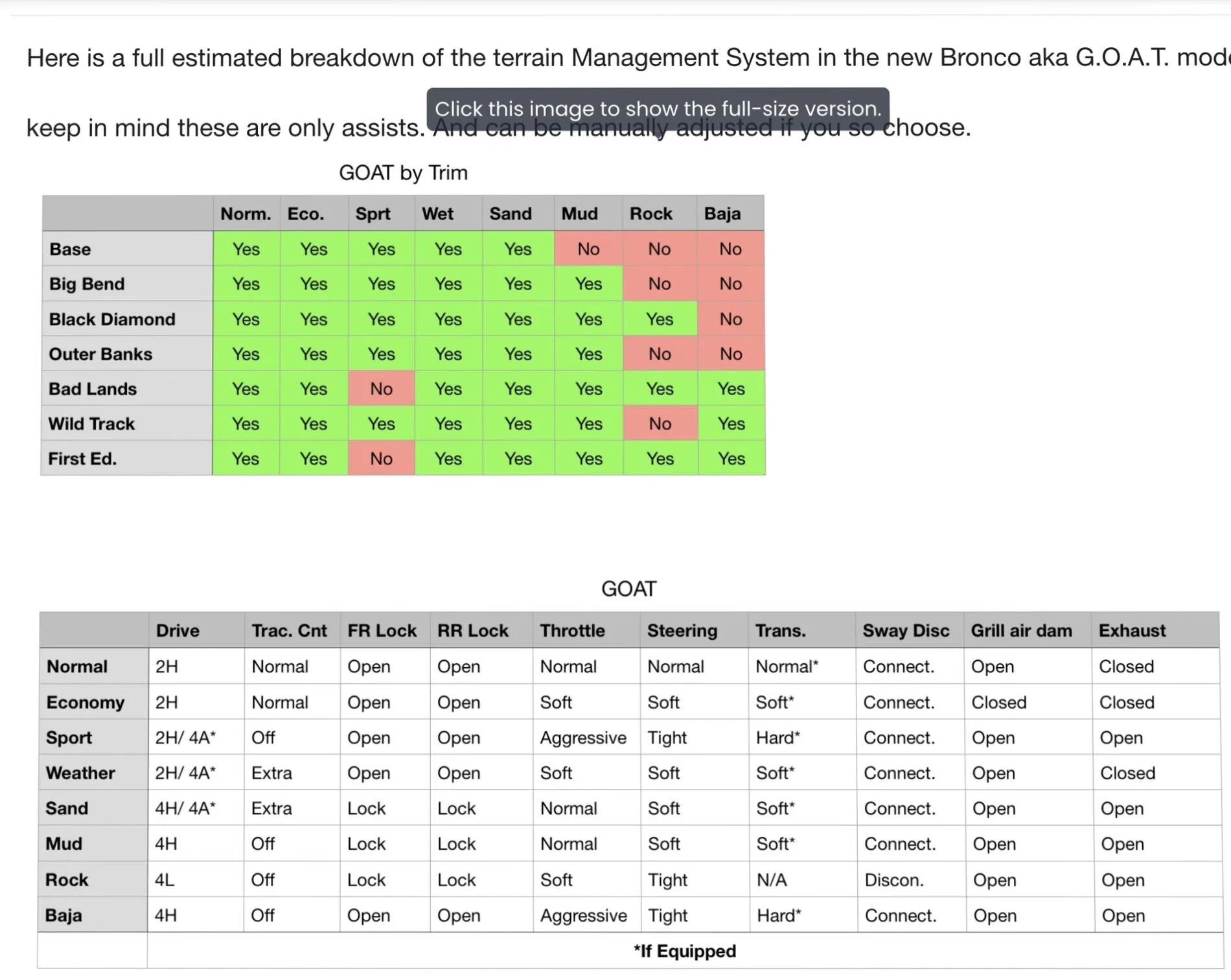

It is all electronic now. And the buttons light up when activated. So it would make sense.The rock crawl mode will automatically lock the difs, disconnect the sway bar, and change the driveline to 4 LOW.
Also would explain how that “tight turn” mode works
Simply turn it on once. And the diffs will be locked until you get to a turn. As soon as you start turning tight. The rear diff unlocks, inside wheel brakes and you turn super tight. You straighten the wheel. Tire unlocks. Diff relocks. All by it self.
Vs what a wrangler would have to do.
Unlock rear end by hand.
Apply e-brake.
Turn.
Release brake.
Re lock rear.
Lots of buttons to push.
