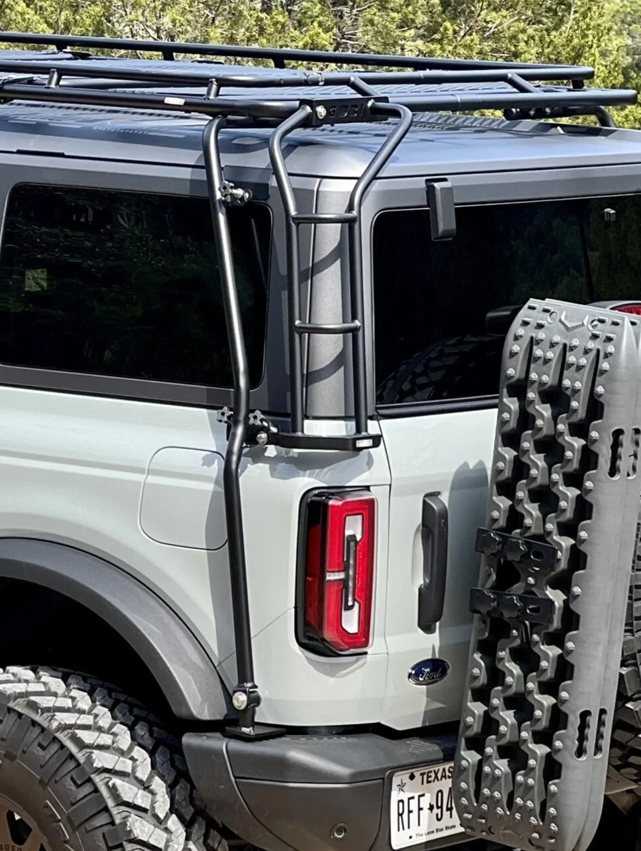

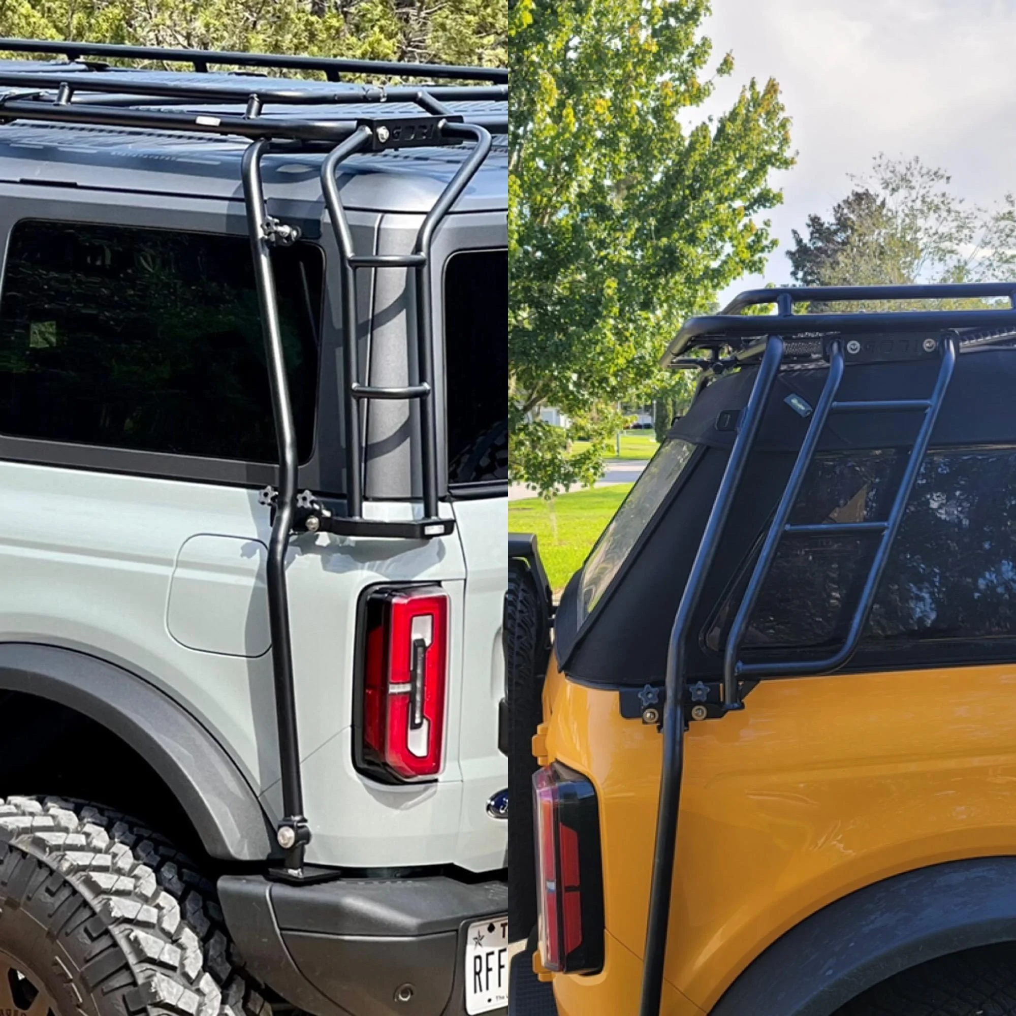

To ALL my GOBI friends,
I was one of the first orders and got my Stealth rack for MIC 4dr in my garage, but in recent news it seems MY23 builds with MIC are potential delayed another year. My question for you all is “will my stealth rack work on a soft top or is the GOBI soft top stealth different for soft tops?”
@GOBI Racks
It will work for a softtop. The difference is the ladder. Softtop ladder is on the side. Hardtop ladder is in the rear.
And I have 2 rear ladders :(

You can either order new ladders from Gobi and see about returning your Hardtop ladders or just not use the Hardtop ladders. I think the issue is with raising the back part on the softtop.
The corner ladders are in the way of fully retracting the soft top. I need to find a pic of soft top partially retracted with GOBI

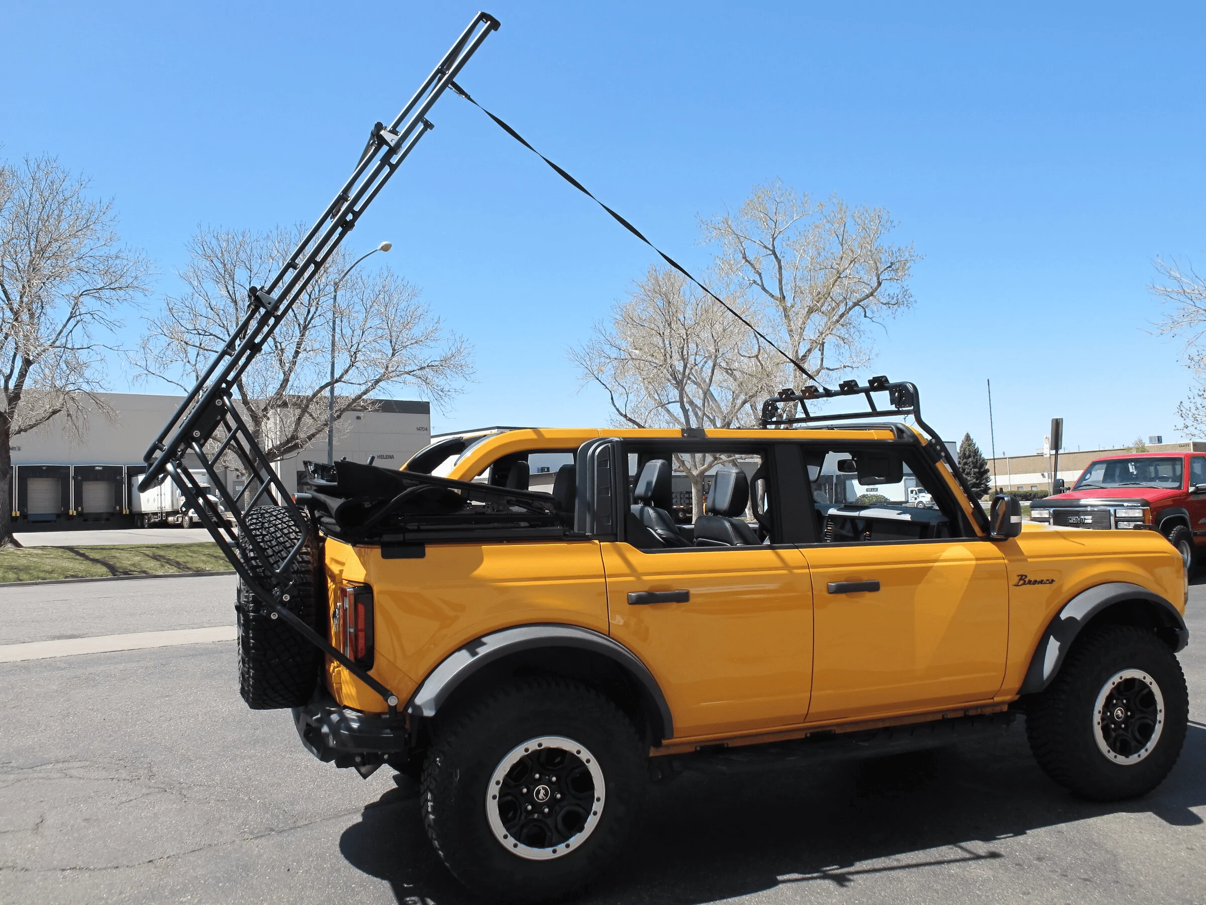

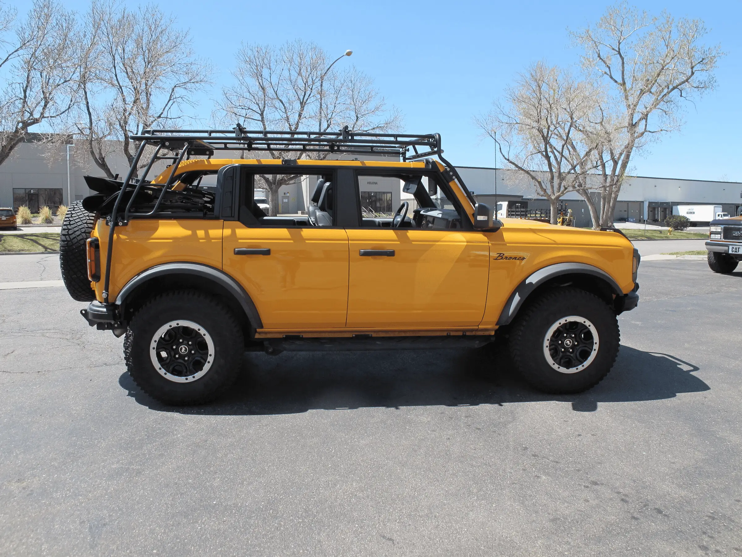

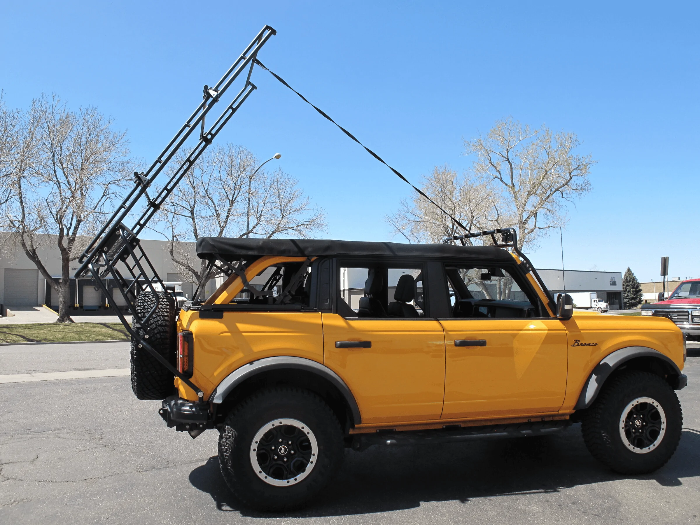

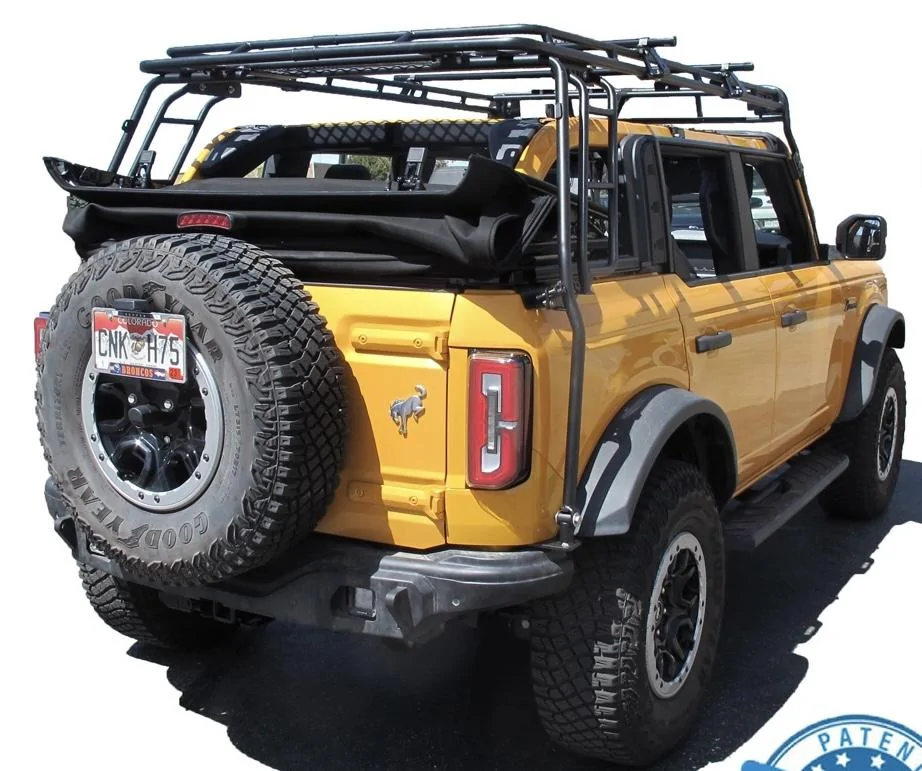

Can someone describe, maybe post pics/video of how you retract factory or Bestop soft top with GOBI rack on?
I’m assuming VERY similar to the Jeep process:
This sequence? See pics
Ford Bronco GOBI Bronco Rack Released [Official Specs & Photos] DBAC7505-95A5-4688-A87B-D518FB6CE761
Ford Bronco GOBI Bronco Rack Released [Official Specs & Photos] 15E80AB5-EB16-4807-83F3-3612F37EF4D6
Ford Bronco GOBI Bronco Rack Released [Official Specs & Photos] 113DD82D-B84B-4DC4-86A1-CCCBBAA4E1CC
With final open position AND need to retract rack to retract soft top, why wouldn’t the corner ladders work/fit?

To retract soft top do you have to take side panels off every time? Even with Bestop?
You cannot retract the Bestop with the Gobi rack. Since it doesn’t retract fully like the OEM version. So, essentially losing all soft top capabilities. Outside of safari mode (rear and side windows removed).
As for OEM - You cannot go to position 1 - only position 2 (fully retracted) - which requires you to remove the side and back window.

A couple videos and I get it now.
The Bestop ONLY goes to position #1 and that’s too high to fit under GOBI. You can’t fully retract Bestop at all. You can only remove side/rear windows for an open feel.
The OEM top fully retracts ONLY after you’ve temporarily raised the GOBI and of course can’t sit in position #1. You cannot lift the rear of OEM with GOBI in down position. To retract OEM you must remove side windows.
