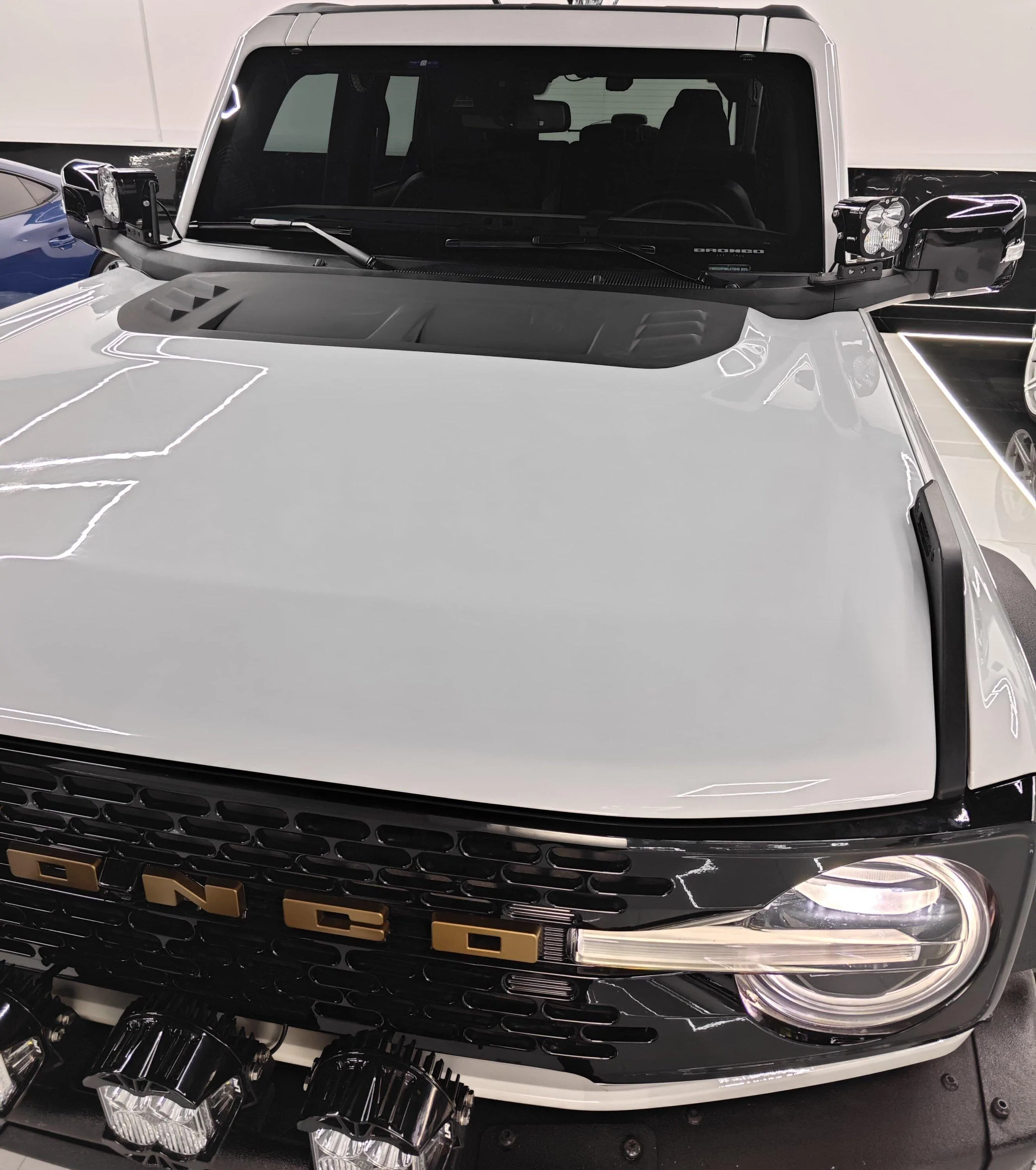

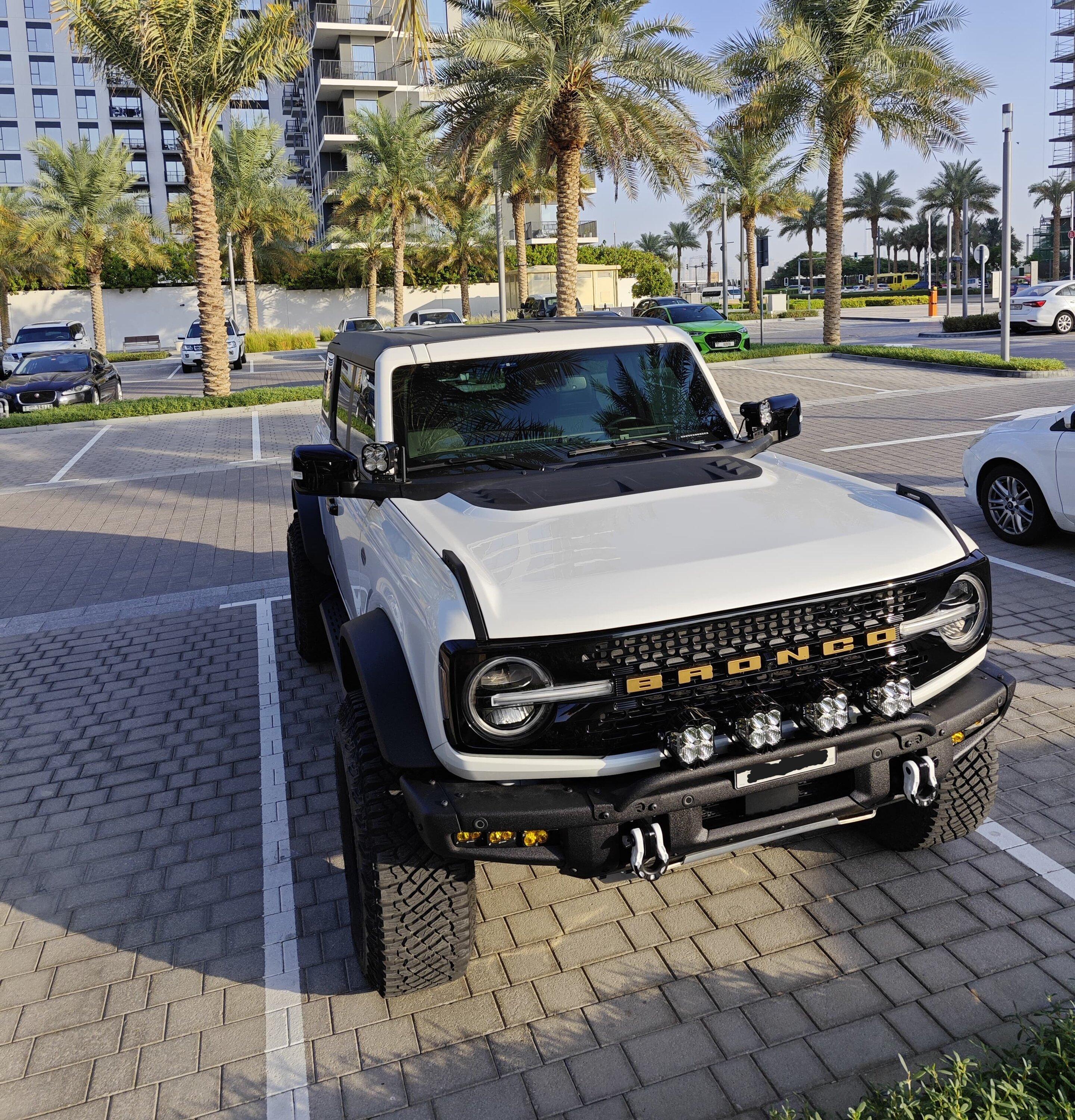

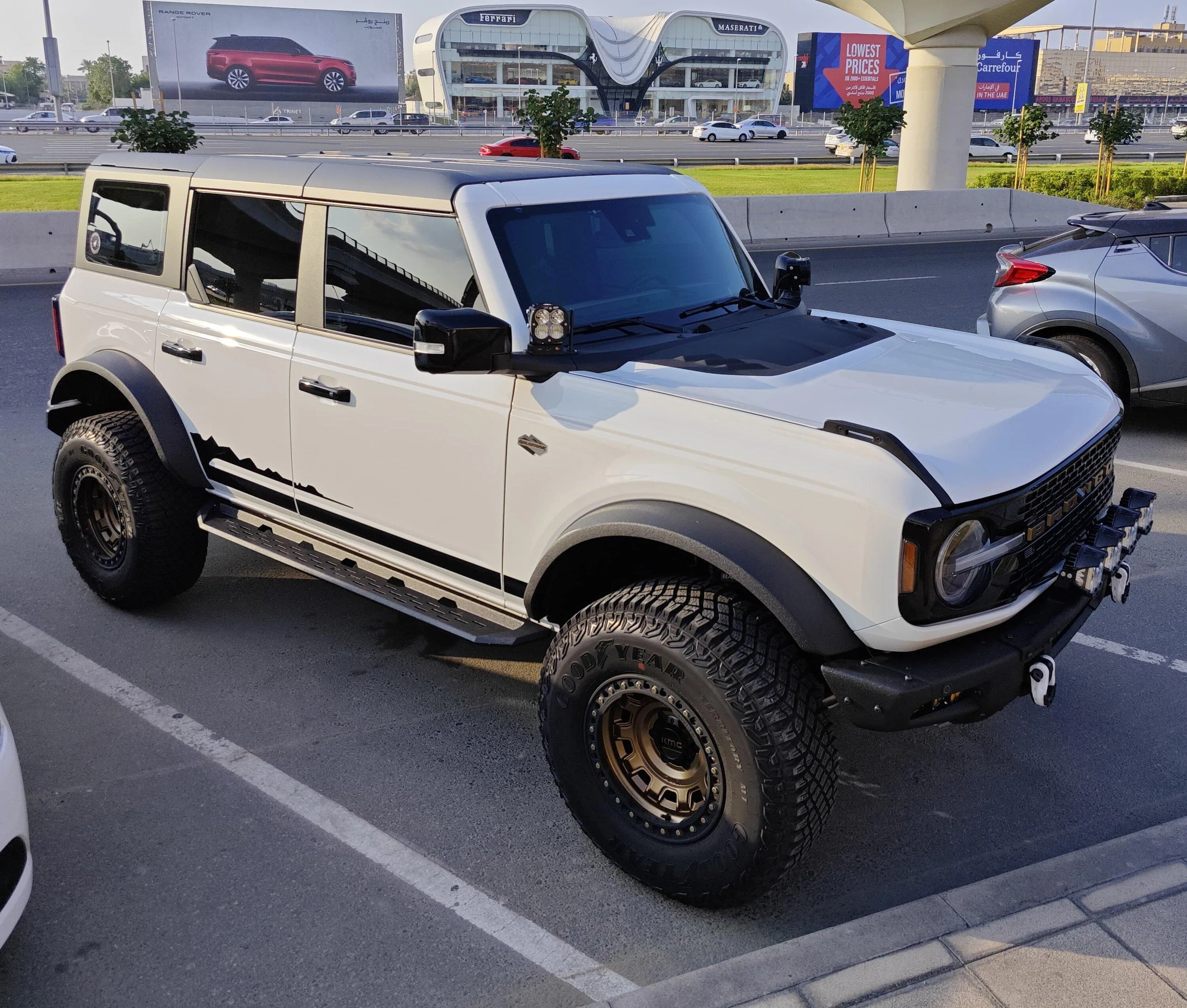

So I recently decieded to try paint match my wheel colour to the Bronco letters.
Managed to find an easier solution than replacing OEM letters. Rather than replace them, just get adhesive caps that stick ontop.
https://www.ebay.com/itm/185847993291
I bought these in black and just got them resprayed at a local garage. Turned out pretty good :)

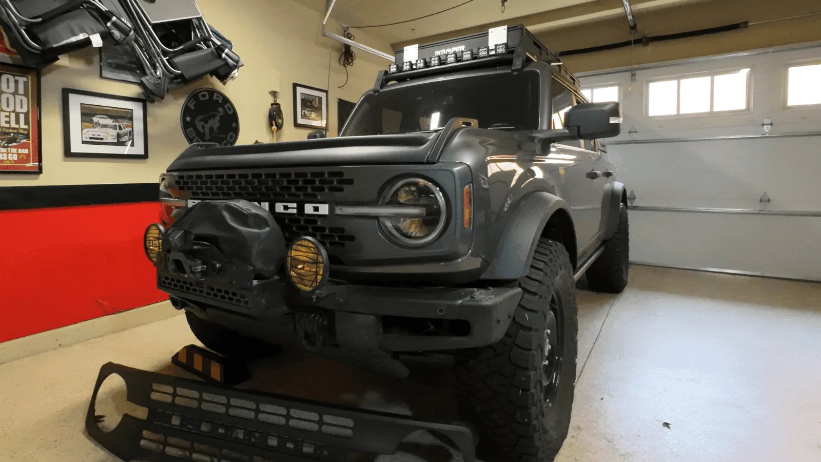

Black Diamond grill on a Badlands Bronco
Got it done. Ordered a new grill from Ford. Then ordered replacement letters from UPR Products. Worked like a charm! They mount just like factory letters. I'll have a how to video coming out this week on my channel.
I can confirm, not all grills are swappable. I had to do a touch of trimming to make it fit.
