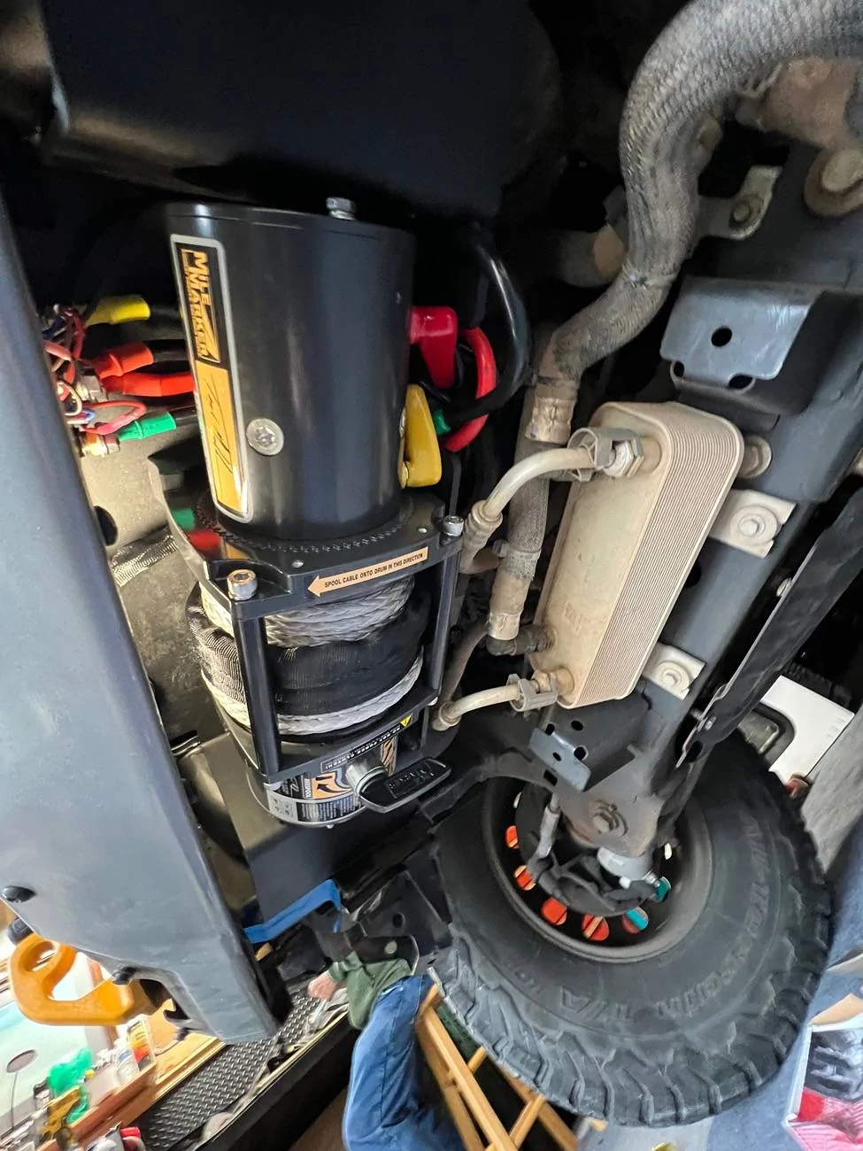

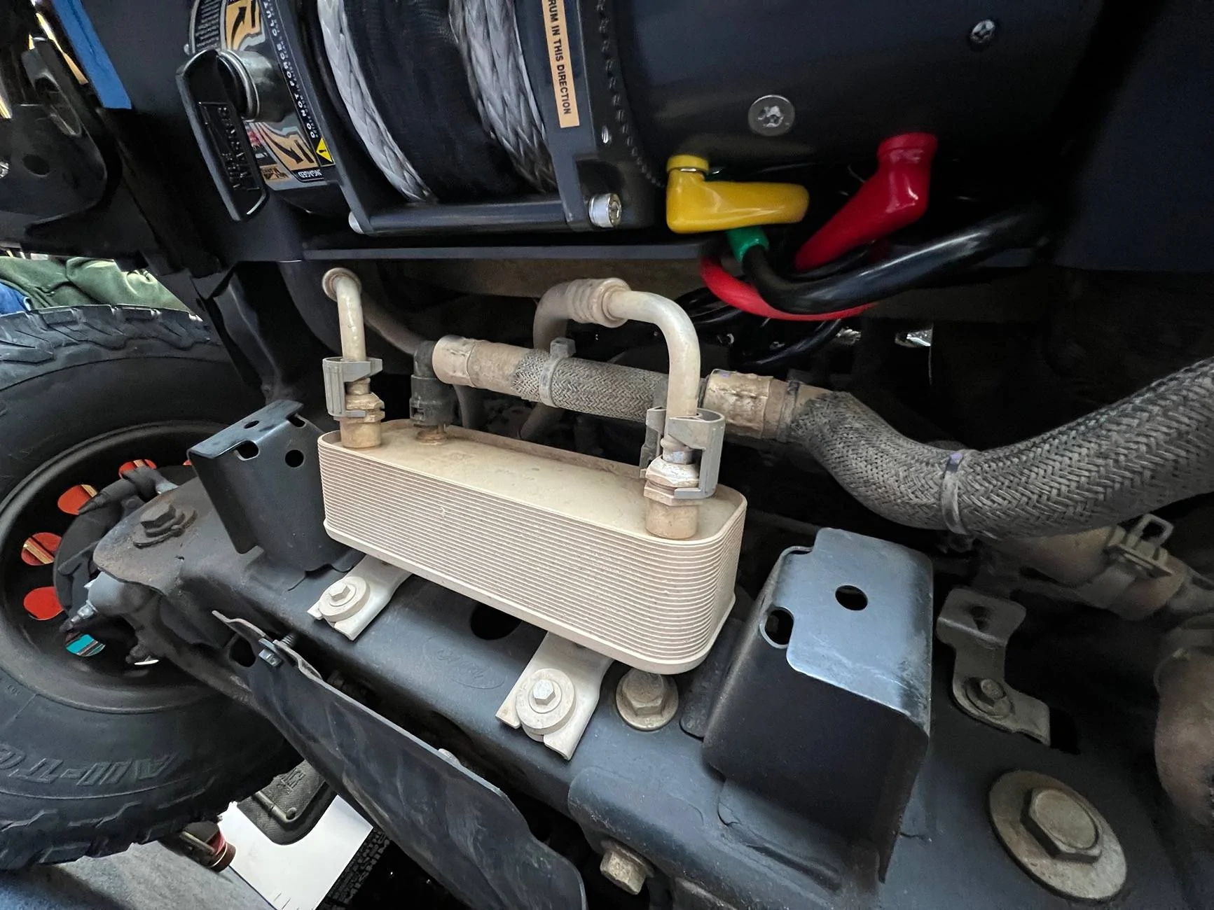

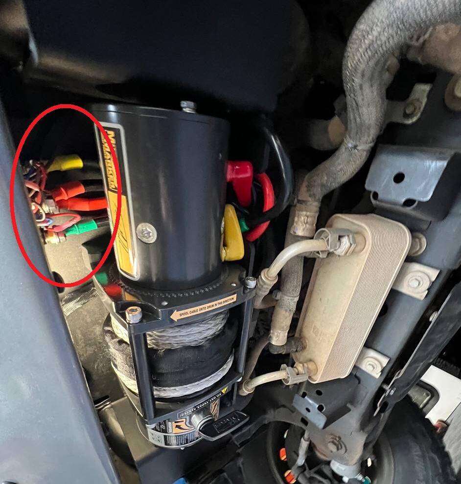

If you’re looking for a hidden winch that uses the stock modular bumper. The Hammer Built Hidden Winch is the one. I like that it doesn’t hang low or replaces the stock skid plate. Also it doesn’t interfere with the Oil cooler. It tucks up high and no worries of smashing it on a rock. Im totally pleased with it so far.

Thats where it mounts to the plate. The winch is IP67 rated.

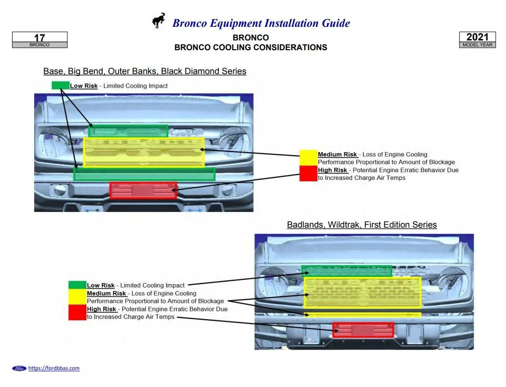

Is there a tread on this with video of the erratic behavior?
No clue, but you could ask Buckle Up Buttercup, she had an external winch mount on her original ride which covered this area and she suffered poor gas mileage and performance issues, temps on Ecoboost's are rather important to control or the ECU will take over.
