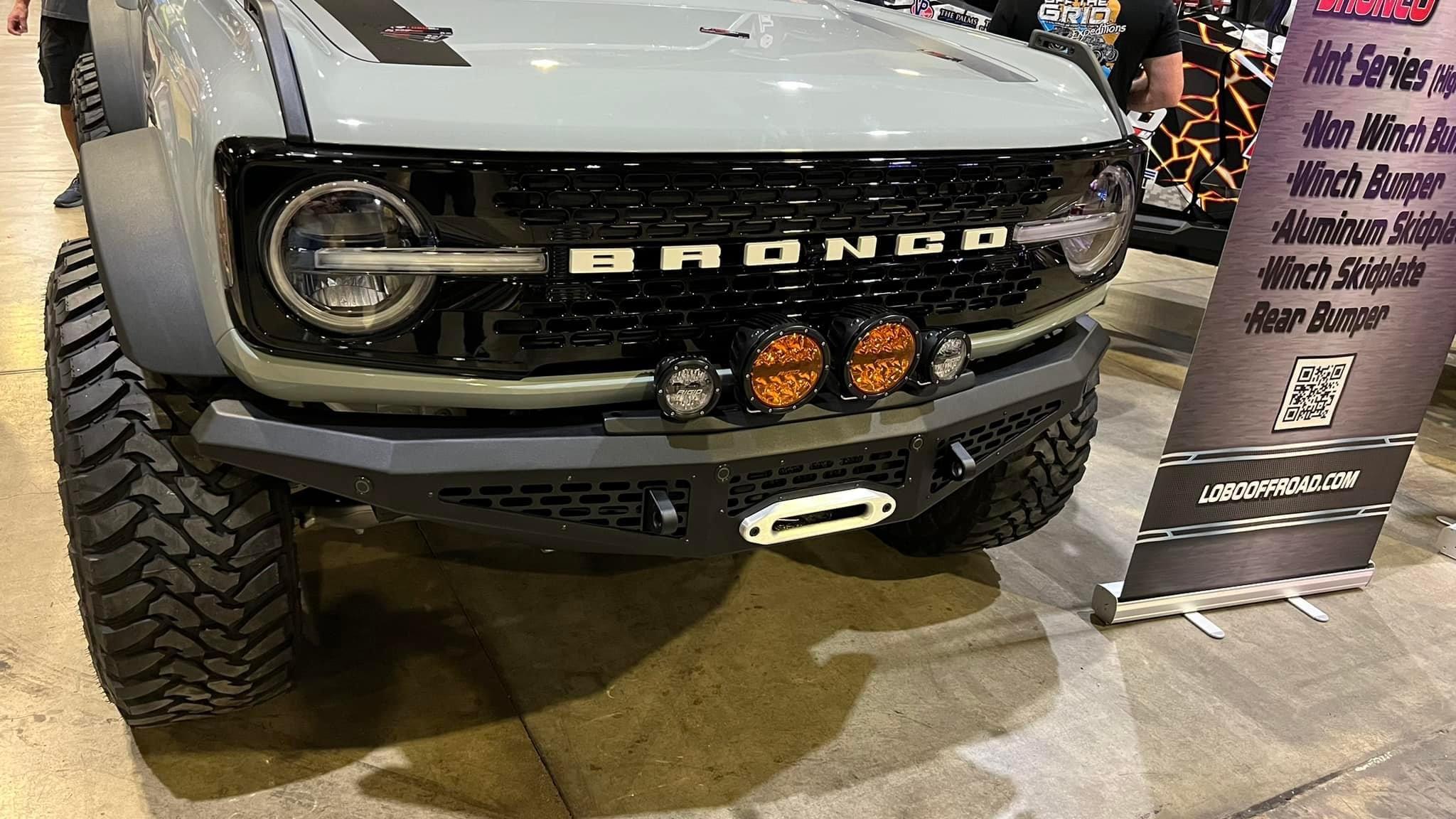

The only other one I have seen is made by lobo off-road.

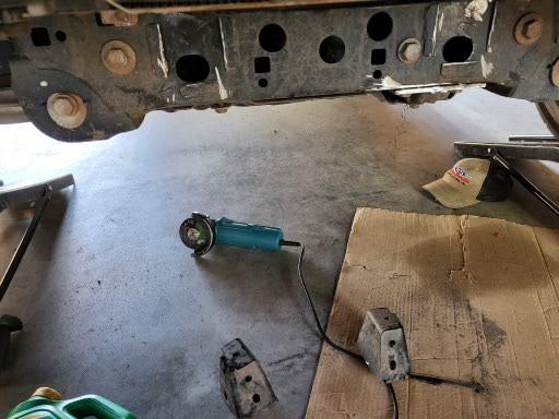

I really like my Rough Country. Waited a month to install it for fear of cutting frame extensions. Once I jumped in it was easy and painless.
Side note: Instructions say to cut off front diff mount extension, but I don't think you would have too, test fit first.
Are you talking about the winch plate for their HNT bumper? I’m not seeing one on their website for the MOD bumper.

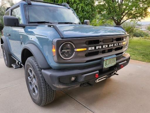

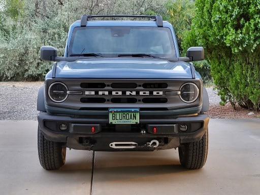

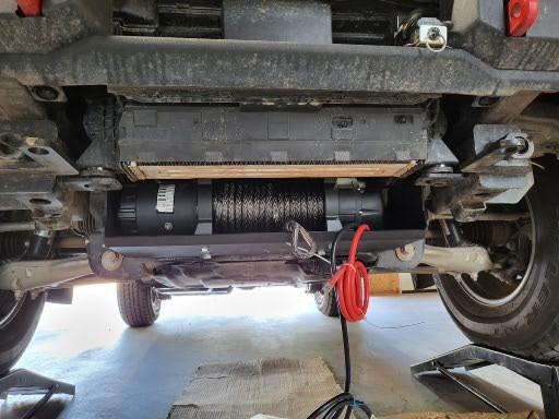

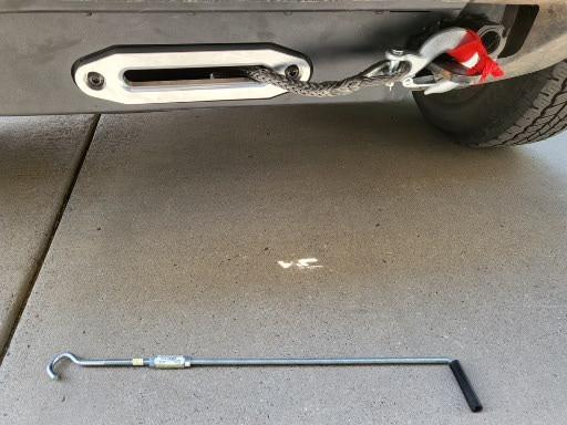

This is the plastic bumper. I don't really have a thread, posted a few pictures here and there. Install was easy enough with the 2.3, it would be significantly more complicated with a 2.7 due to trans cooler relocation. RC engineers thought of everything. I had to trim bashplate to fit with my Blue Ox tow base plates, but not bad. I used a Rugged Ridge 10K which worked well with no modification. The Rugged Ridge is rated IP68 waterproof, and remote control only. I would have preferred remote and wired for reliability. Also, it's supposed to have a 5 year warranty, but I have contacted RR about getting an extra remote and battery and been ghosted ...so...
I built a tool for engaging/disengaging the clutch.
