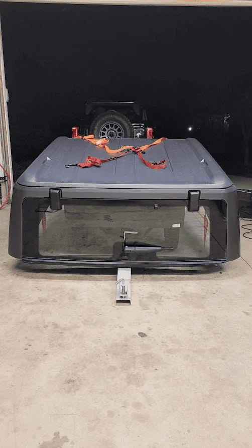

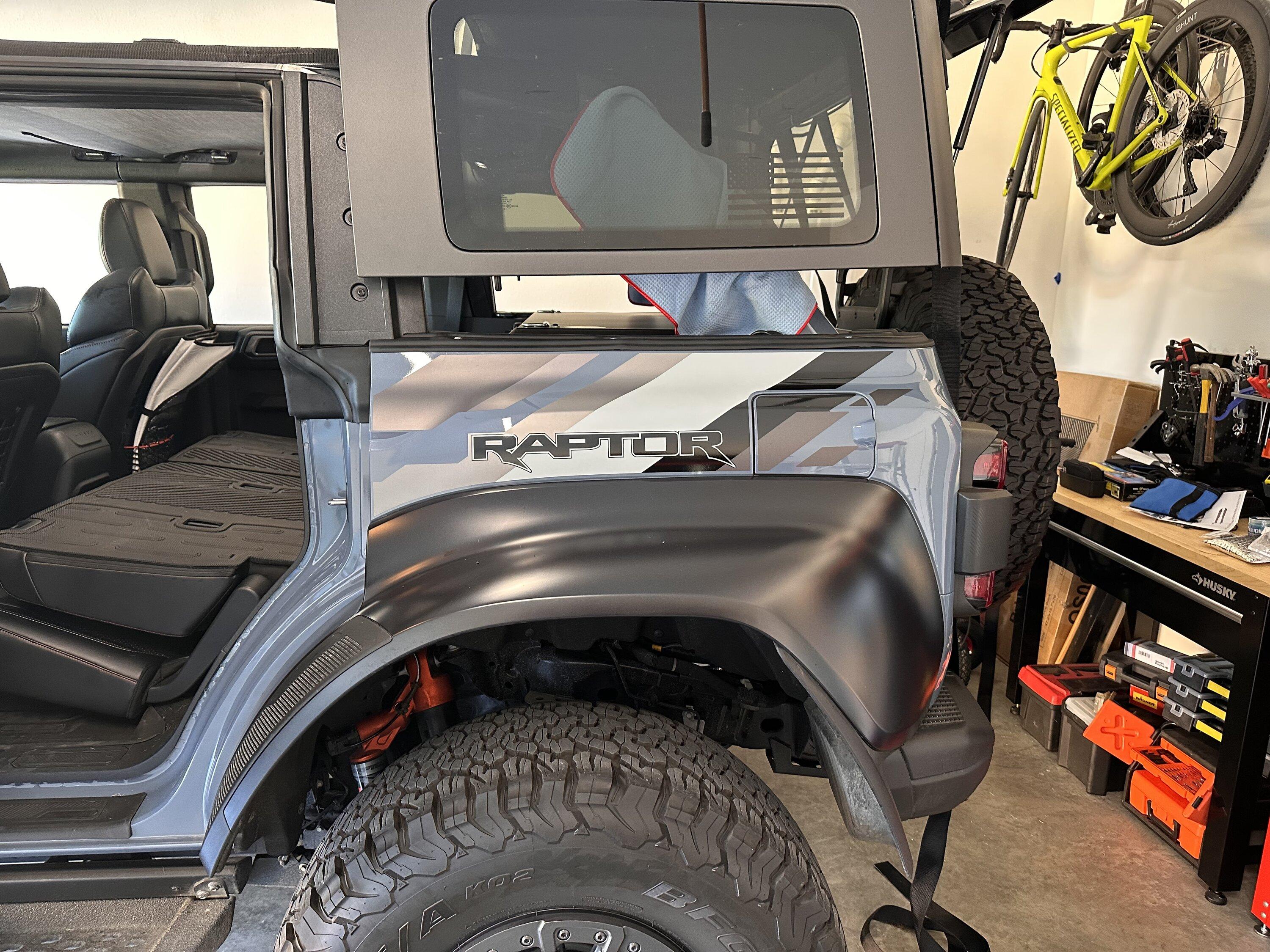

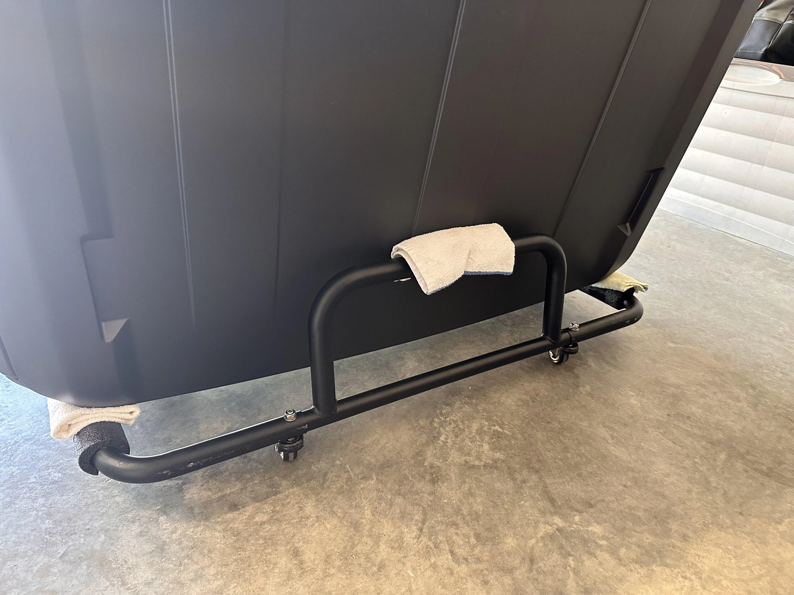

As promised, he’s a few pictures of my cart setup as well as the process I go through to install the top. Today was a little more challenging that others to put the top back on as I had installed some of those Cargo Side Shelf Protectors but realized when I was screwing in the bolts that the top was no longer aligned with the bolt holes. After reading up I found out that they are NOT compatible with the hard-top as they don’t have a hole for the forward locating pin AND they seem to throw off the alignment of the top enough to not reinstall the bolts.
I’ve also been highly curious of a TopLift/RollNJack solution to minimize the work involved but the TL Pro won’t work with my setup as I have the Tuffy Enclosure installed which blocks the TL Pro from rolling into place. The TL Venture Pro appears to be an option as its design uses arms that will fit in the 13” gap between the top of the enclosure and the top of the window line. I’d prefer the RollNJack but can’t get a response from them on the length of the arms on their design.
Anyway…as promised here’s some pictures of my cart setup.

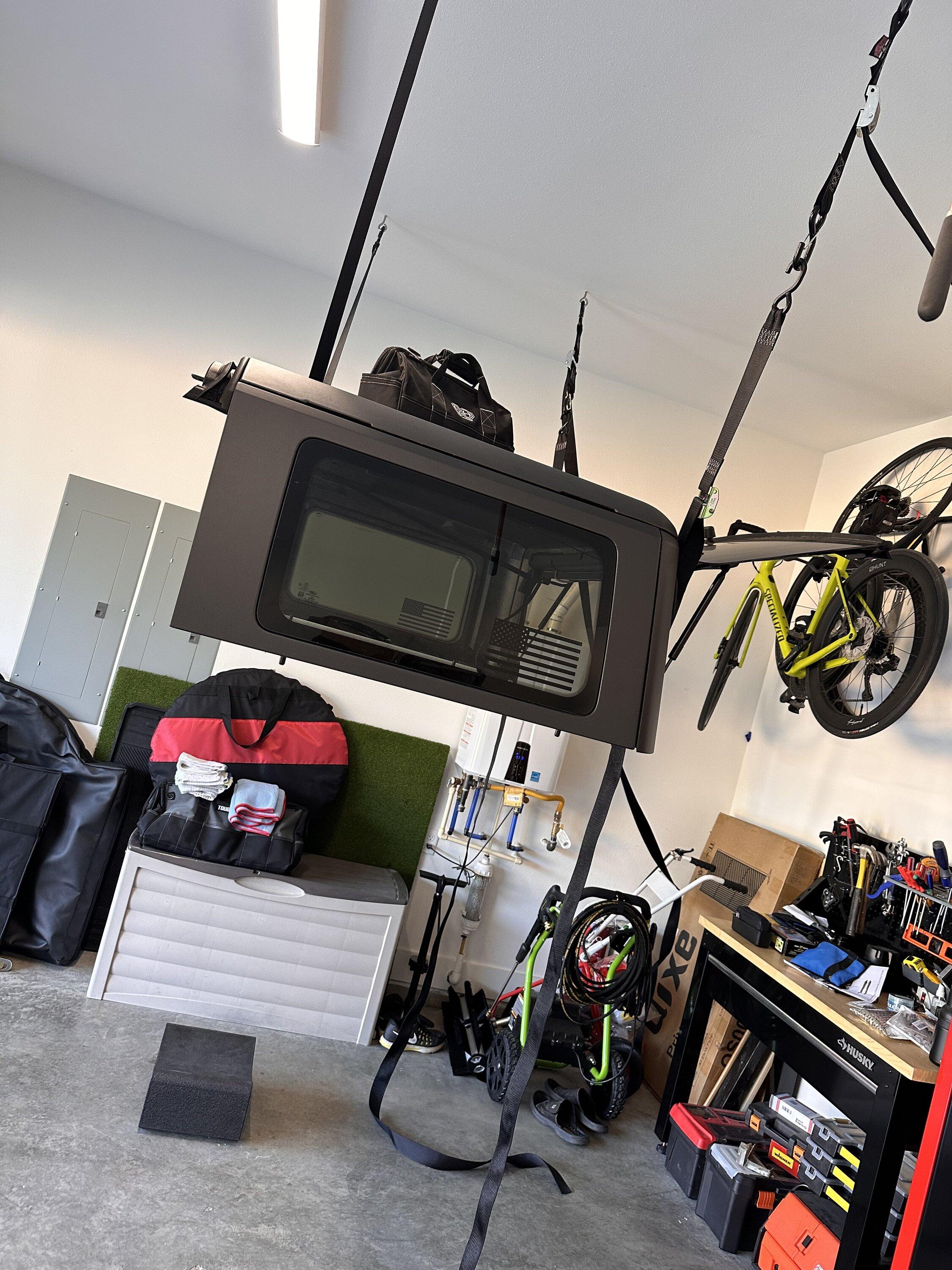

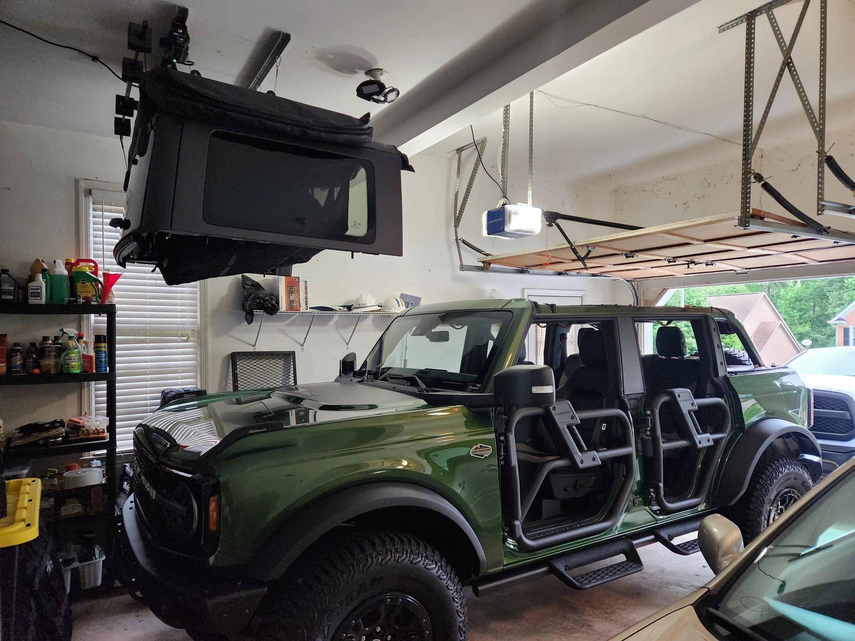

Not a cart or a jack but I went went with the Garage Smart Top Lifter. It wasn't cheap, like $800 shipped but man, to me it's worth every penny. It's so well engineered I was very impressed. Instructions are very lacking but it's awesome. Can take it off and put on by myself. I can store front two rows with it but most importantly I can park under it and still utilize my whole garage and not worry about banging anything into it. I've even stored my tube doors with it when I have my regular doors on.

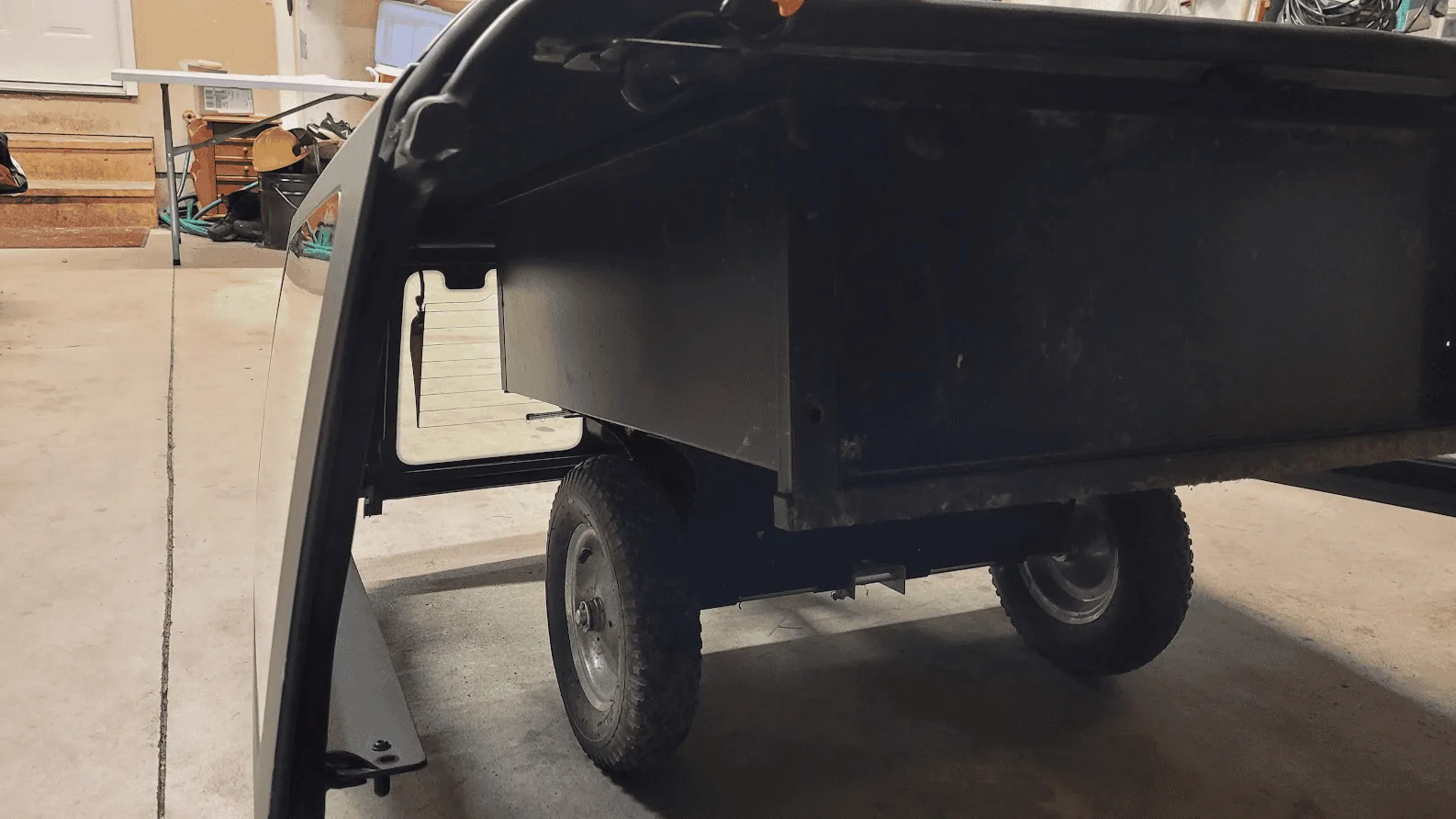

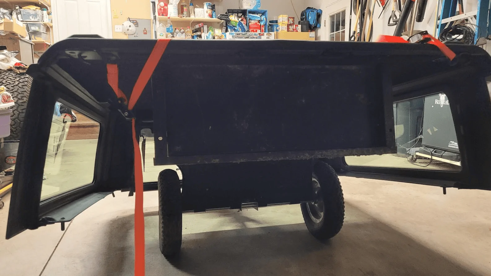

LOL, here comes the hillbilly!!!

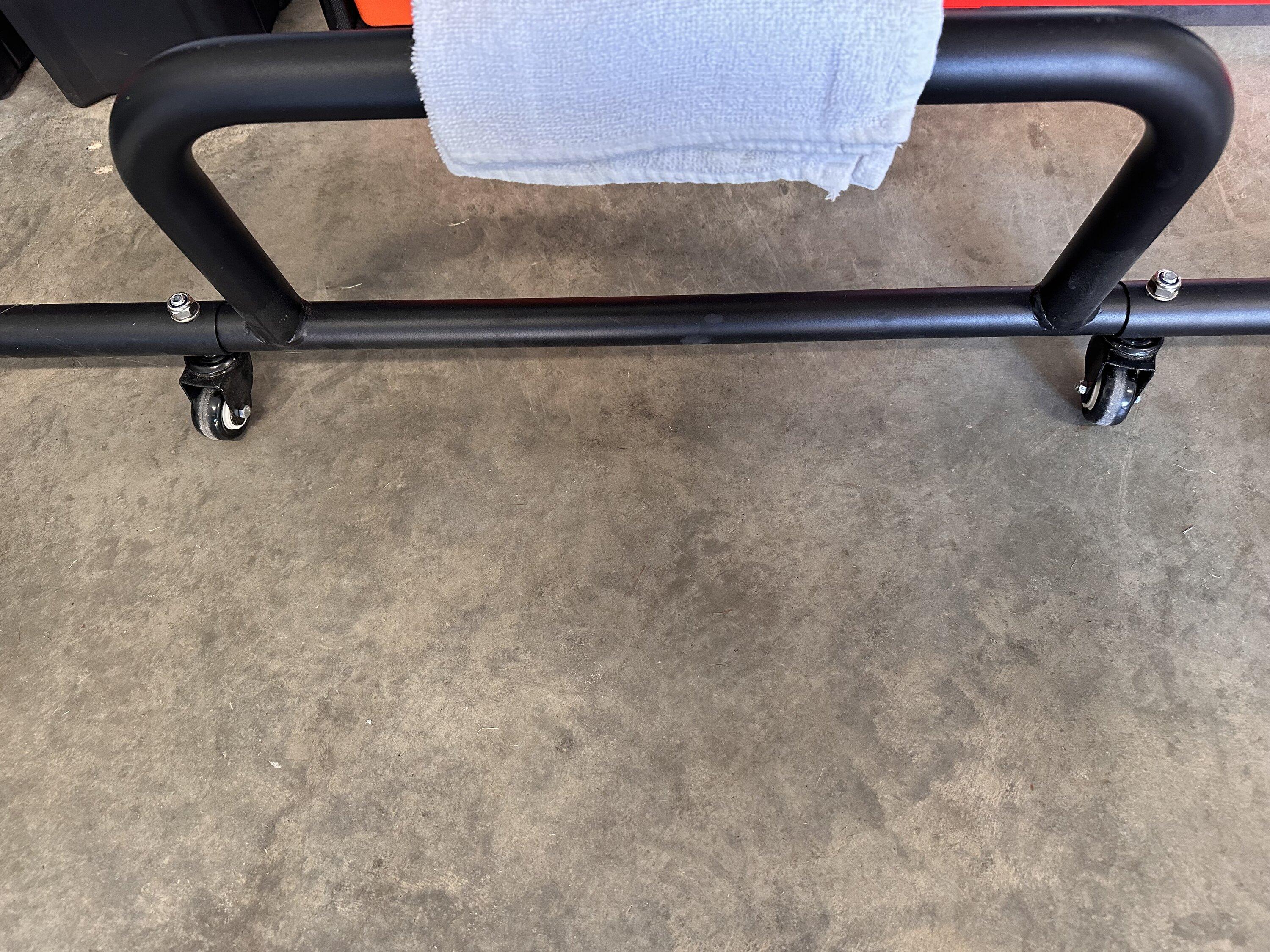

I already had this, so zero cost for me.
Pull behind yard cart for a garden tractor.
Works strictly as a top cart, but it gets it out of my garage when I want to leave the top off for days at a time and still let the Bronco sleep in the garage and keep the night critters at bay.
It has to go on with the glass towards the draw bar or it wants to "dump" itself off the back.
I might have paid $120 a few years back.

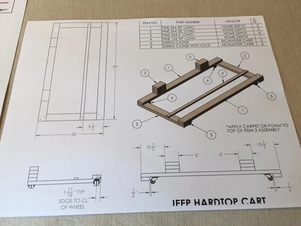

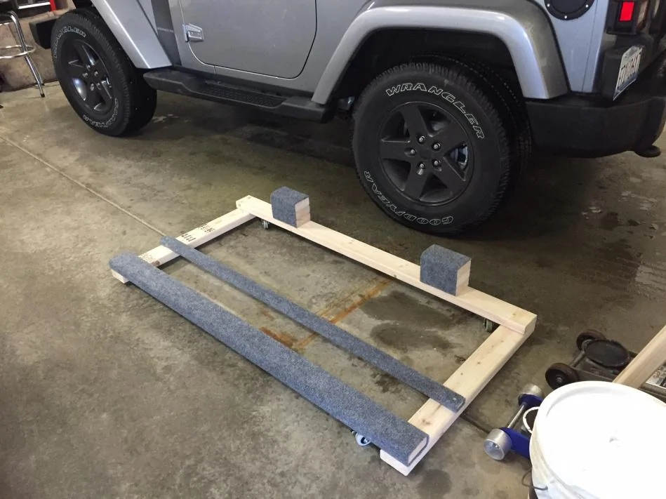

I made a cart for my JKU hardtop, which worked out great to store my top vertically during the summer. See the picture below for the dimensions. Has anyone modified this design for size changes of the Bronco's hardtop?
Those specs have been floating around bronco world for a few years now, and I do recall someone somewhere saying they had already made one for their Jeep and modified it to work for the Bronco. But I’ve never seen anyone post specs or recommended adjustments for our roofs.
This is pretty much exactly what I'm looking for. Are you storing the top with the rear glass up or down? I think I would prefer the glass up and be able to store the front panels inside. I have a 2-door.

The top is stored with the glass down with this cart. The 2 carpeted posts on one side of the cart prop the top at a slight angle. The top edge of the hardtop rests on the posts. It has worked out great for storing the hardtop from my 2016 JKU.
I am still waiting for the delivery of my Wildtrak--built on Sept 6, but will not ship until the UAW strike is over. From what I have found online, the Bronco's hardtop is about 5" shorter in height and slightly wider compared to my Jeep's hardtop. I should be able to move the 2 carpeted supports toward the back to compensate for the height difference, but I don't know if the placement and/or the height of the posts will work.
