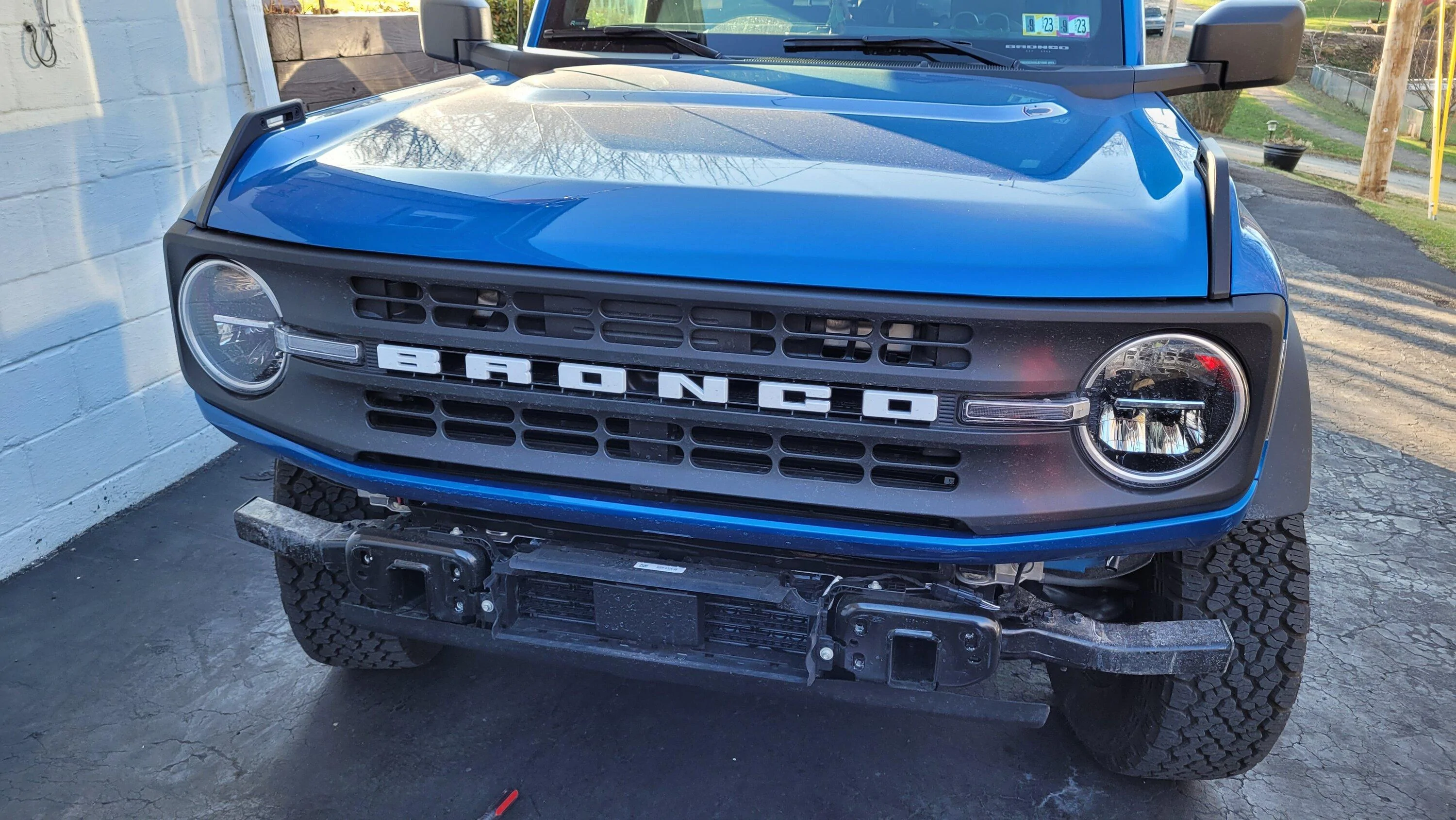

So to start off with, I had a bit of an issue with the "capable" bumper that came on my Black Diamond. When I pulled through my parking spot, I didn't see the concrete remnant of a lightpole. I'm new to trucks, forgive me.
Ford Bronco Havoc Offroad "Bender" (Angular) front bumper 20221113_113500
Ford Bronco Havoc Offroad "Bender" (Angular) front bumper 20221113_113601
Given the cost of my deductible, it just made more sense to go with something aftermarket. I didn't need anything crazy, and honestly I'm so incredibly disappointed in the stock unit. Honestly, I feel like the plastic bumper would have just ate this. So, I went with really the only decently beefy budget option I could find. A lot of aftermarket bumpers seemed to tuck very close to the bodywork, and I wanted to avoid that at all costs., Enter Havoc.

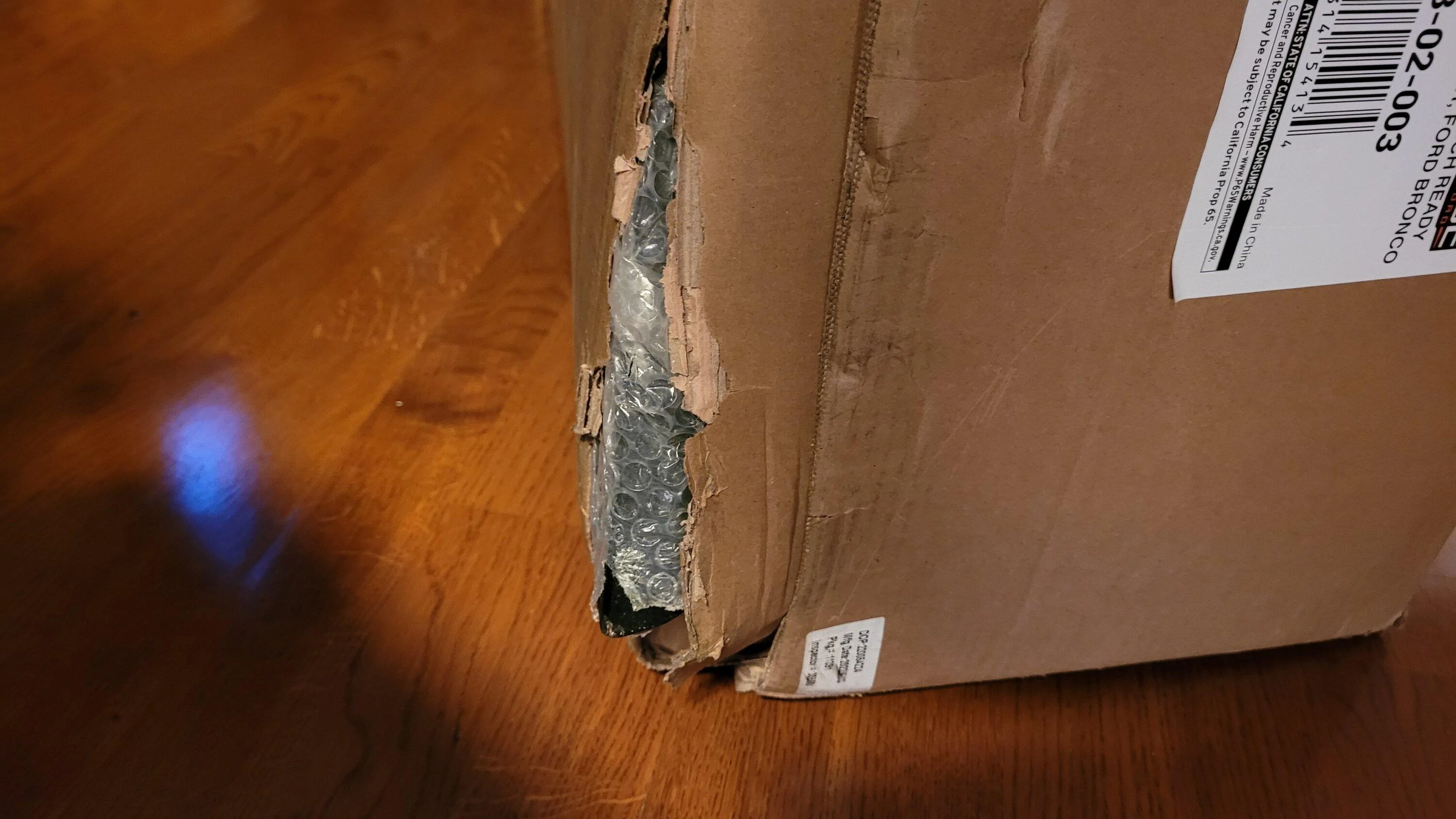

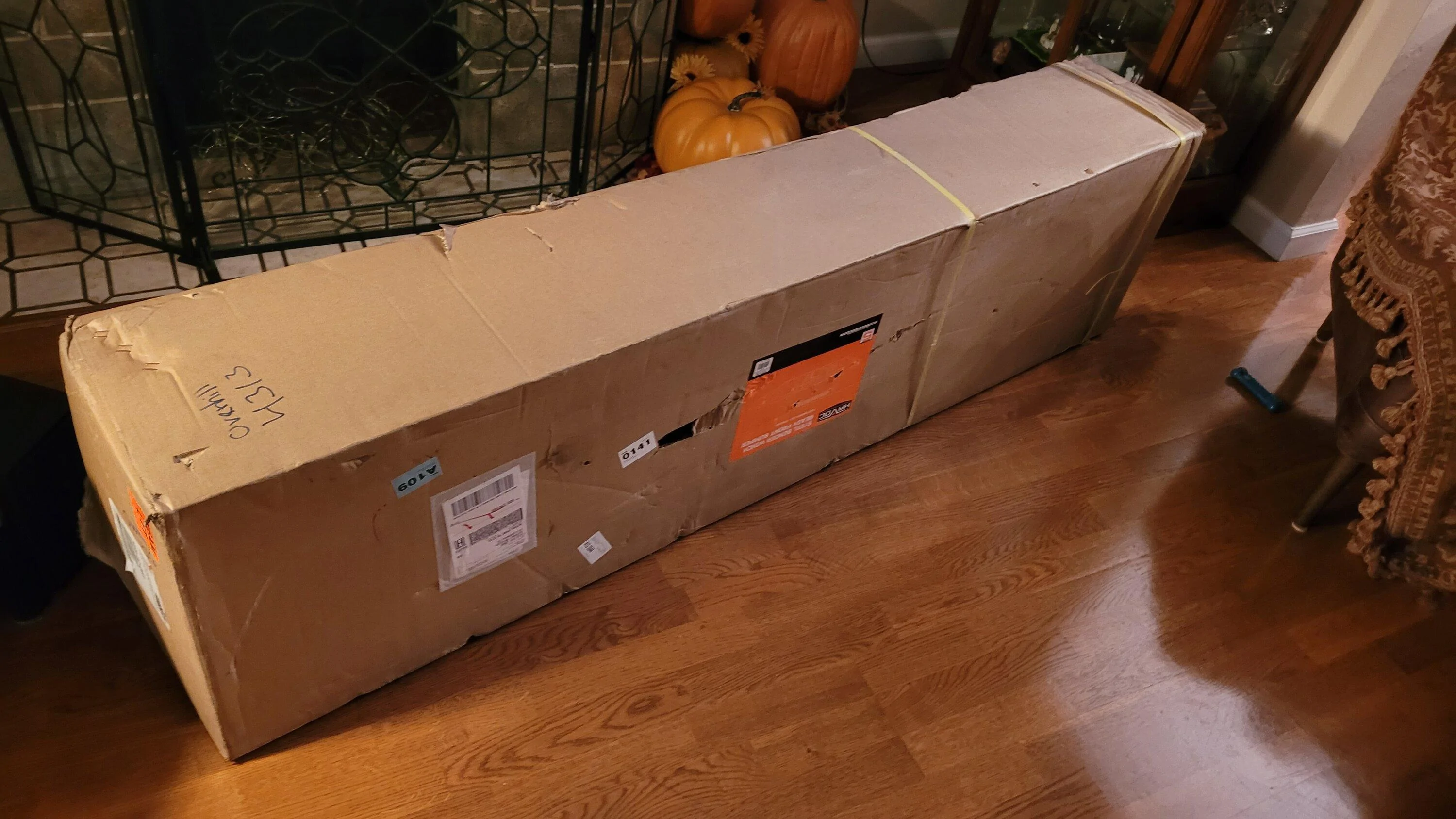

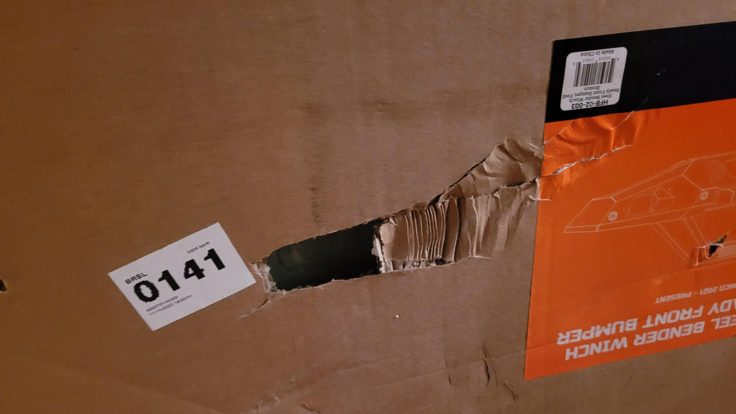

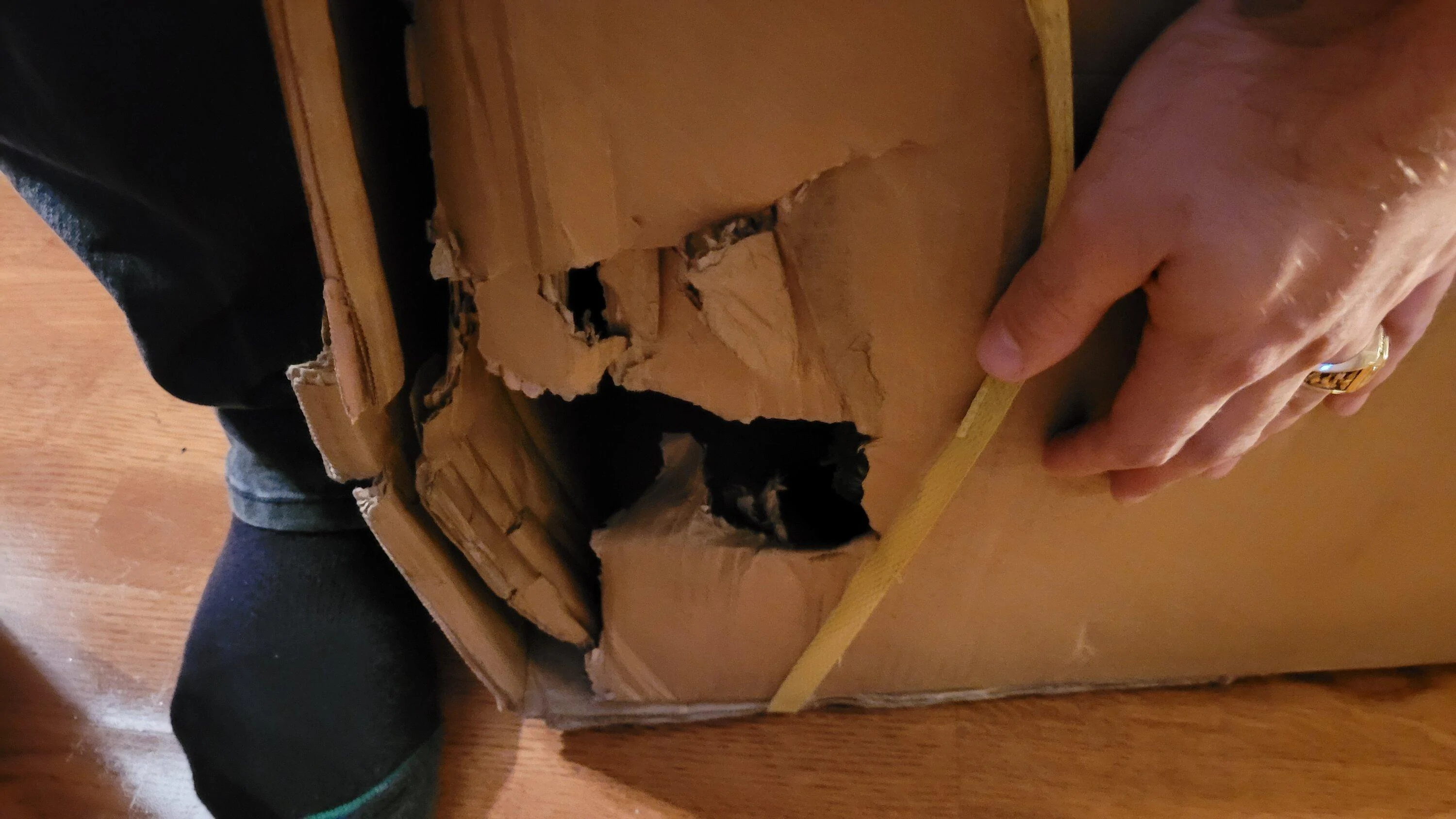

So, a couple of problems here. First is how it arrived:
Ford Bronco Havoc Offroad "Bender" (Angular) front bumper 20221117_165802
Ford Bronco Havoc Offroad "Bender" (Angular) front bumper 20221117_165817
Ford Bronco Havoc Offroad "Bender" (Angular) front bumper 20221117_165807
Ford Bronco Havoc Offroad "Bender" (Angular) front bumper 20221117_165832
Now I'm basically certain this isn't the fault of FedEx, as the bumper is supposed to have these plastic corners to prevent this from happening. They had no real attachment to the bumper and had come loose in the box. Even still, I'm not sure they were doing much.

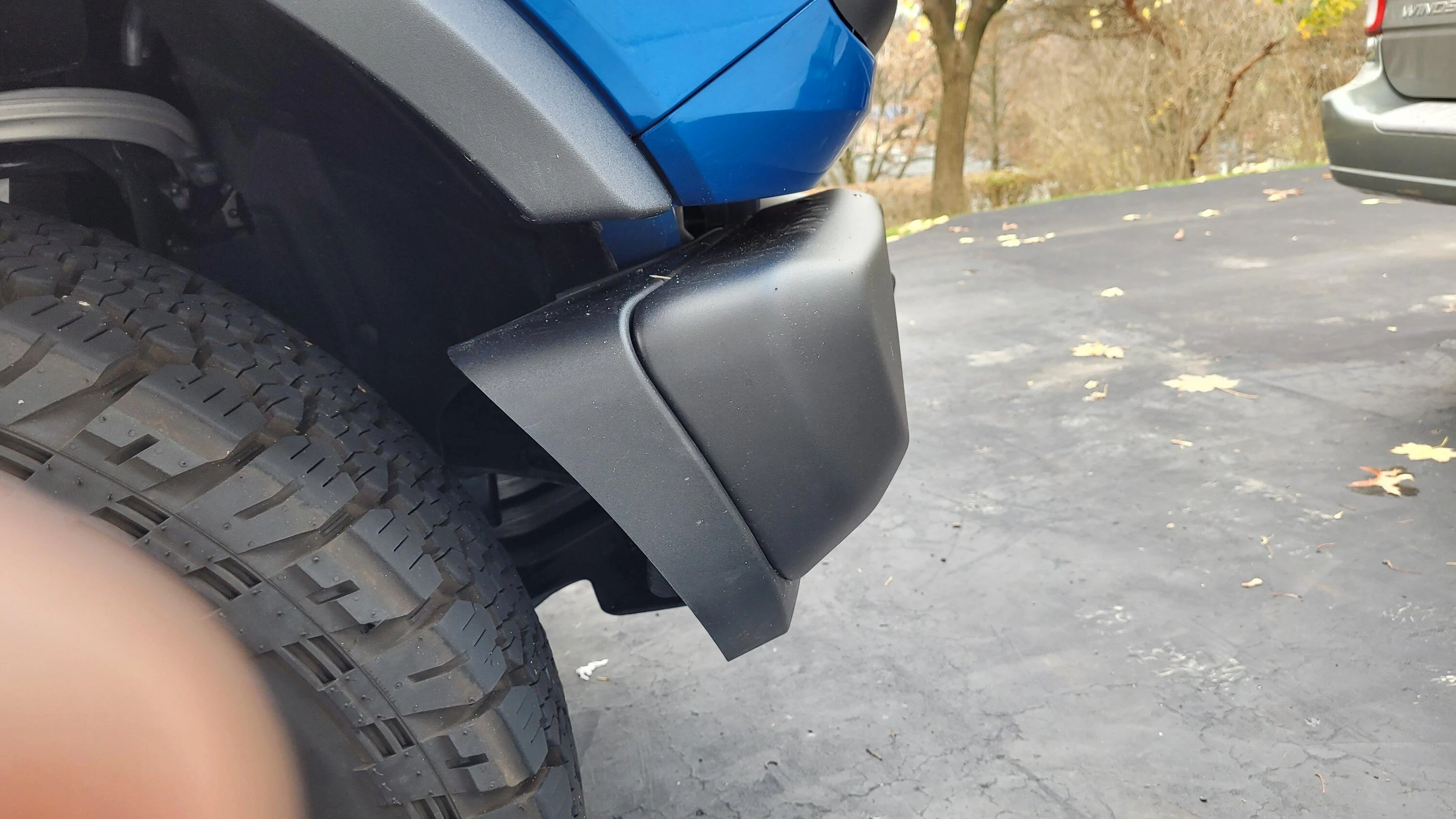

So I can confirm there are mountings for the parking sensors and cruise. Factory front skid does fit. But there are no mountings whatsoever for the factory fog lights. You could fit them, but it would involve drilling holes, which seems kinda silly just to mount these driving lights. I was more hoping to tide me over until I could afford some real fogs, but for now I just have everything disconnected. Oh, and they do include plastic plugs for the sensors if you don't have them.

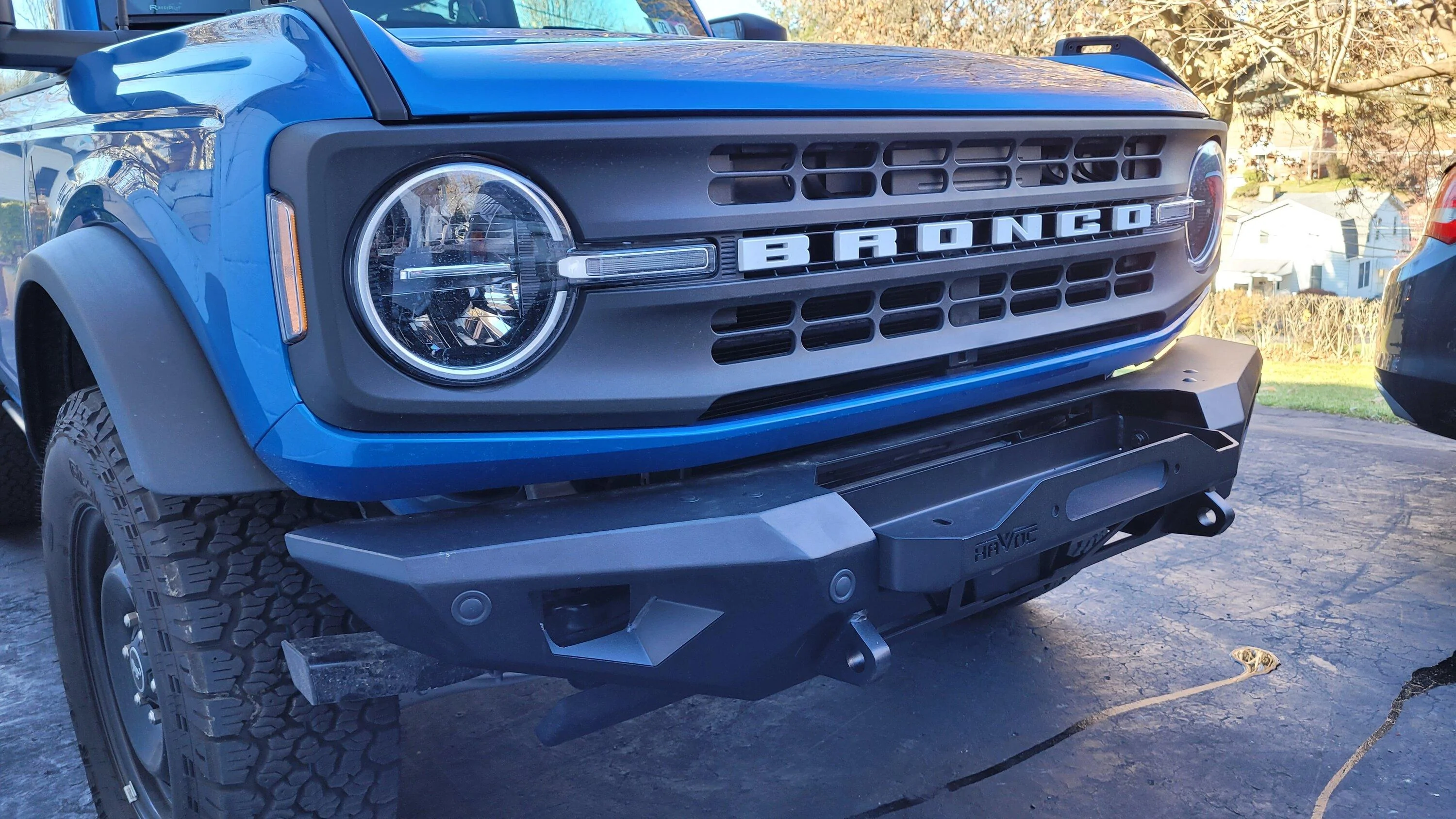

So the bumper itself. To my eyes, it's actually very well made. The welds are great considering this was one of the cheapest bumpers of this kind available.
Ford Bronco Havoc Offroad "Bender" (Angular) front bumper 20221118_090705
Ford Bronco Havoc Offroad "Bender" (Angular) front bumper 20221118_091055
It's thick steel, and the powder coat has a nice cast to it. The only thing I really don't like is that the bull bar... well....
Ford Bronco Havoc Offroad "Bender" (Angular) front bumper 20221118_090347
Yeah, you aren't pushing anything with that.

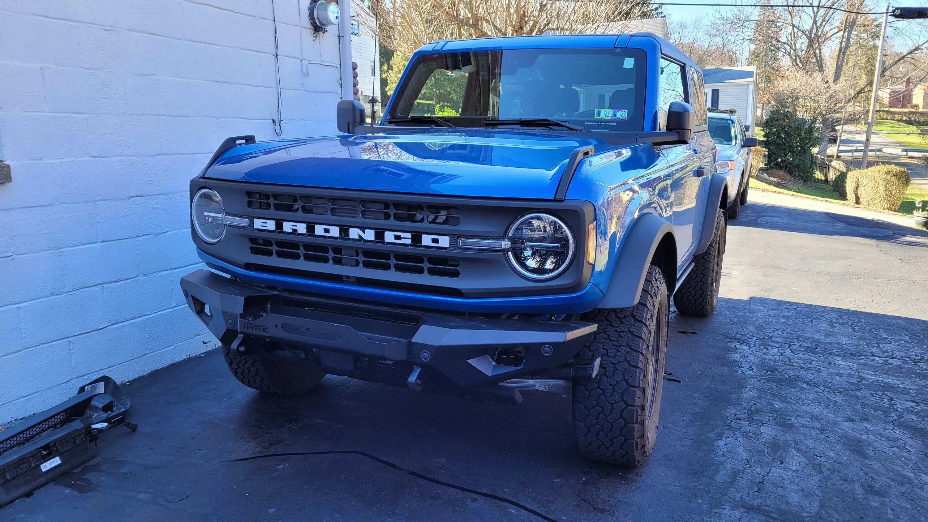

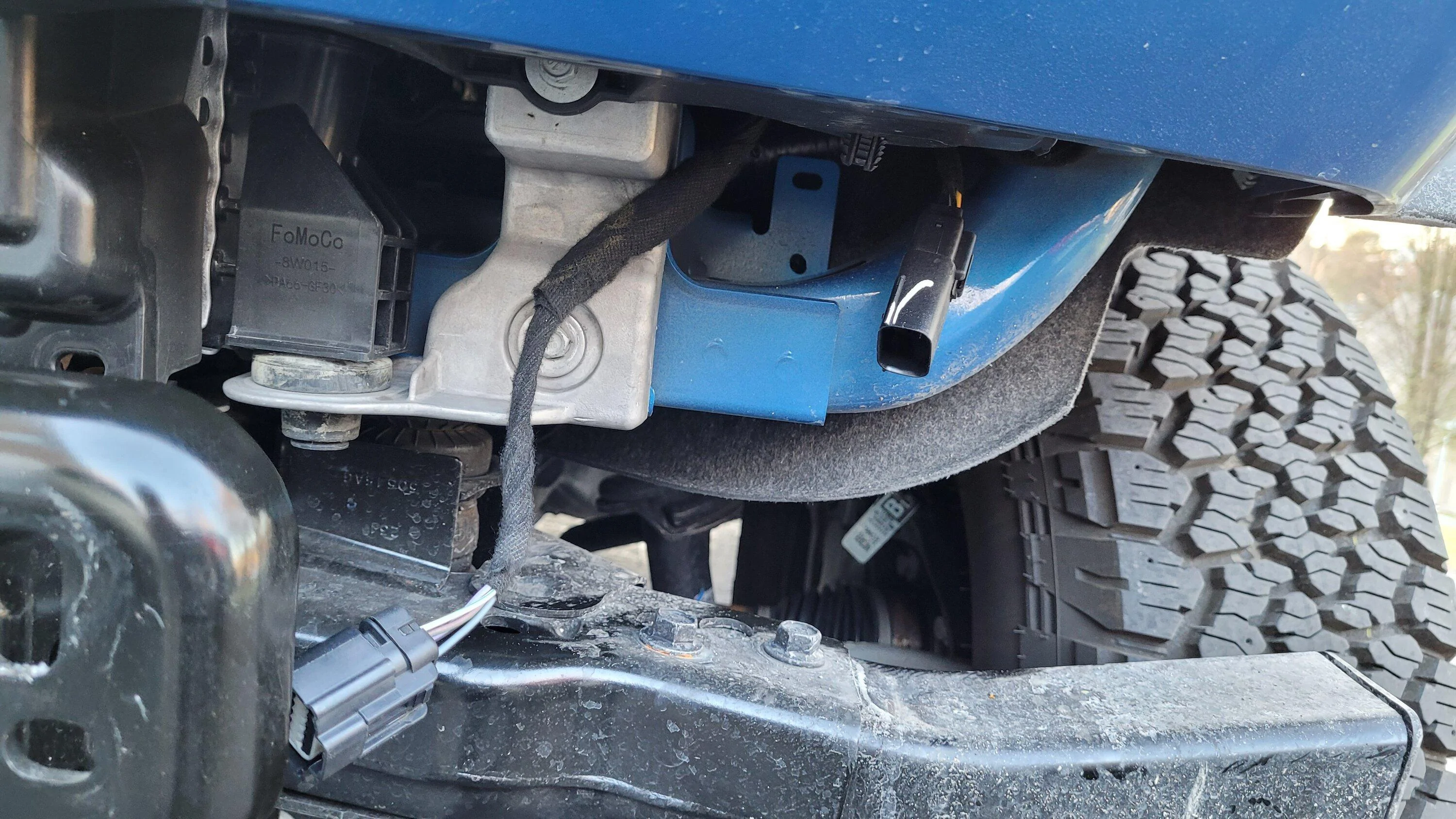

Installation is pretty straightforward, although the instructions have some glaring errors. I will say this: do NOT assemble the bumper first. Maybe the sensors and such, but not the main components. It's way easier to do after. Also, don't forget to disconnect the wiring harness on the old bumper. I couldn't find the plugs immediately and got lazy. It was a mistake.
Ford Bronco Havoc Offroad "Bender" (Angular) front bumper 20221123_155357
Here they are, drivers side.
EDIT: you do not have to remove the grill shutters for the intercooler. However, you do need to remove the external ducting/shroud (basic pull tabs) and possibly the plastic aesthetic piece on the outside to fit under the bumper.
Ford Bronco Havoc Offroad "Bender" (Angular) front bumper 20221123_150523
As you can see, the bumper attaches straight to the frame. There aren't any kind of shock absorbers or nothing. Something something federal 10mph laws. At least you can feel confident you aren't ruining crash safety with this thing. So, on to the good stuff!

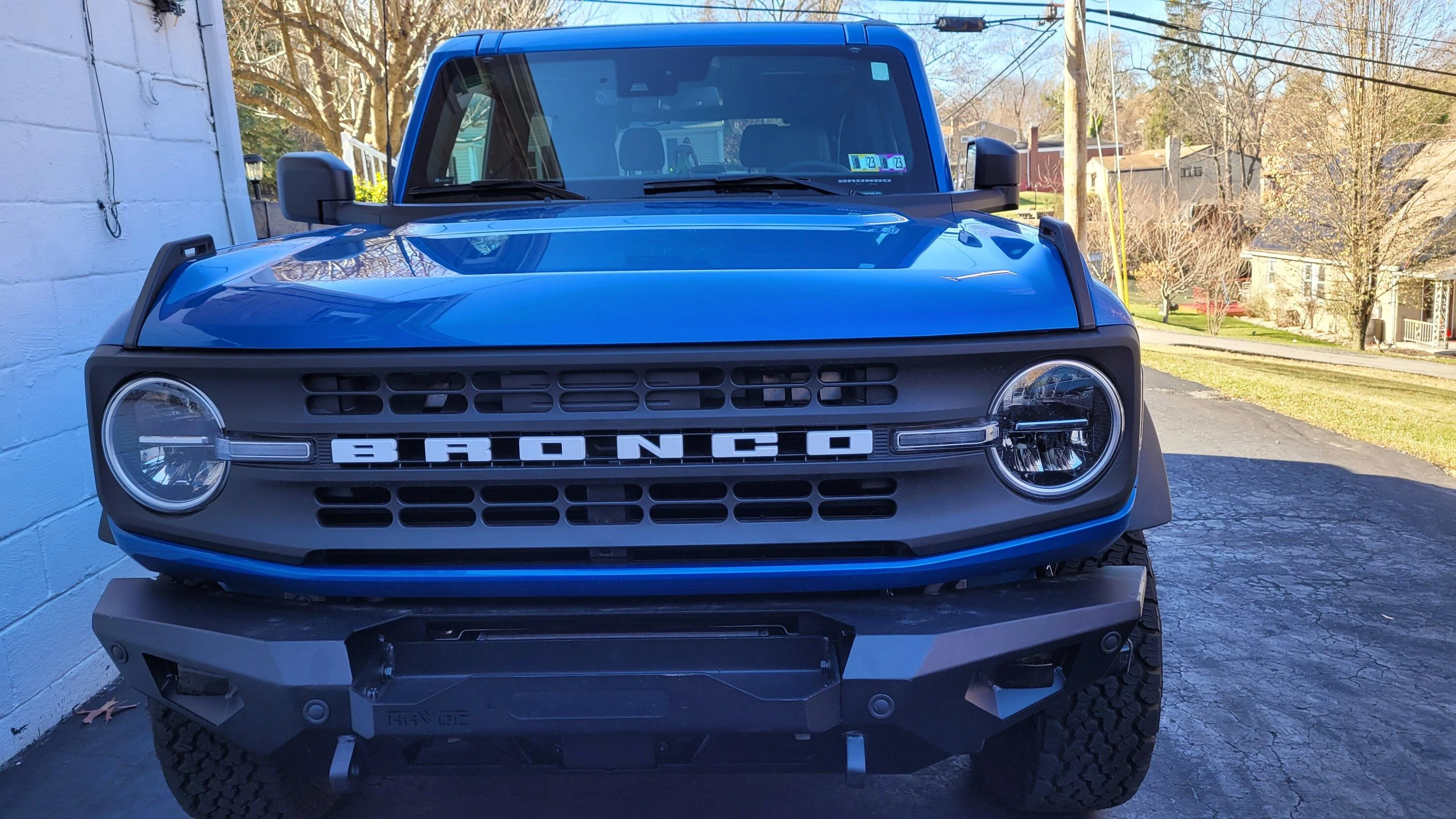

No light bar
Ford Bronco Havoc Offroad "Bender" (Angular) front bumper 20221126_130909
Ford Bronco Havoc Offroad "Bender" (Angular) front bumper 20221126_130920
Ford Bronco Havoc Offroad "Bender" (Angular) front bumper 20221126_130936

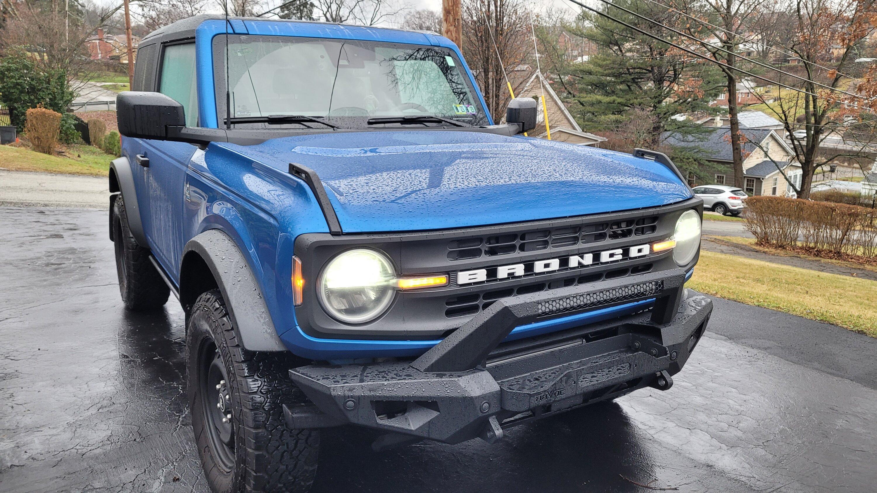

Light bar.
Note: the crash bars are very visible now. Doesn't bother me, but it may bother you. I got plugs for them, so it looks fine IMO.
Overall, I'm happy with it. For a budget option, it's definitely a budget option. At least it's constructed well, so the really important stuff is all there.

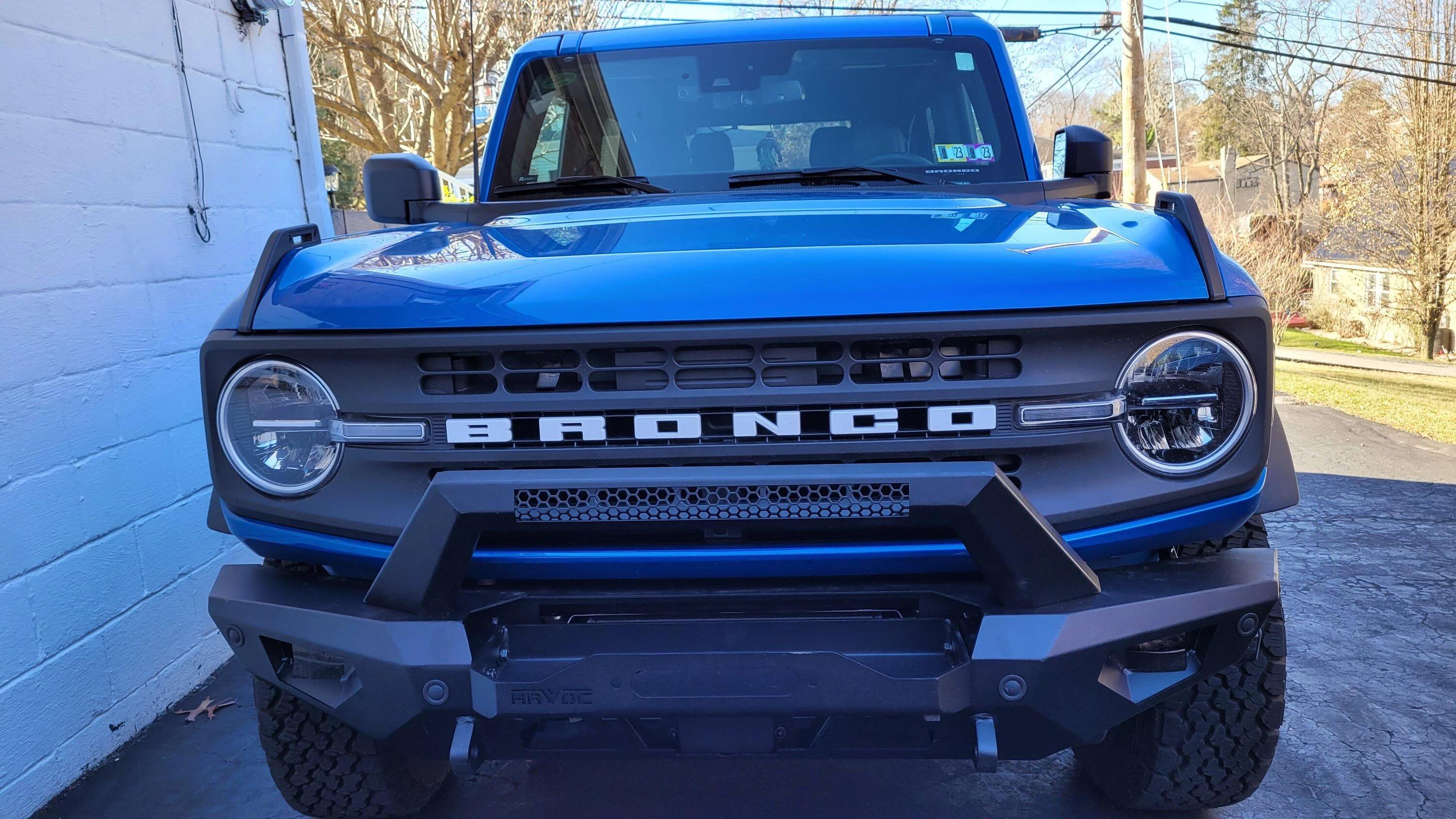

Could you please take a side profile pic? How flimsy is that “bull bar”? Seems like it would bend pretty easy. I’ve also been trying to get Havoc to provide a camera view pic as they say it doesn’t interfere with the view, but I don’t see how it wouldn’t…
Ford Bronco Havoc Offroad "Bender" (Angular) front bumper 20221126_134146
I'll have to take a better one tomorrow. The center section of the bull bar is very flimsy, the "arms" less so. I doubt it could withstand any type of impact. Very odd considering how tough the rest of the bumper is.

Thanks for the pic. That’s disappointing, plus it looks like it nearly protrudes past the bumper…
I still may consider if I can get clarity on the camera situation…. Strongly considering the BAMF winch bumper also.

The bar definitely blocks visibility but you can see below and above the bar - if something is closer to the ground then you'll be fine. I'll get a picture for you.

Here are some better pictures:
Ford Bronco Havoc Offroad "Bender" (Angular) front bumper 20221206_145706
Ford Bronco Havoc Offroad "Bender" (Angular) front bumper 20221206_145659
Ford Bronco Havoc Offroad "Bender" (Angular) front bumper 20221206_145721
