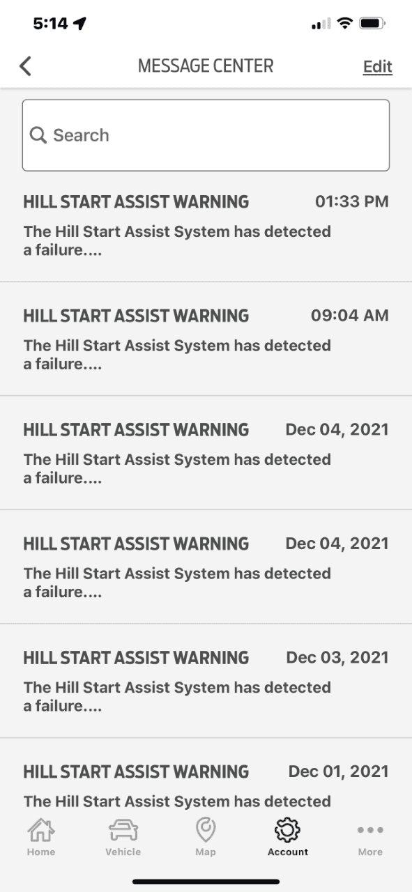

Having the same problem. Only 130 miles. Also, auto start stop is no longer working and the parking brake is turning itself on, I have to disengage it every time I start it despite not engaging it myself. Also getting forward collision errors. Only the Hill Start Assist is showing up in my message center though.
Left a message at my dealers service dept. but haven't heard back yet.
4dr Sasquatch 2.7
