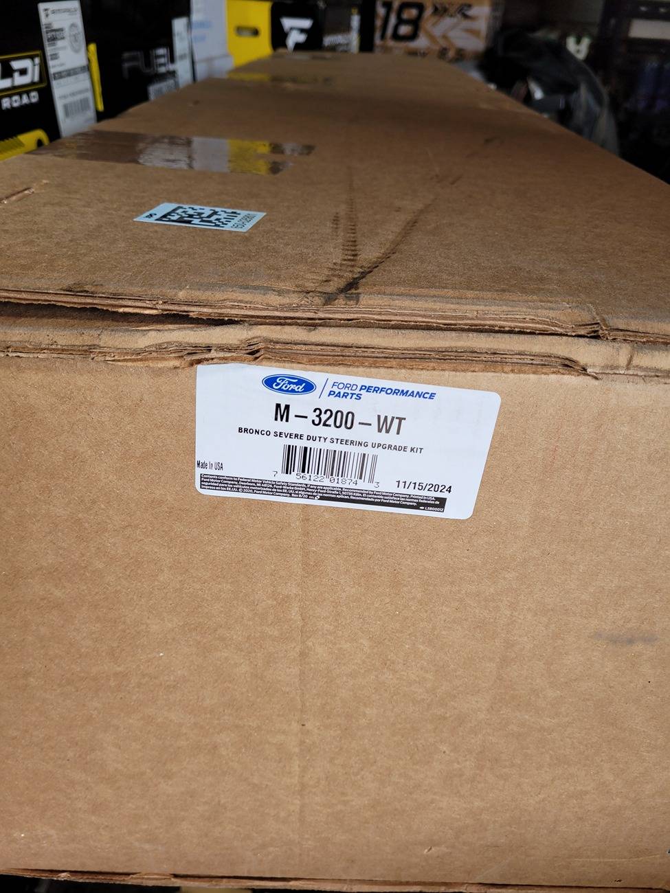

I am sure your aware that according to Ford Performance there are different flash/programming versions depending on the model. Using the FP M-3200-WT kit with the ProCal is not even an option for those of us with non-SAS 4-Doors and probably won't be for another year (Last response was late Q3 before they even start on it so that means sometime in 26 at the earliest.)
Every post I have seen using your hack has used a Wildtrak VIN which would be the incorrect programming for non-SAS 4-Doors. I know people have done it and it worked BUT nobody knows exactly how that is working except that they have no codes. According to FP the incorrect flash "will cause issues with ESC / ABS / Lane keep calibrations as they are for a different C-Factor/Steering ratio than what this rack is."
Do you know of anyone who has done your hack using a VIN for a 24 non-SAS Badlands 4-Door which is now coming from the factory with the 3.0 rack?
The assumption is that a 24 non-SAS Badlands 4DR with the 3.0 would have the proper flash programming for the excluded non-SAS 4-doors.
