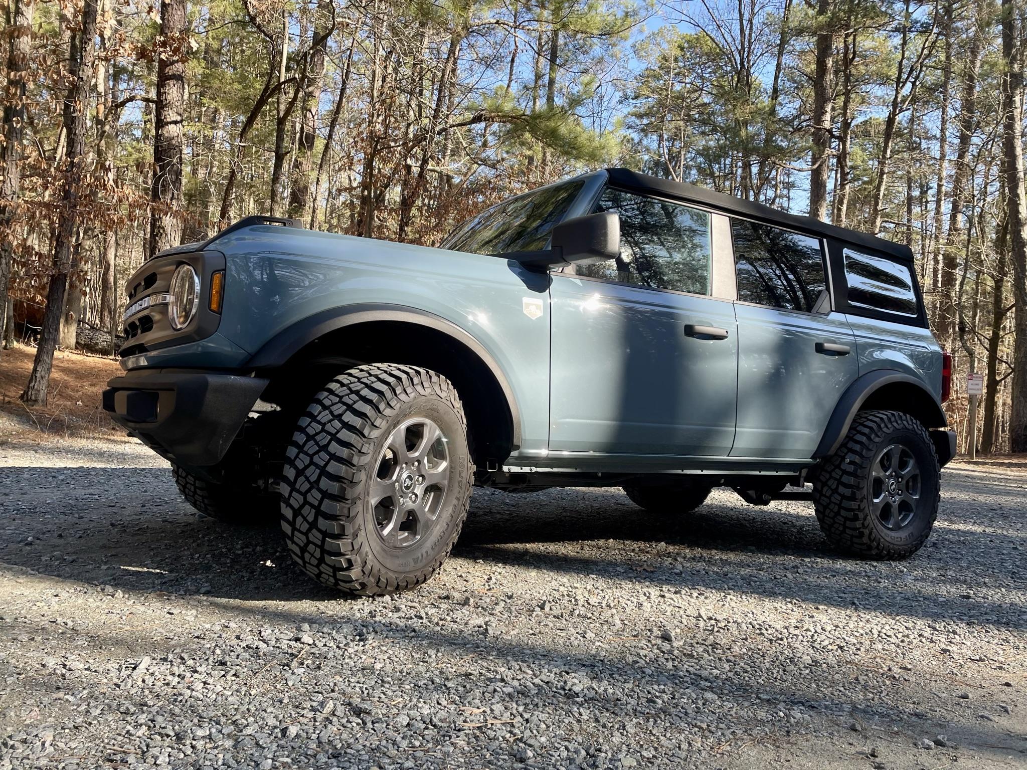

I ran 285/70/17s on my stock big bend rims for a minute. Zero rub, crash bars in place.
Then I went to 35s :)

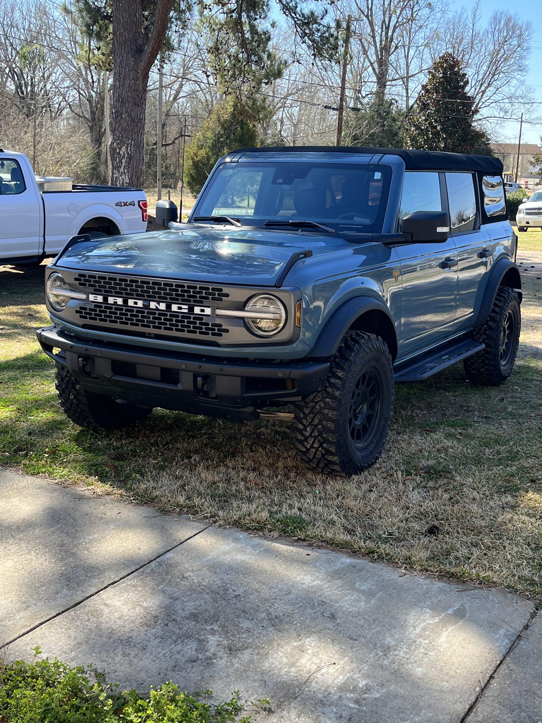

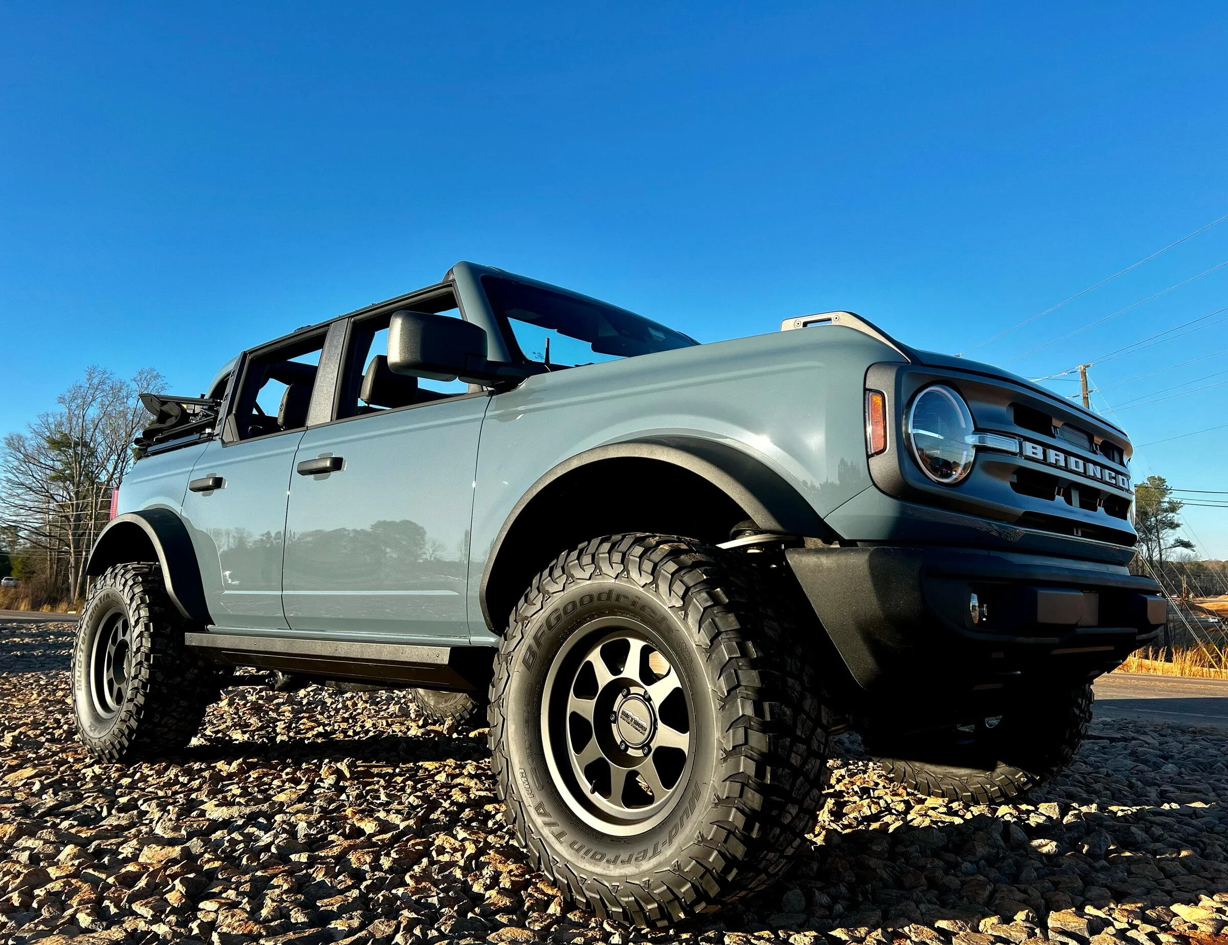

[/QUOTE Here are pictures on my non sas Badlands with 295/70r17 on Method 703 + 35mm offsetā€¦Poke is minimalā€¦
Ford Bronco How big can I go with a Base Model? A5D1064C-9793-4292-91F6-6855FF544C7A
Ford Bronco How big can I go with a Base Model? 32A1012B-609D-4089-A3F9-C4CD509D1E58
