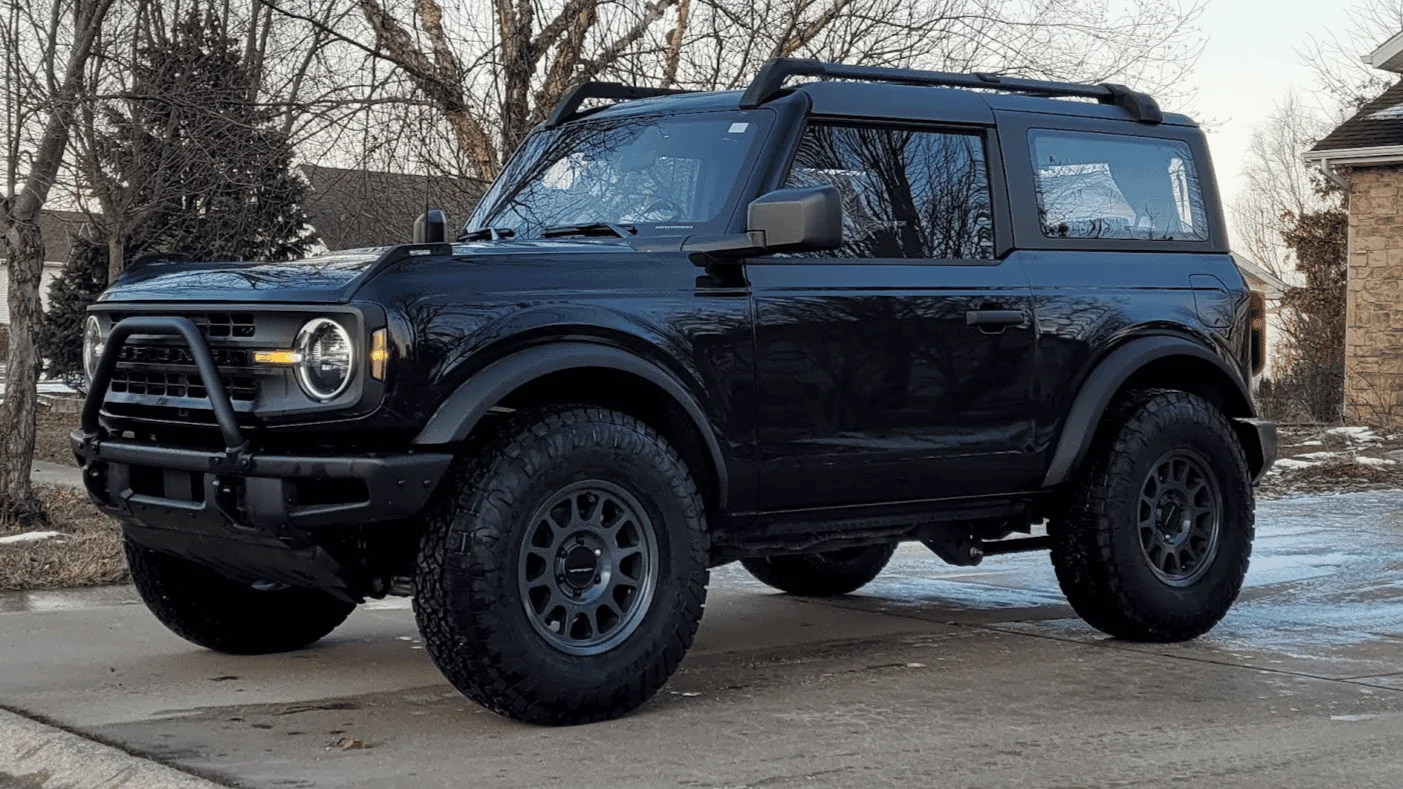

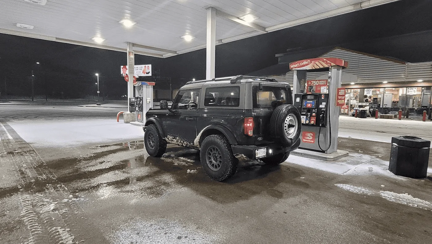

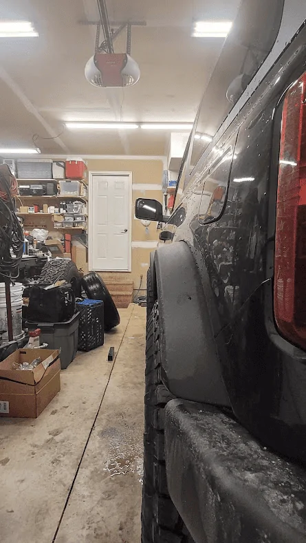

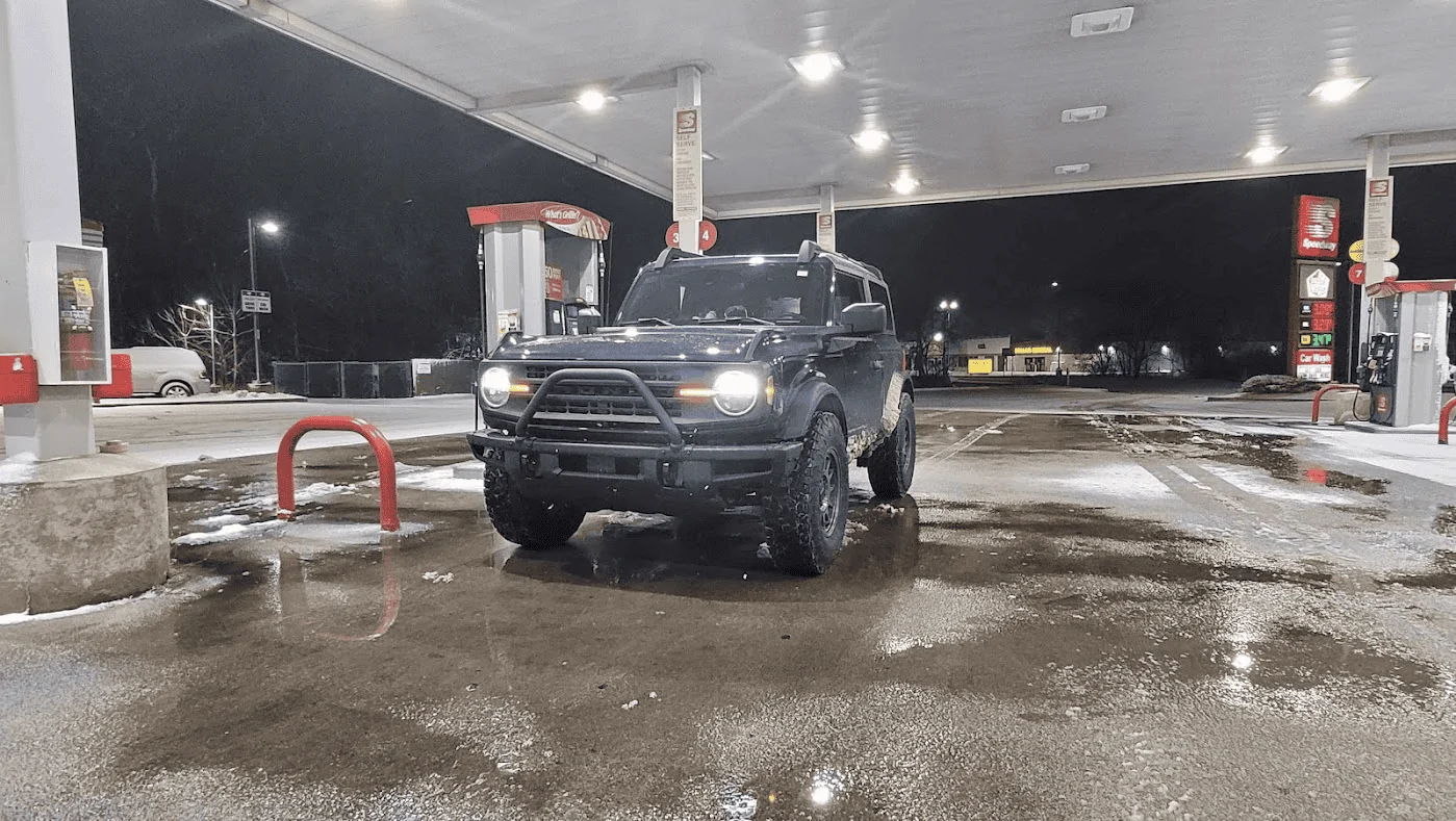

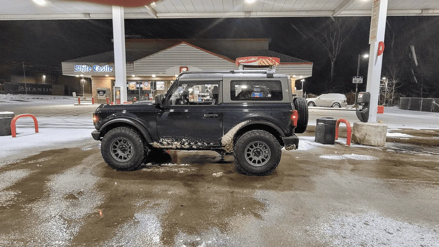

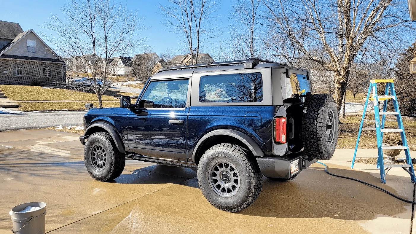

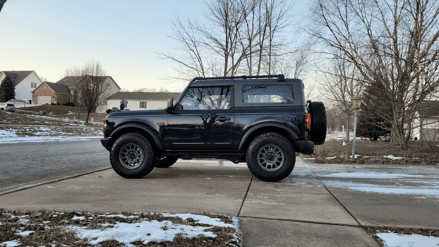

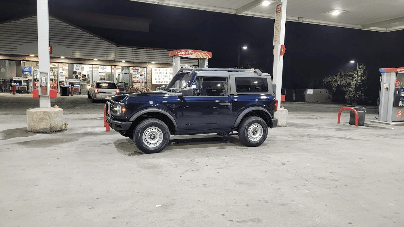

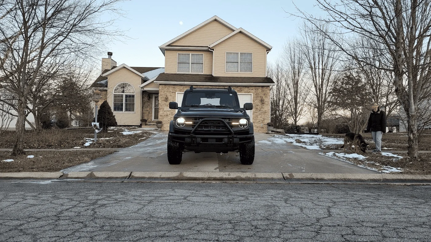

Just some quick pics of the new set up, installed during a snowfall , lol.
NO LIFT ... crash bars have been removed
Method 703 "Bead Grips" in Gloss Titanium
17 x 8.5 +35mm
Toyo Open Country A/T 3
35 x 11.5 - 17 ... load range C
Wheel 28.7 lbs
Tire ... 63 lbs
let say .. 92lbs total
No rub at static height or full droop, not even close.... haven't flexed it upwards yet (stuffed).
Just the 2.25" of added height really change the look of this thing. She's one burly bitch now! LOL
I thought I wanted the 33.9" 285/75 , but these became available first, load range C ... so I jumped. I'm glad I did!
Drive-ability ... These 35's have pushed the manual from being very over geared to just slightly under geared, very slightly. I actually prefer the way it drives now. 1st is much more useable and the 1-2 shift is A LOT smoother. It's like 1st was too low and second was too close of a gear but not quite enough to launch from , so it made the 1-2 shift pretty jerky. I'm not the only one who has mentioned the same feeling about the manuals 1-2 shift.
If I had to guess, I'd say a 33" 285/70-17 would have nailed it.
Now to the pics , if you haven't already scrolled past all this drivel.

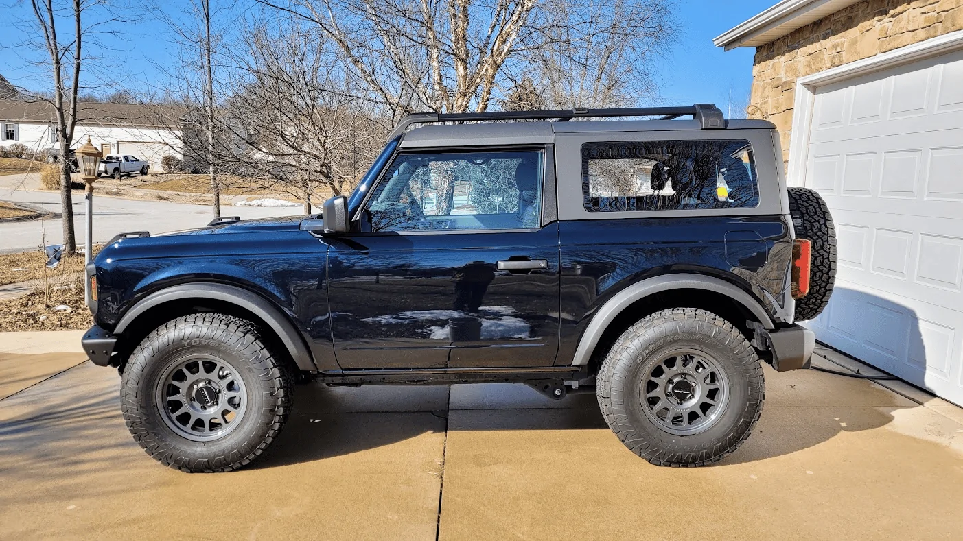

Update, added pics

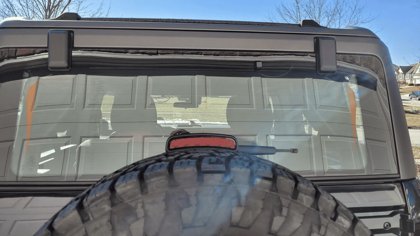

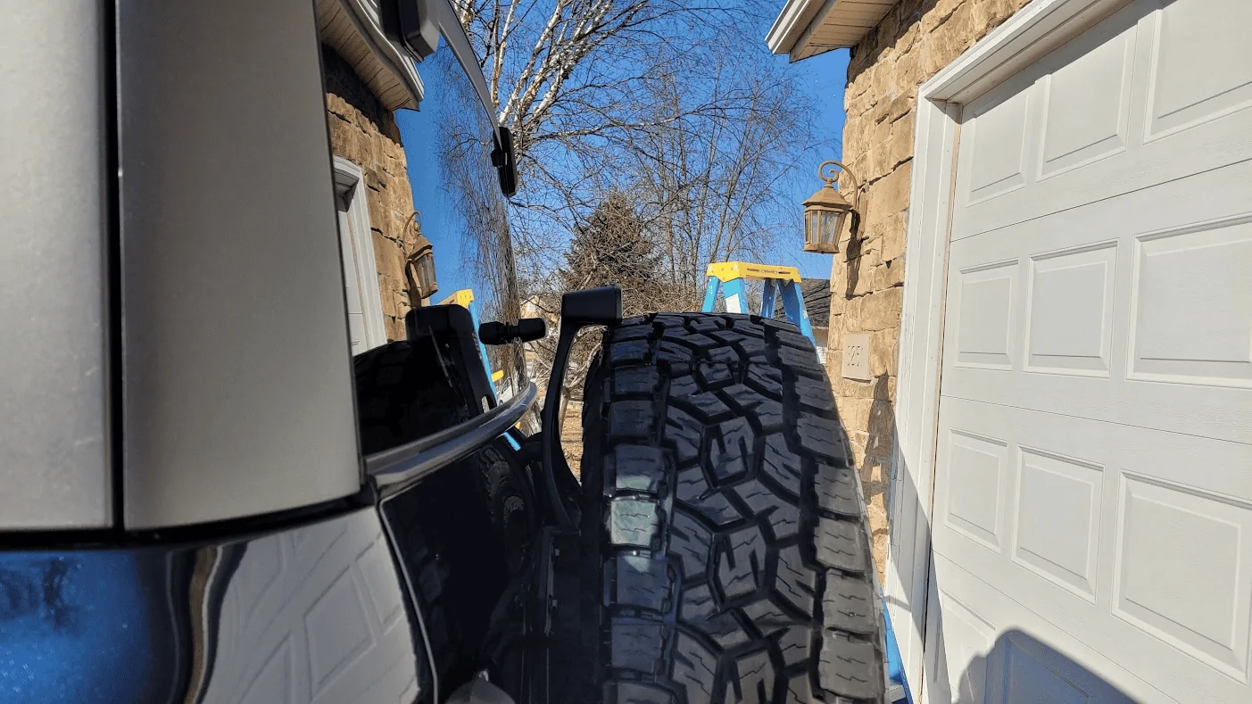

fyi ... spare sits nice and snug on the support bumpers. JUST kisses the thrid brake light.
Before:

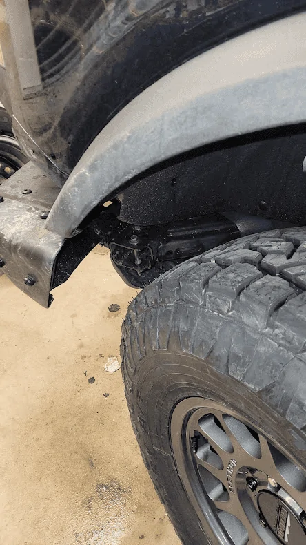

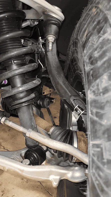

Look at the back of the tire, you can just see the sway bar. Full droop, left steering lock
Ford Bronco Base Bronco on 35's NO LIFT!  Method 703's & Toyo 35 x 11.5 -17's 1641108940703
crash bar (stub) at droop, right lock:

Nice look. That reinforces what I was thinking...35mm offset works well with the smaller flares. You did well.

Looks fantastic. I’ve been having a hard time envisioning which color wheel would look good on Iconic Silver - trying to get away from black rims. This looks perfect in AMB. Nice choice.

liking the look a lot with the tires tucked into the flares and not really sticking out!

How close to the UCA is the tire at full lock?
HoosierDaddy
HoosierDaddy
Mar 6, 2016
5,436
13,873
Indiana
68&69 Broncos, 21 AMB Base 2dr, 23 VB BL 4dr
The knuckle pivots at the UCA, so it shouldn't really change as they are turned or if the suspension moves from droop to stuff.
There is a pic above at left turn lock full droop.
As it is, this wheel at +35 and the 11. 5" section width, the inside of the tire rides EXACTLY where the stock steelie/255 combo rode. .... .04" difference according to tiresize.com.
Therefore, the spare bolted right up, just nudging the 3rd brake light.
