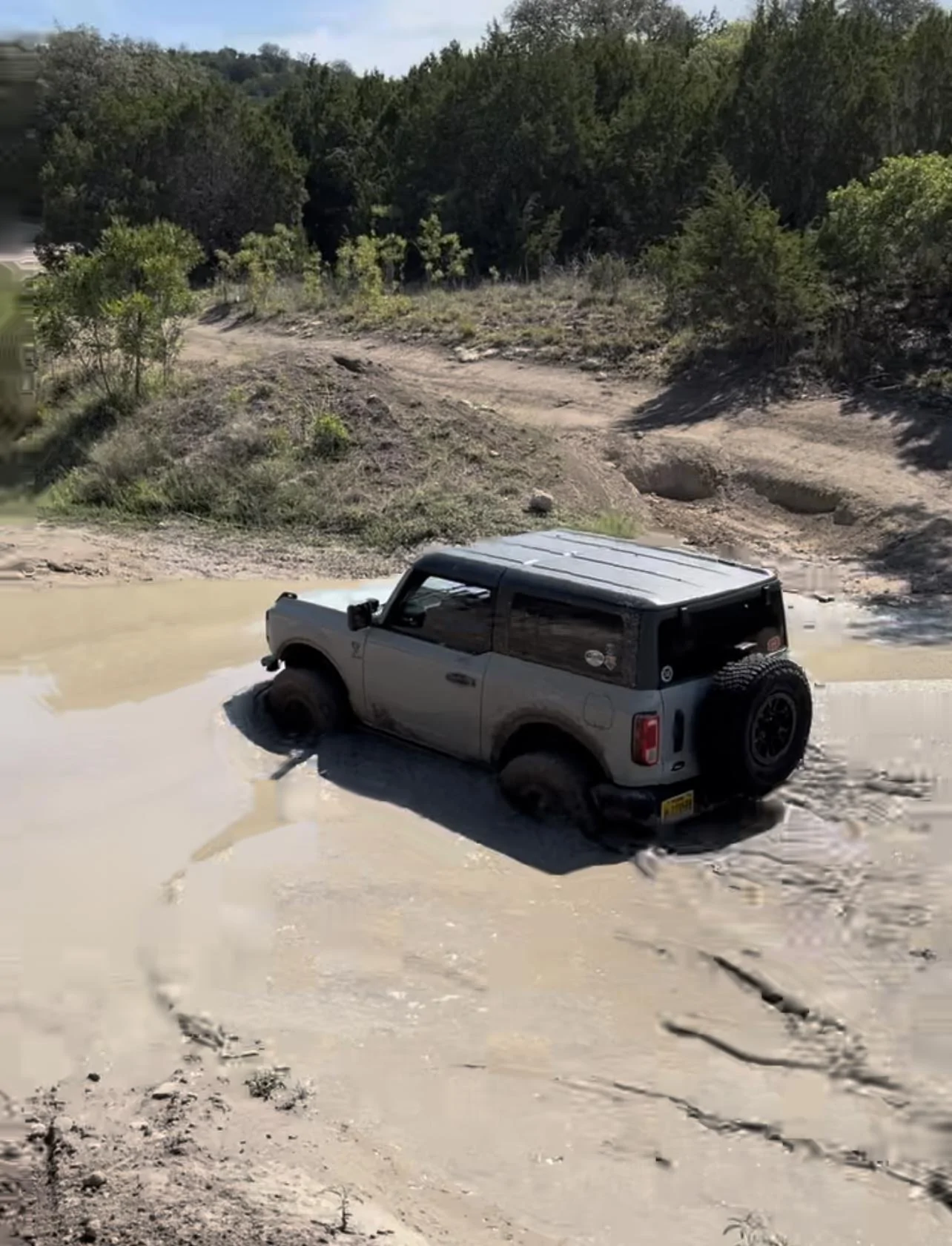

Yeah that’s a good idea. That’s what my friend is the instructor for so I trusted his advice initially. I’ll see if the team can get me through one it does sound like a lot of fun.
I haven’t read every reply in thread, so forgive me if a repeat question. Where were you air pressure wise? Lower psi gives you a wider footprint and sidewall flex

The course specs 35 psi but that’s for the Raptor KO2 so that could have been part of it.

Next time you go mudding try about 15 psi. 35 is road pressure, so air down after you get off the highway but before you get offroad

As I’ve said this wasn’t even mudding just a Ford Performance Off-Road Evaluation Course but yes I will keep that in mind when I do decide to do some mud work

It’s a Badlands I added that sticker. Front and rear were engaged yes.
The Raptor R on KO2’s pulled me out like it was nothing so I’ll be switching to those

Seems to me that the guy who suggested that traction control was stopping you is on the money.

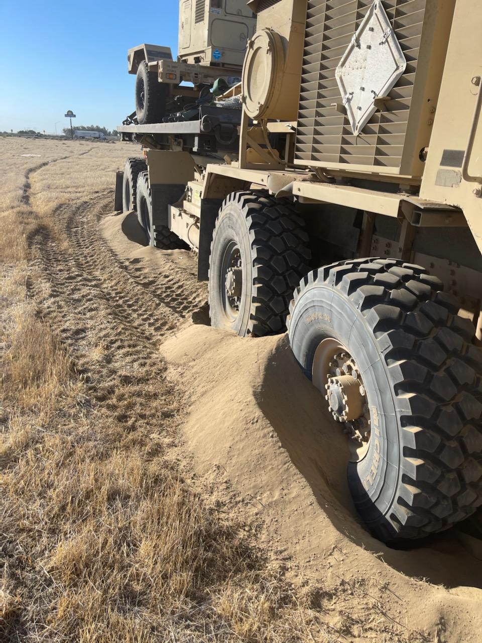

Well.... At least you weren't this kid. Fresh out of AIT, claimed he could drive the wheels off anything. Forgot the trailer brake, threw it in 8x8 after not moving, and proceeded to bury it to the axels. It was an interesting recovery...
Those are 48" tires for reference
