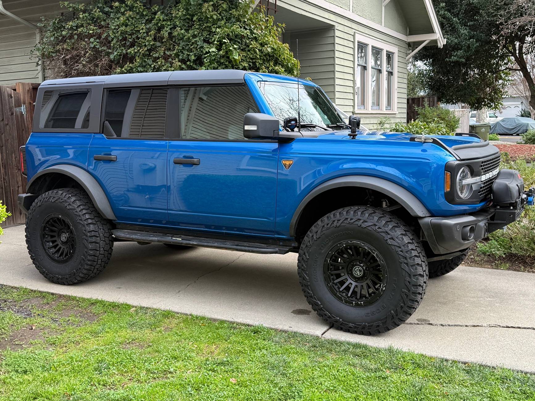

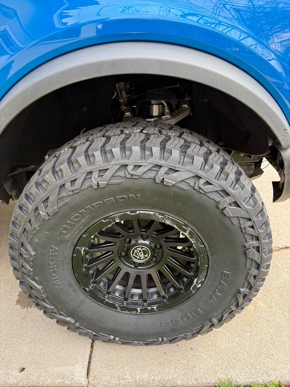

I have a 2023 Ford Bronco Badland Sasquatch.

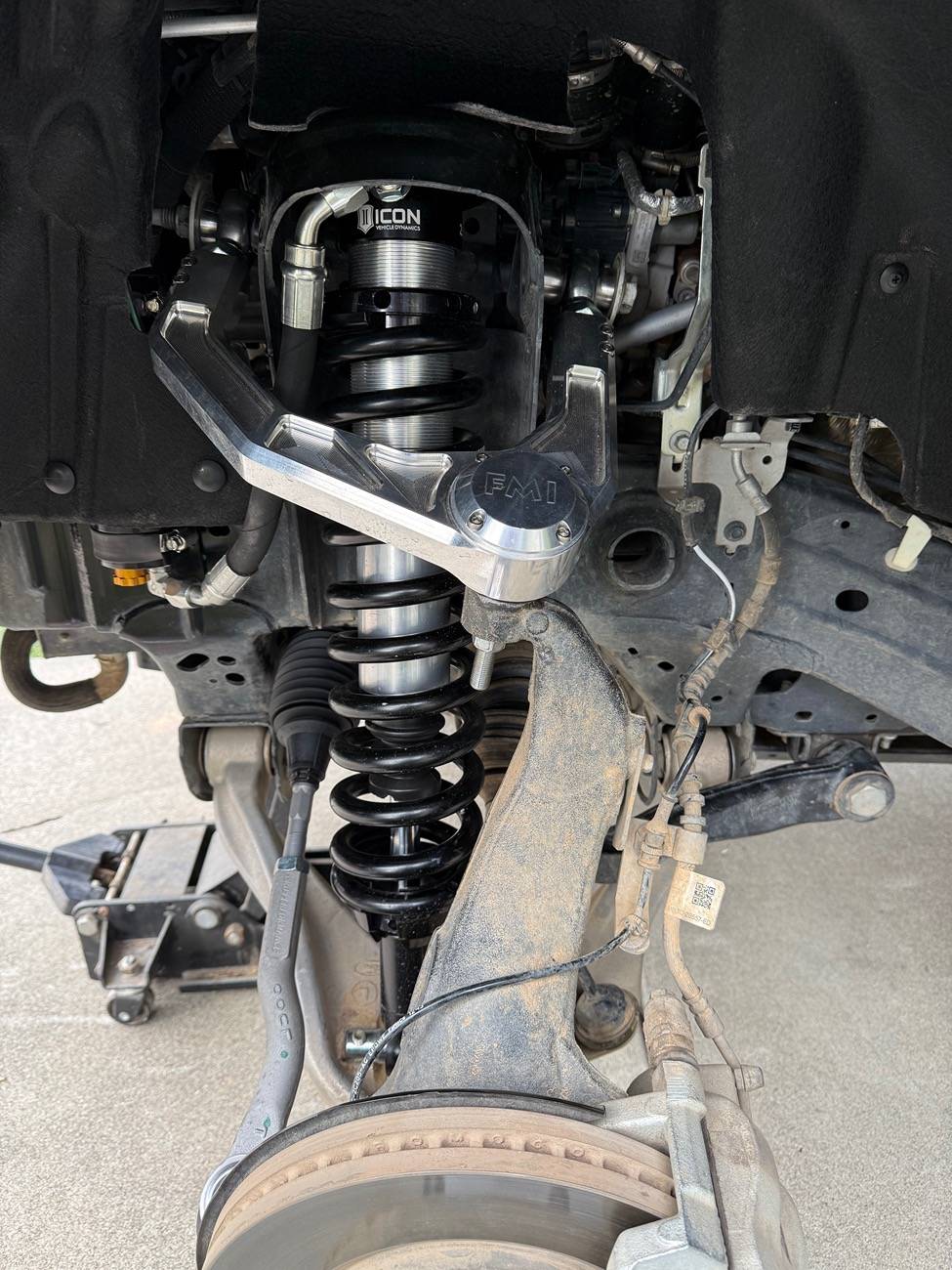

Installed:
37” Mickey Thompson Baja Boss AT
Icon fully adjustable 2.5 shocks
FMI uppers
Core 4x4 track bar
Heavy-duty steering rack and tie rods
Current measurement:
(ground to edge of fender)
Front 42”
Rear 43”
Obviously, 1 inch is due to the tires. There are a lot of posts about axle angles, shock, comparisons, and so forth. It all includes saying that extreme angles cause heavier wear, which I accept. My question is for people with setups near mine, what are your measurements and how long have you run at that height with no issues?

I am also at 42”/43”…been running there for about 12k miles without issue but I also added a diff drop for some piece of mind…nice setup!

ICON Stage 8 System, sitting at 43 F, 44 R. Rear has ICON’s heavy duty springs, when I lode the truck for a run, rear squats an inch to be 43 at all 4. Roughly 15K miles, 13K of them in Baja, no issues.

i would be very careful at full droop with Icon (or stock King) coilovers without a diff drop…their extended length is more than recommended for CV extension…ya only lose the clearance at the diff itself (still not as bad as a solid axle) and modifying the skid isn’t much of a job…I have stock skids…party on!
