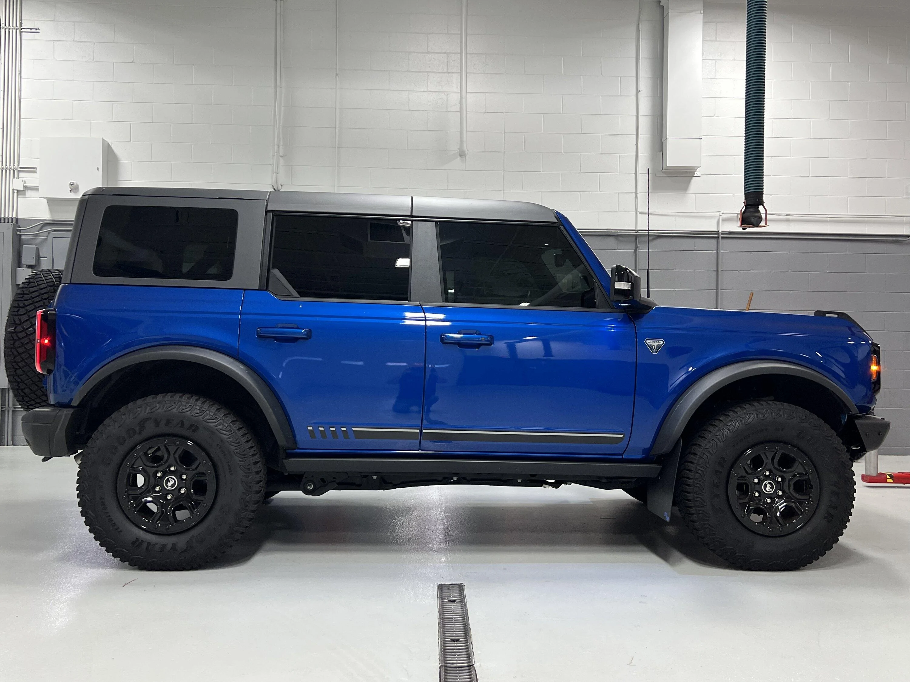

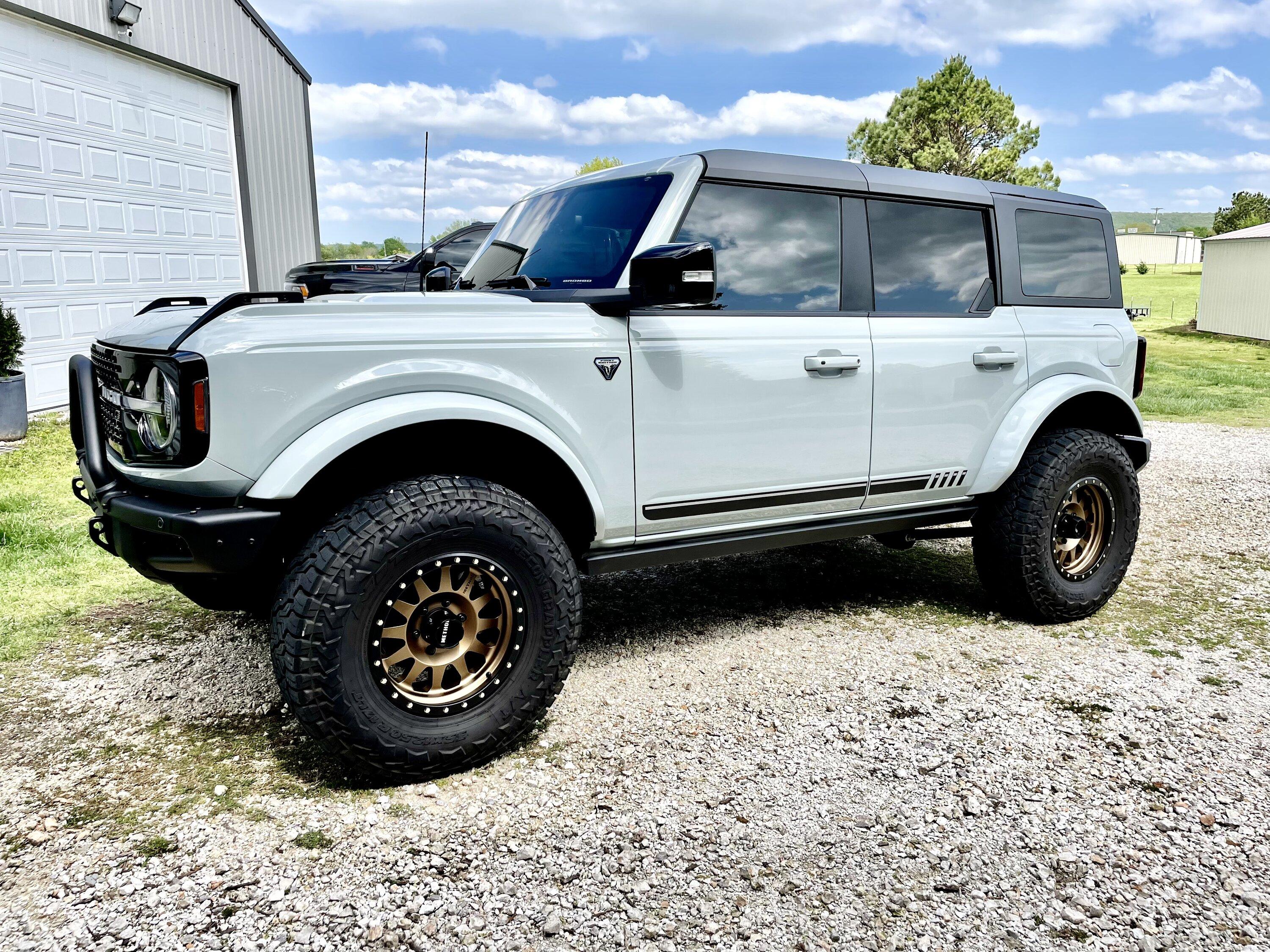

My FE had more noticeably more rake than some other SAS Broncos. It was visually quite noticeable and bothered me as it looked bad in the front to me.
old thread on this
I attribute this to the extra weight of: the hardtop, the metal modular front bumper, and the hydraulic sway bar disconnect, plus maybe some normal vehicle to vehicle variance.
I went with the SVC spring perch collar kit. It was more than a level kit as it raised front and rear but definitely eliminated the rake.
before:

after:
old thread on this
before:

after:
Ford Bronco I just need a leveling kit for SAS 55753983-8ECF-496D-8713-5D11A88AA6A4
Looks great. My wife’s FE was the same way. Much more noticeable rake than other SAS Broncos.
