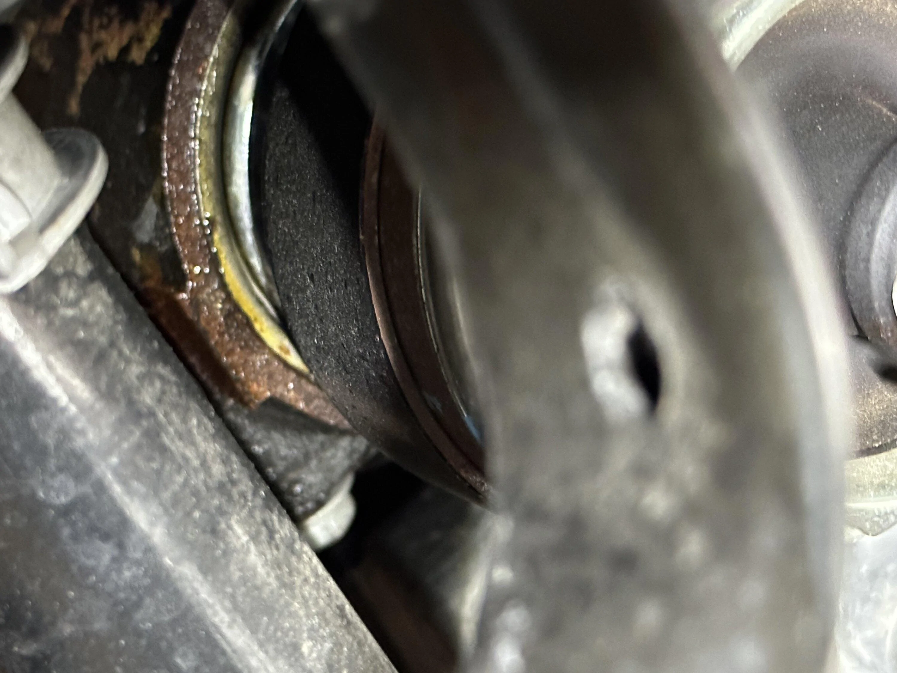

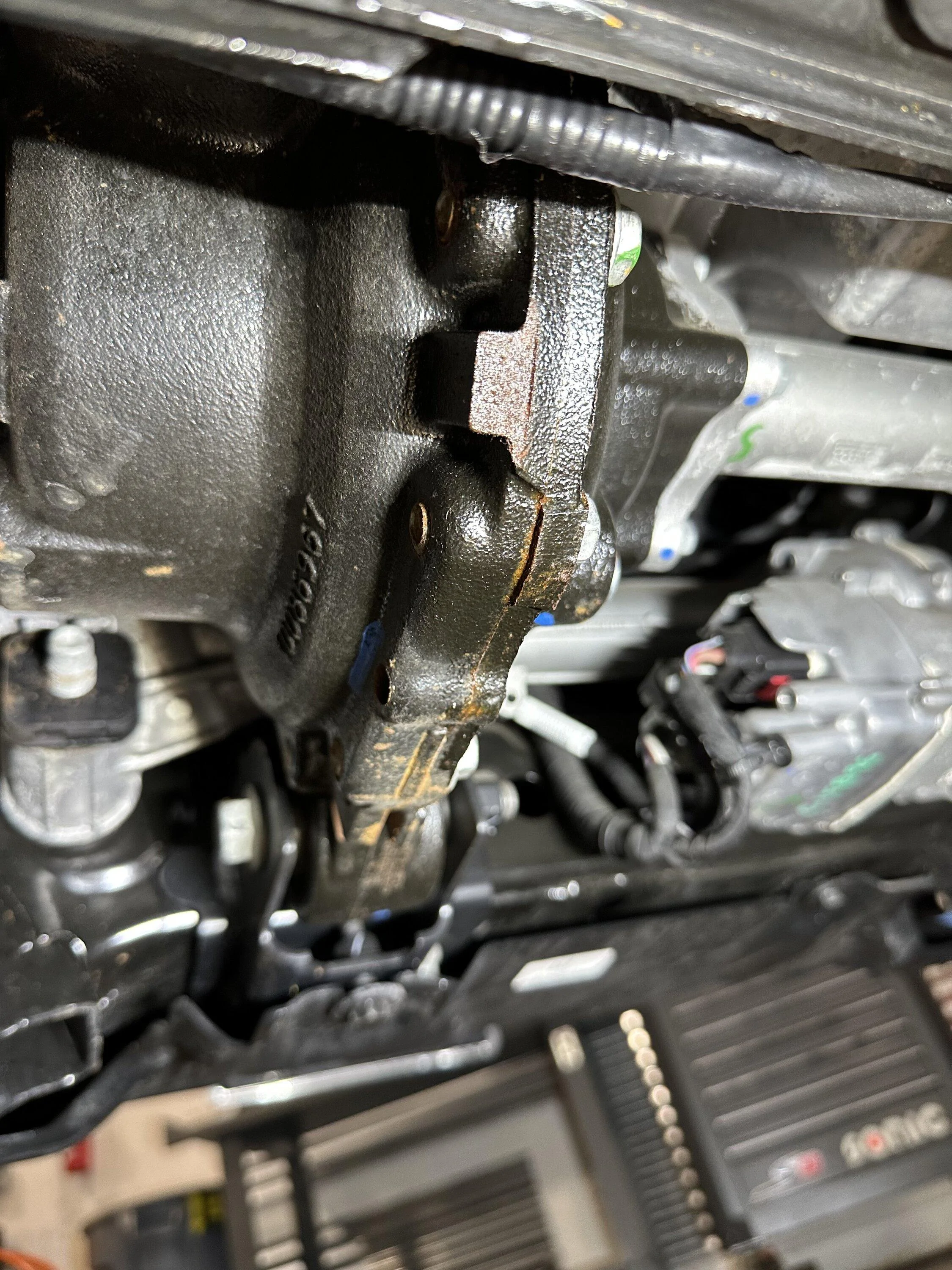

I noticed the front diff leaking from the pinion seal at my 10,000mi oil change — have a service appointment Monday morning to get it looked at. There have been a handful of other forum users posting about similar front diff leaks, and I could see a lack of diff fluid contributing to the failure you noticed. Pics attached of my issue for others to check on their trucks:

This is good info, I’ve got another person that’s had the front diff failure I’ve been in contact with that thought it might be low diff fluids too…
Yeah I’ve been babying it in 2H only since I noticed it, and haven’t driven more than absolutely necessary. Thankfully I’ve got another 2.3L ecoboost Ford to drive in the meantime with AWD and a leaking timing chain cover 😬
