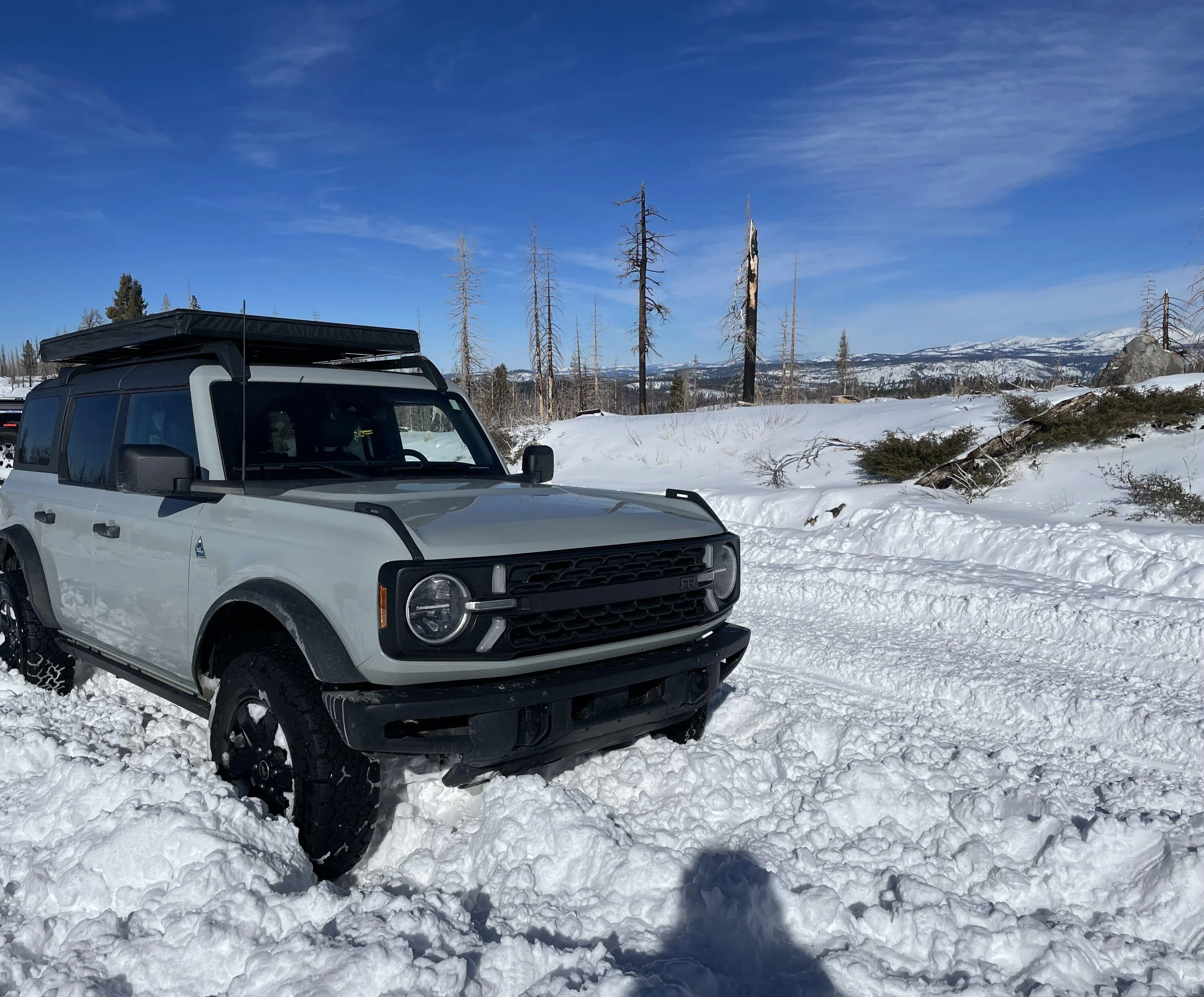

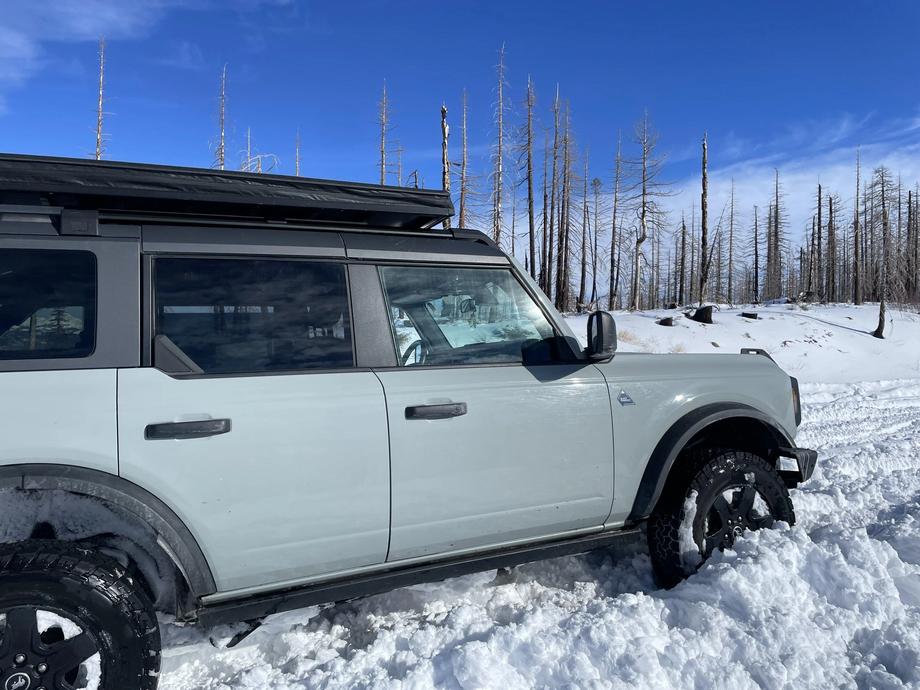

both roads covered in a fairly powdery snow, traveling on it at under 30mph. Both times I think I got stuck because I was centered up on a snow bank. Attempted digging out first, was already aired down. First time I eventually got out with digging and 4L with rear lockers. Second time I was recovered with a kinetic recovery rope, in 4h with rear lockers on. If it’s the lockers then I’m completely baffled as I was always under the impression that this would be the situation that they would definitely be put to use…….
Again, am open to criticism. But I don’t feel like I did anything completely out of the realm of what a lot of people would do with the rig, I was definitely even lighter on the gas the second time around because I was already a little nervous having had the transfer case and front diff biff itself on me the last time I was in the snow………
