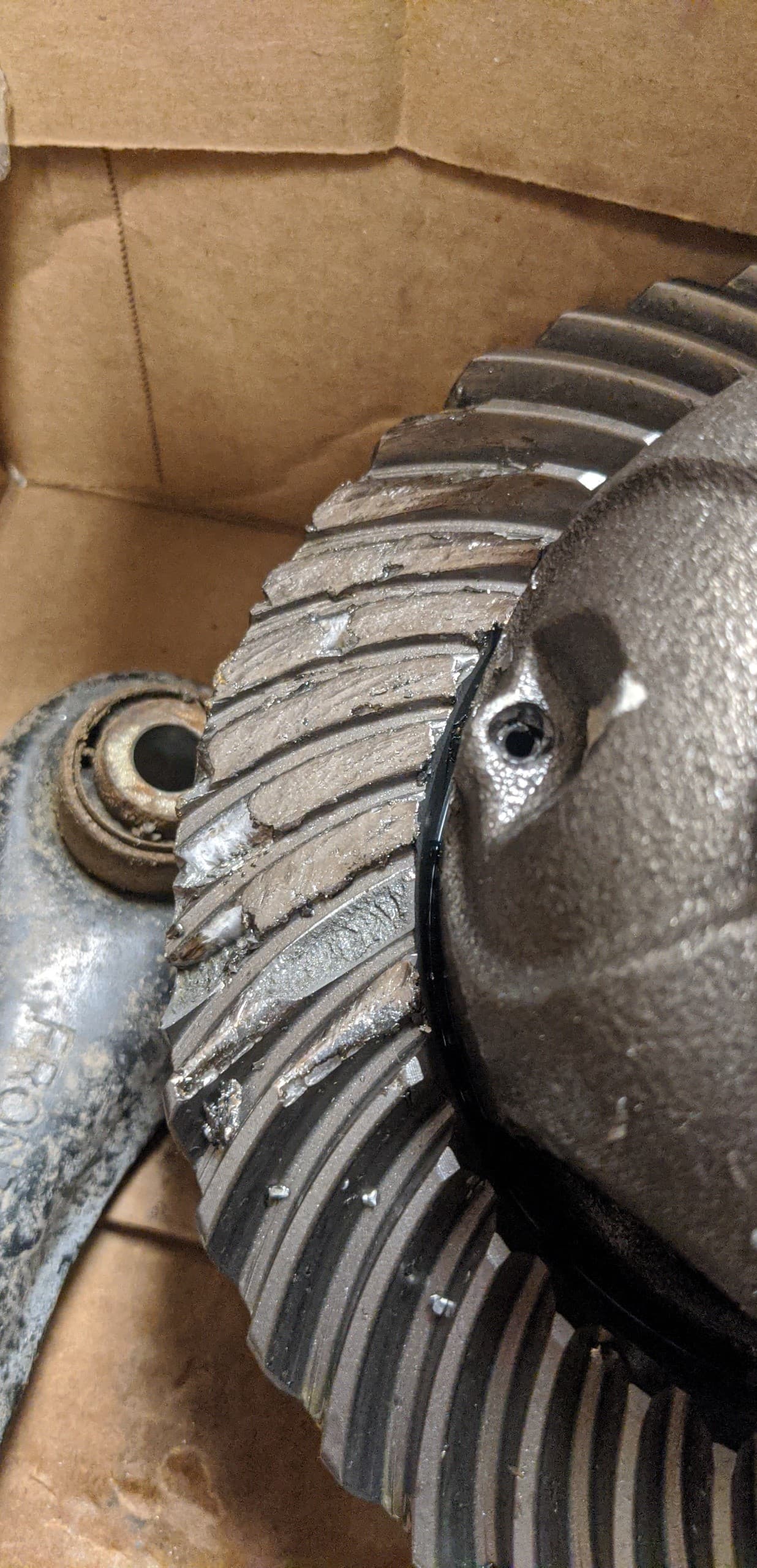

I bet ya the problem here was a locker engaged!
Both rear tires spinning, how fast, I don't know but probably pretty fast, slowly moving forward and then one gets good traction and bam, rear end stops all of a sudden and the momentum had to go somewhere thus a ring gear and transfer case or like OP, just the transfer case.
Don't use lockers if your spinning tires. That's how stuff breaks, no traction to sudden traction and bam! That's my thoughts on the whole situation.
I think people need to learn about when to use lockers and when not to.

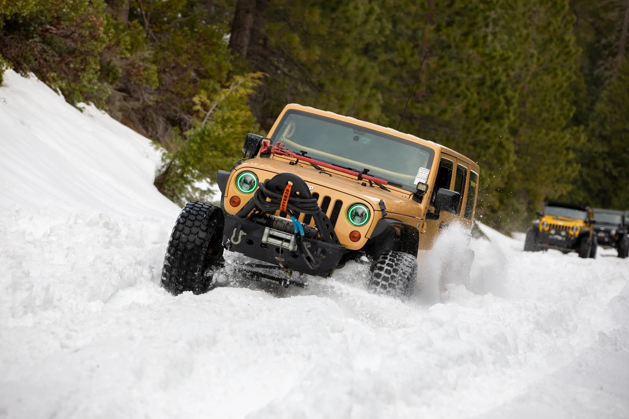

What kind of snow are we talking about?
This kind?
Ford Bronco Second failed transfer case cold-weather-driving-gty-jc-190130_hpMain
Or this kind?
Ford Bronco Second failed transfer case 01-winter-fun-festival-lead-photo-
One I would have no issues using lockers, the other I wouldn't...
4A would be perfect for the 1st picture posted.
4A is 4 wheel drive without the transfercase locked. The front and rear driveshafts can move at different speeds.
4H/4L the transfercase is locked. The front and rear driveshafts spin at same speed.
This kind?
Or this kind?
So would you have engaged the rear locker in the second picture?
@Kickit OP, which picture were you in? 😘😘
This kind?
Or this kind?
I was not on a city street. It was definitely picture 2, driving down the road in 4h but I guess I should have been in 4A. In fact, Here is the exact picture of where I was stuck……..
