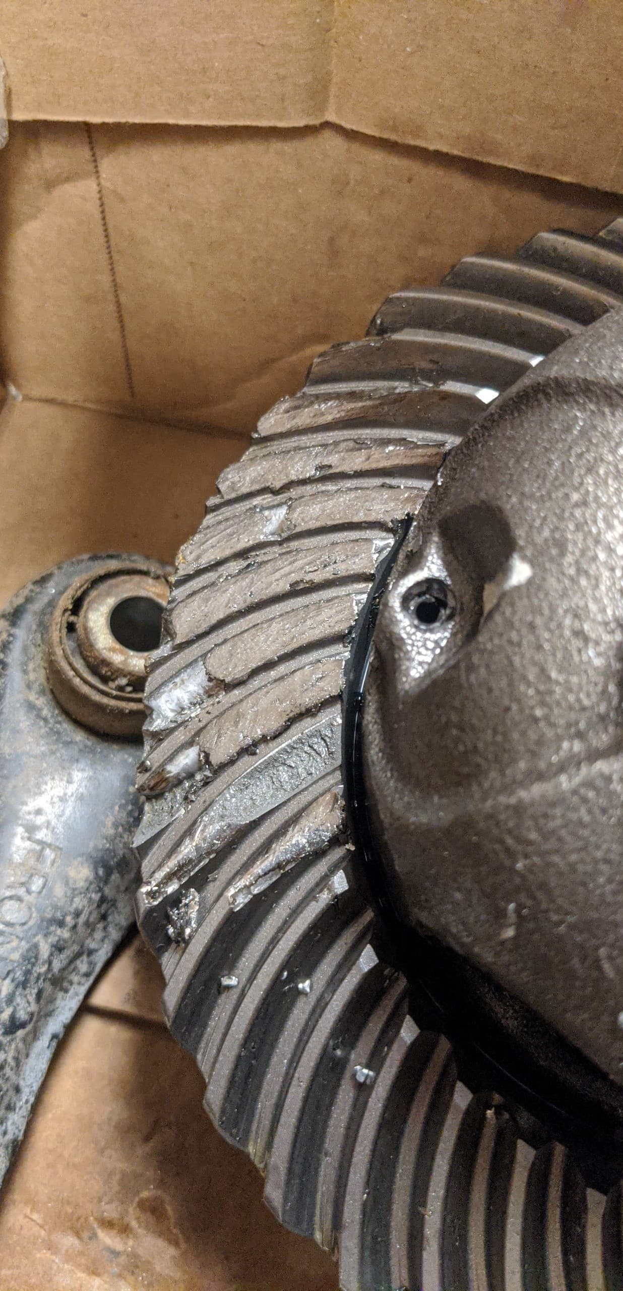

I blew up one of these cases in my old ranger. I work at the dealer so we opened it up. I'll see if i can find the pics.
What happens with these most of the time in snow or ice, is that the tires spin, then abruptly make contact, coming to an abrupt stop and shred the gears like butter. The tech write up will most likely just say internal failure.
Not saying this is what happened to you. That's what I did..... and what most that we see have done.
When you say shredded the gears, are you say the planetary gears shredded or let loose? I've never seen them shred, but have seen them separate. The Teraflex 4:1 units would do that at high RPM. Had a few guys in the local club have that happen & I wasn't going to be next so sold it & in went a 5:1 Atlas 🤠

This is what I call shredded. This was my 19 ranger. same case.
That's a ring gear not gears inside the transfer case but shredded for sure ;) But yeah @Snacktime has some recent experience with that.
