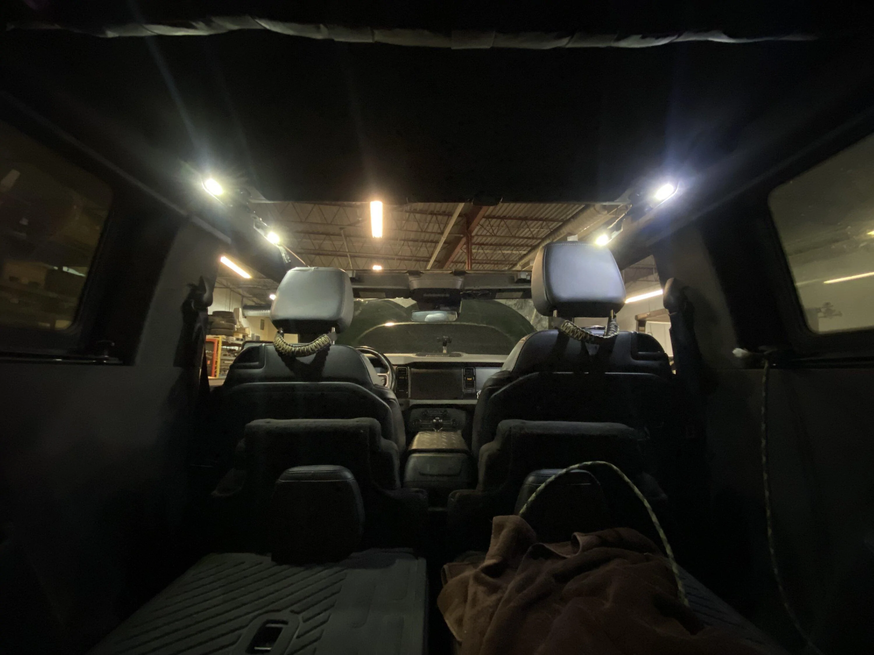

Oh, this sounds exactly like what I am doing/have done!
Ford Bronco Installing the IAG Interior lighting question IMG_7334
Ford Bronco Installing the IAG Interior lighting question IMG_7388

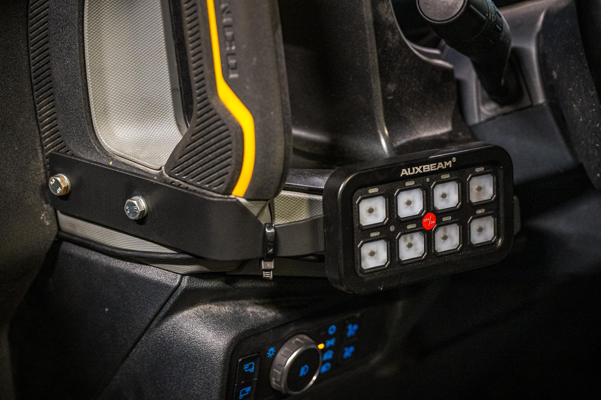

The Auxbeam controller shown is mounted on a stainless steel bracket that I fabbed up and bolted through the grab handle.
I installed the IAG lights as the instructions followed. Instead of hooking it up via harness tap, I cut off their connector and soldered on a length of wire. That wire was then ran through the firewall and into the engine bay.
Both the Auxbeam switch panel wire and the IAG power wire are currently coiled up in the engine bay as I had run out of time to continue the install.
Next up will be a bracket to hold the solid state power distribution block, this will sit over top of the fuse panel in the engine bay.
Plug it all in and Voila, we have on demand lights that don’t take up any of the Aux 1-6 triggers. I like the location of the auxbeam switch panel due to it being out of the way, but also accessible at any point. With it running only peripheral stuff, it’s perfect in its little low key home.
