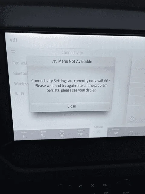

When I tap on Connectivity Settings within the Connectivity screen, the pop up menu will either display a spinner and close (without any message) or a dialog titled "Menu Not Available" with the message "Connectivity Settings are currently not available. Please wait and try again later. If the problem persists, please see your dealer."

I get the same screen below .. I am pretty sure my modem is dead
I disconnected the battery and this does not work

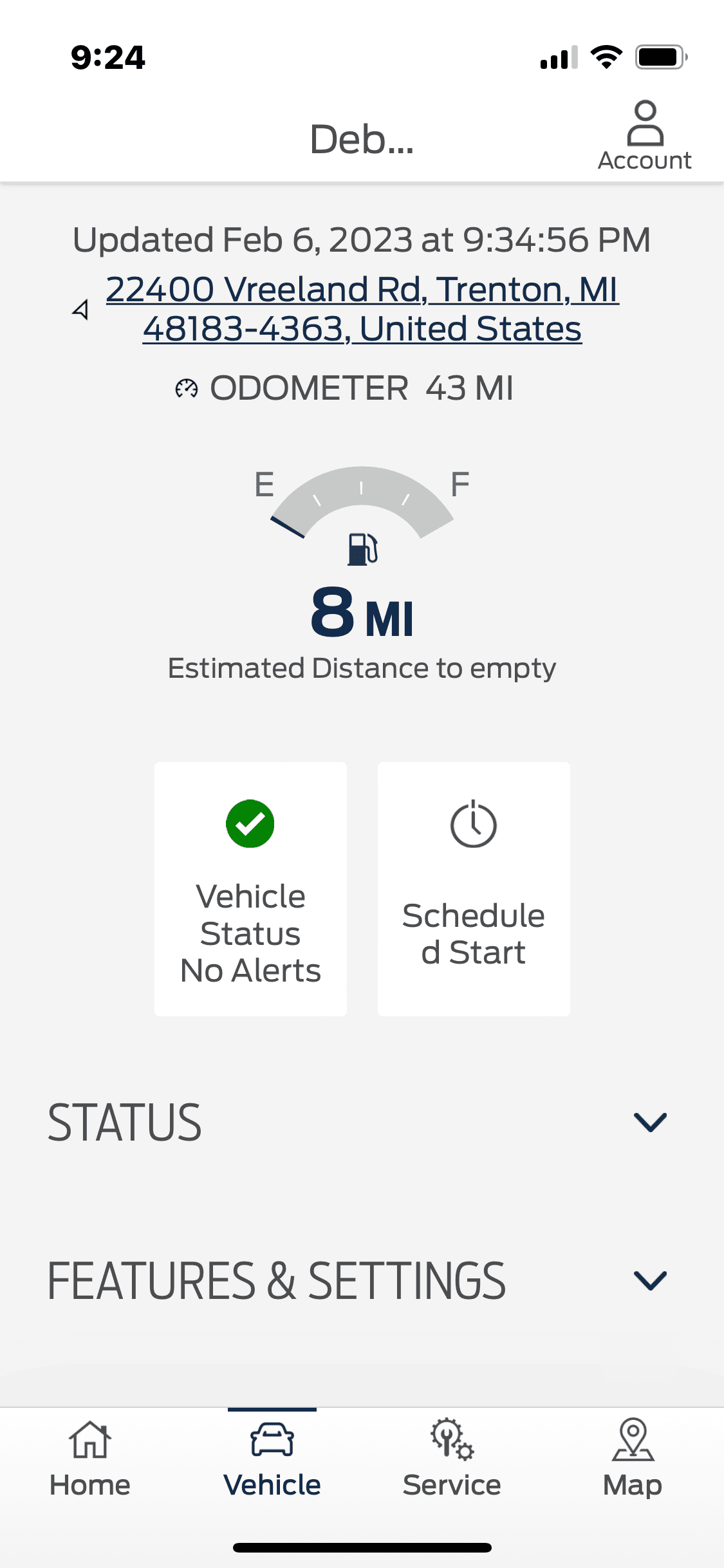

I called last night and tech said thereā€™s a software glitch in the app. Itā€™s supposed to fixed sometime in February. Mines been not updated since 1/6. I wonder how often this happensā€¦

Can you tell me if the app can still show its exact location if itā€™s down? Mine was activated at the plant for some reason and then the app didnā€™t show updates since the 6th. I was wondering if the vehicle moves if the app isnā€™t working does it give itā€™s gps still?
no it's showing current location of my moms house where it was on the 11th.
And is the vehicle there or with you at your home?

vehicle is with me.
Ok so maybe mines on the train instead of showing at the train yard.,my eta is today 2/15-2/21 so weā€™ll see if that date changes. This has been such a debacle this latest takes the cake.
