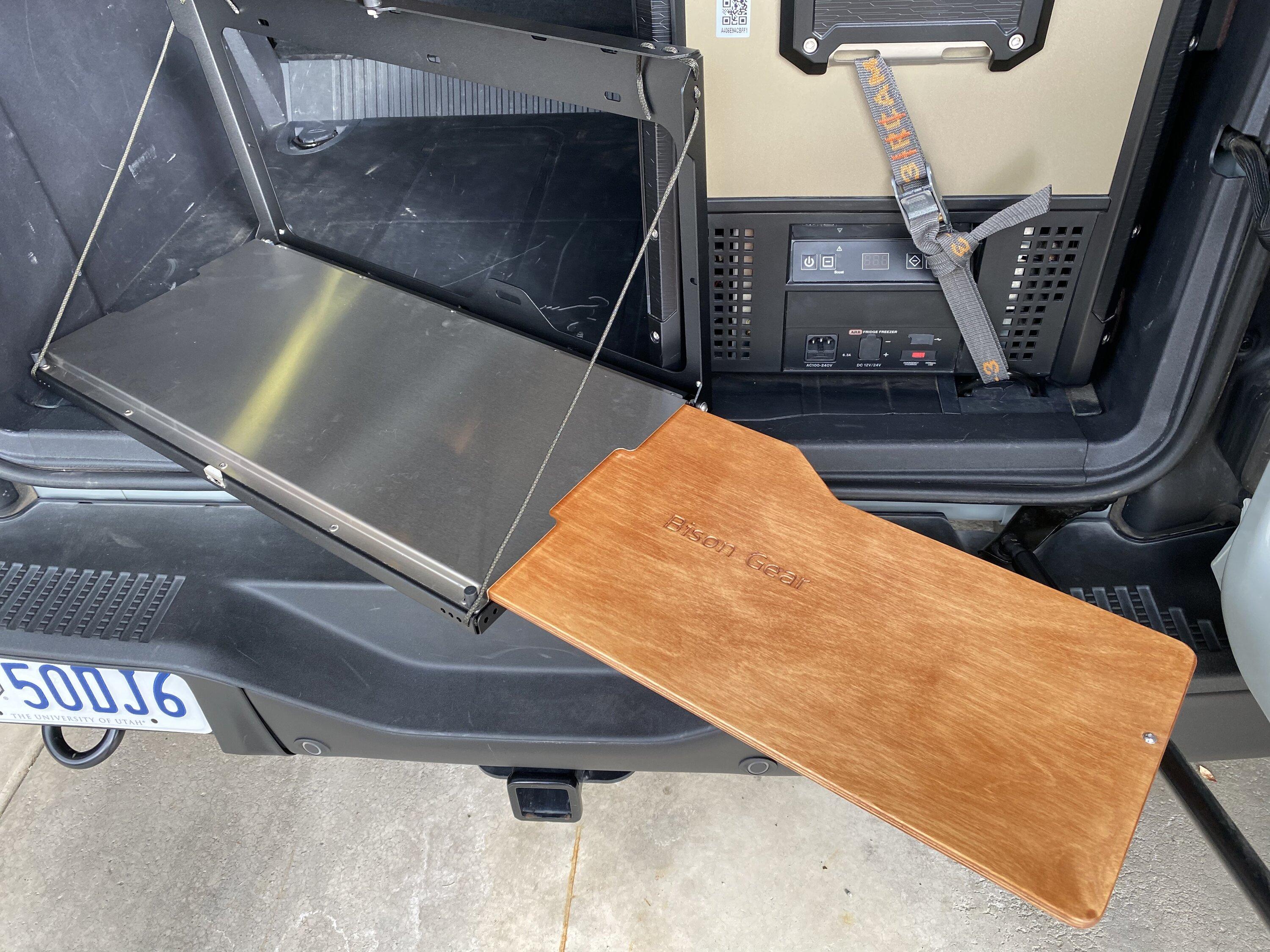

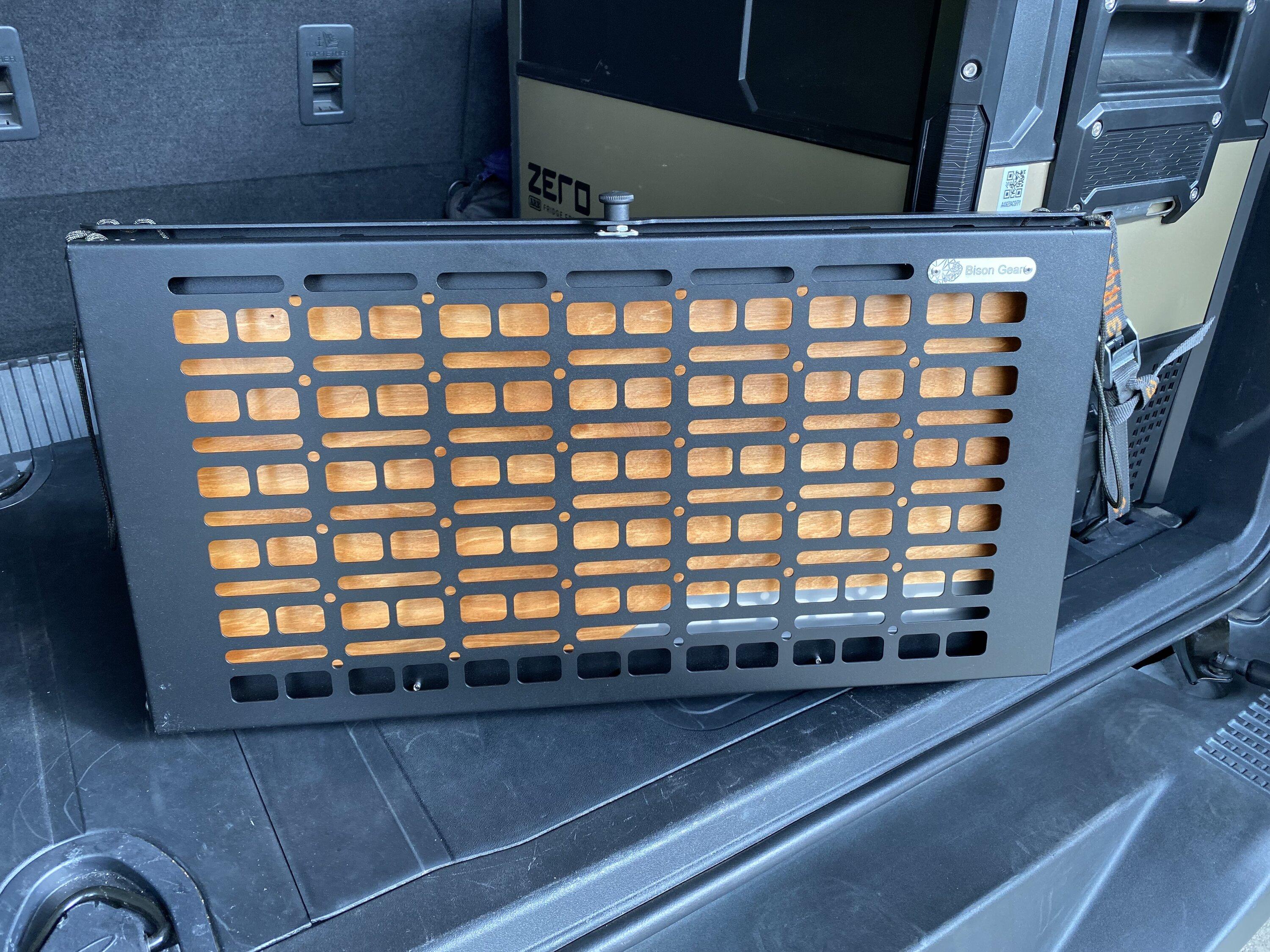

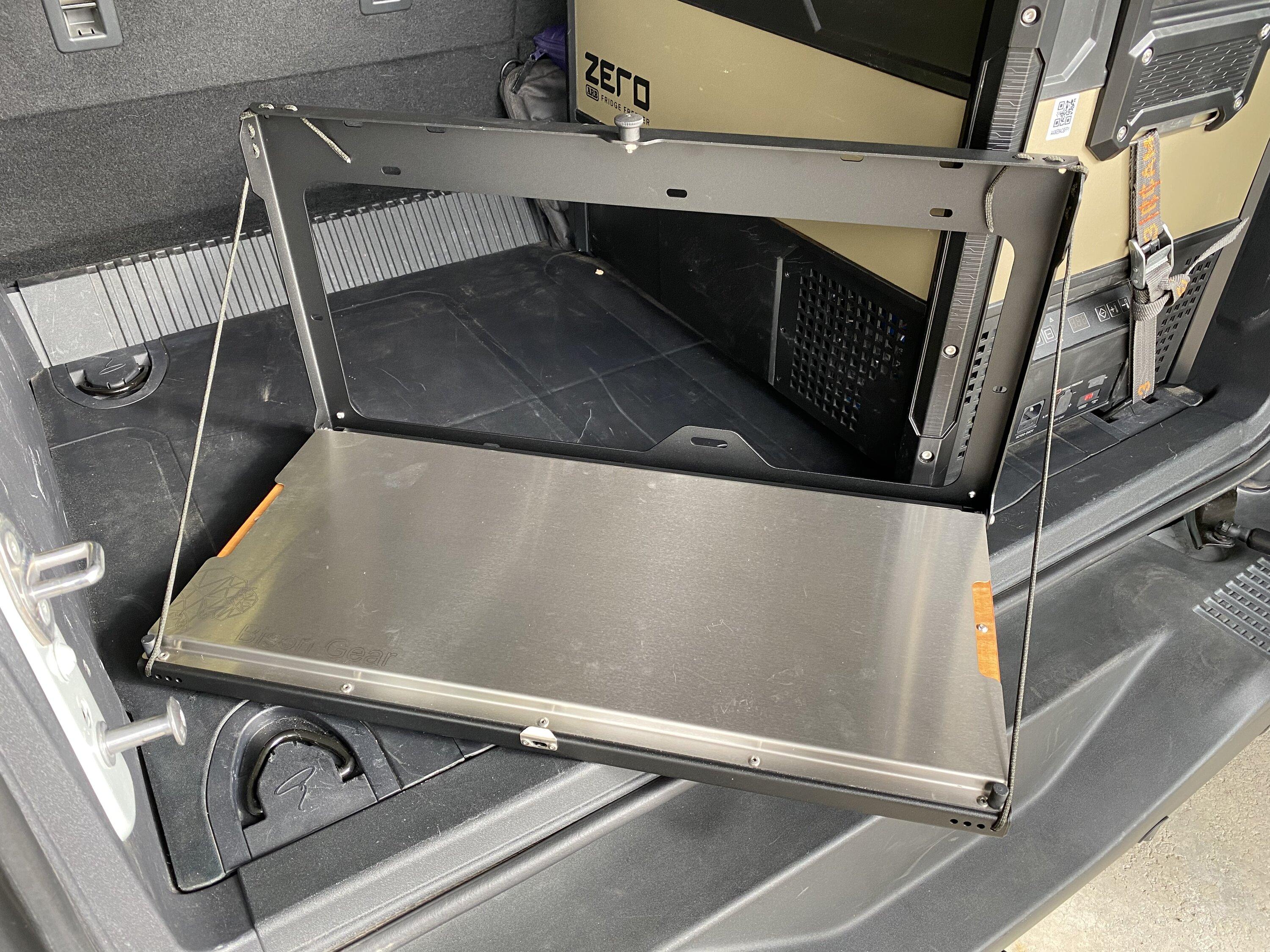

I got the table in from bison-gear and aside from predictable issues with fitment, it’s pretty awesome. $211 for the product and $79 shipping from Poland. Took 9 days from order to delivery
Ford Bronco Jeep tailgate table for Bronco 1C7C873E-E40B-4816-A40D-6E57C6D35A52
Ford Bronco Jeep tailgate table for Bronco 138CB03C-A098-4240-8C2F-9F95CBE2DF7C
Ford Bronco Jeep tailgate table for Bronco CC5F334D-372D-4C97-A79C-FC7C0C21D872
Still working on how I’m going to mount it but I think I’ll need to drill one hole in the bracket and two holes in the tailgate for four mounting points. Additionally, the recess in the wood table will need to be trimmed a bit to clear that tailgate protrusion.

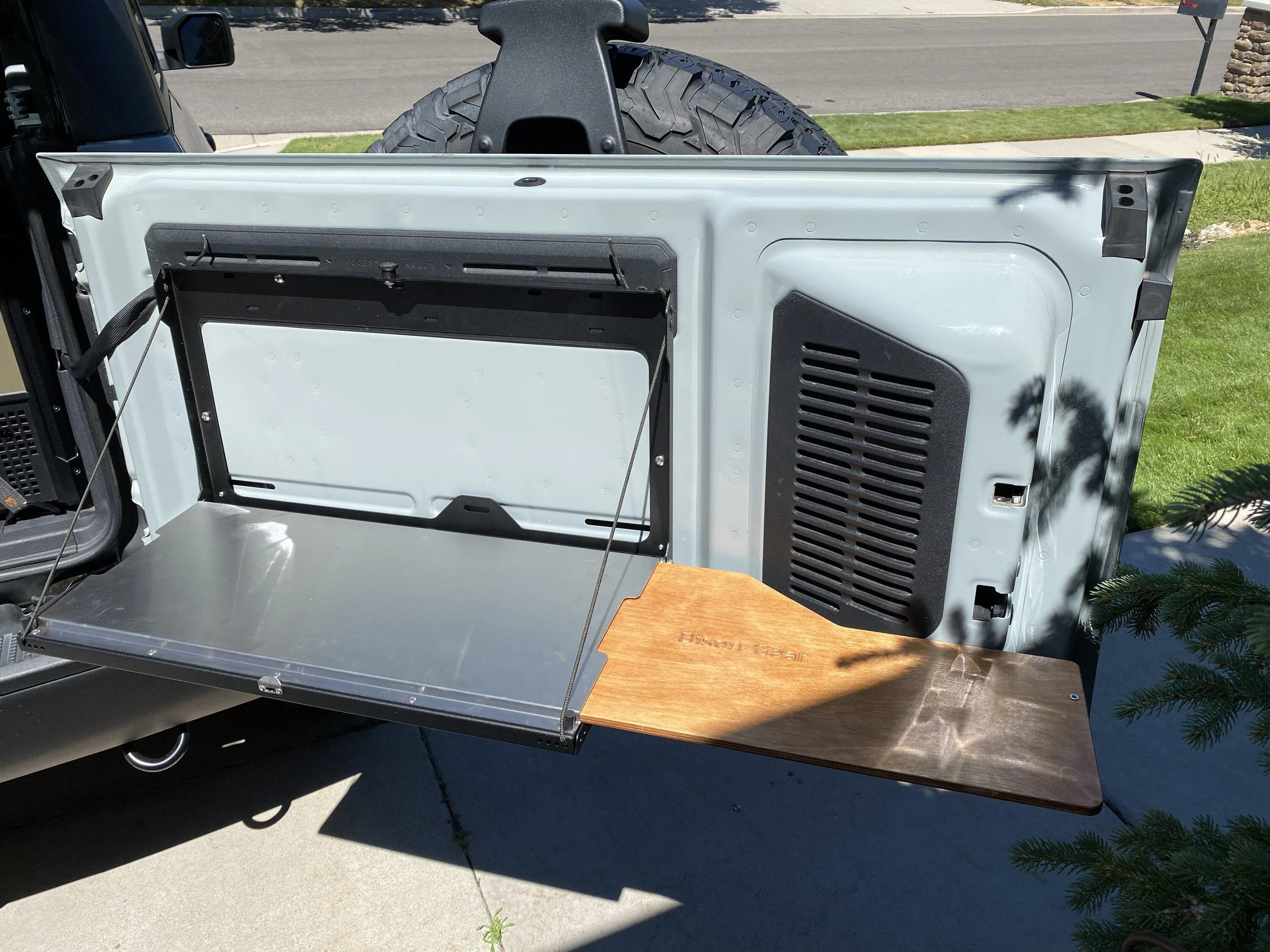

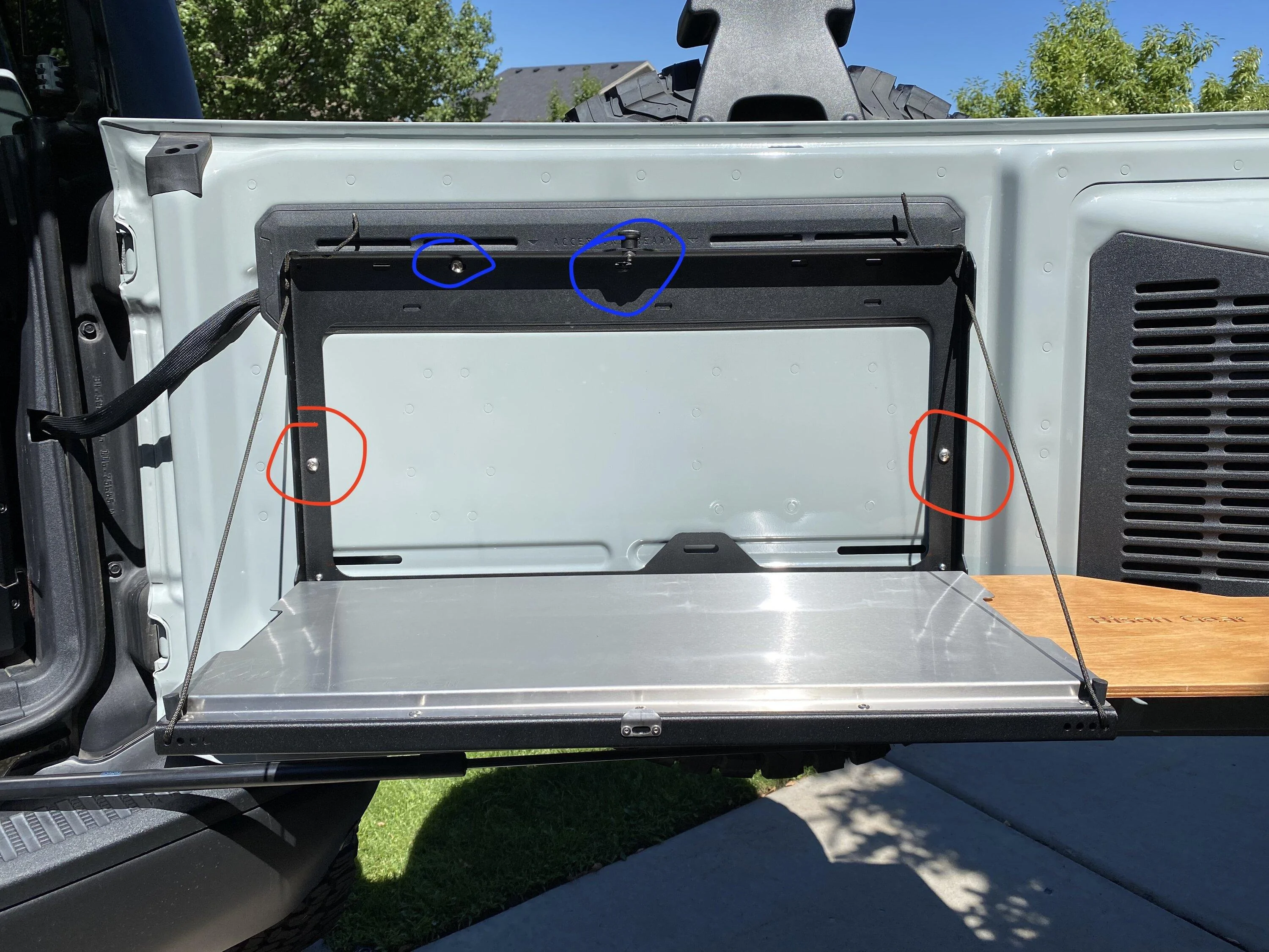

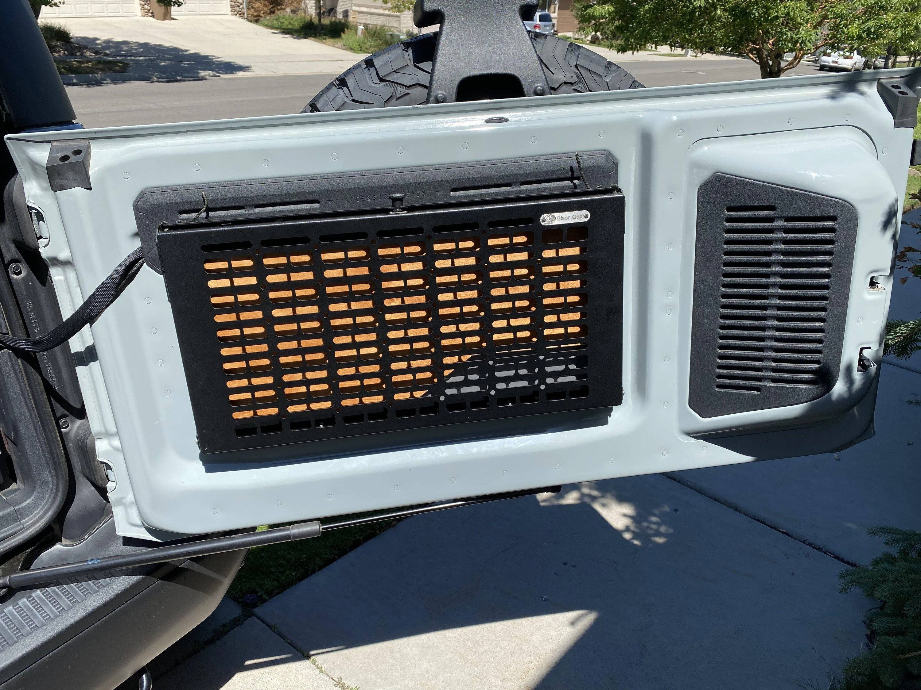

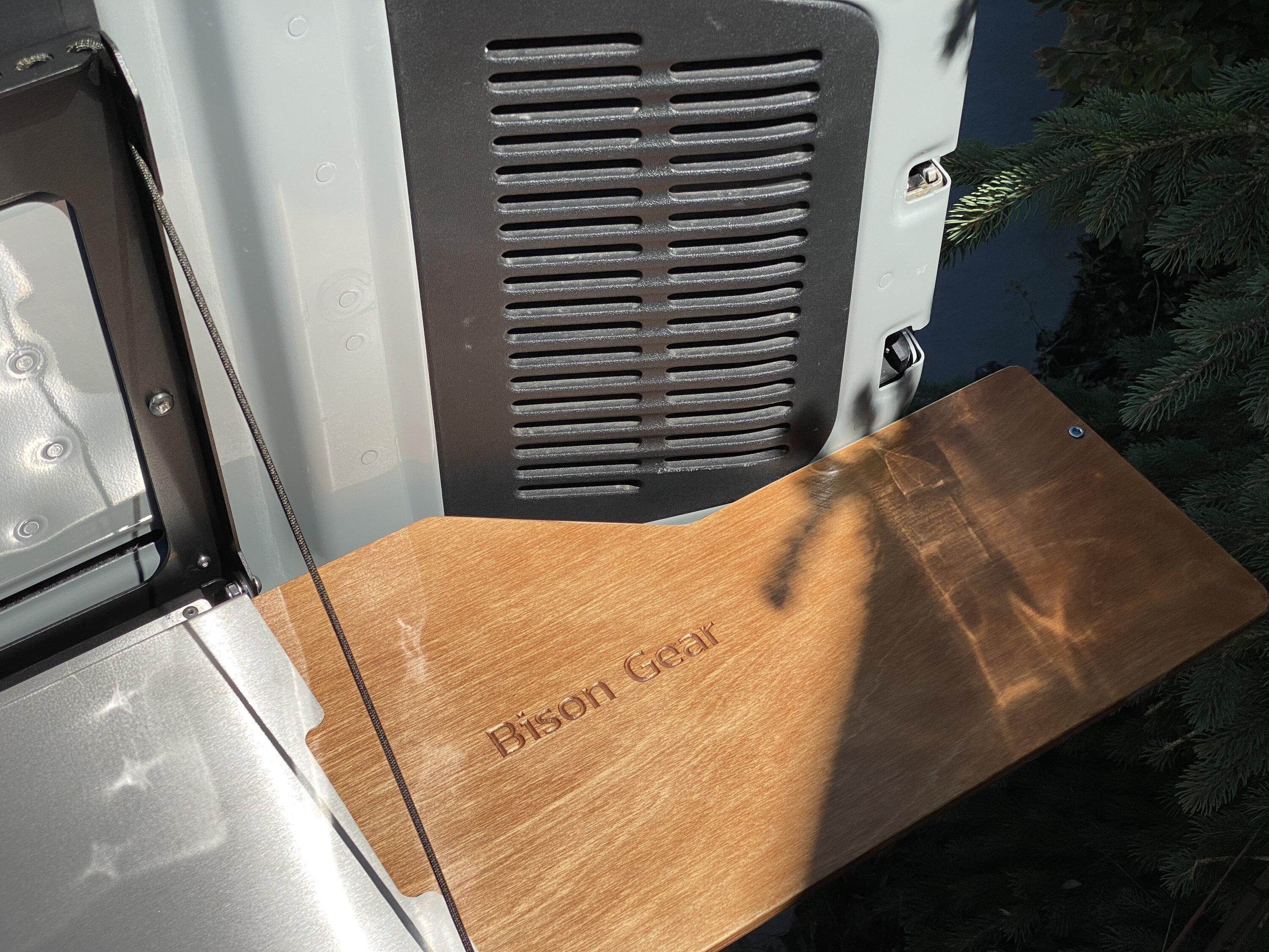

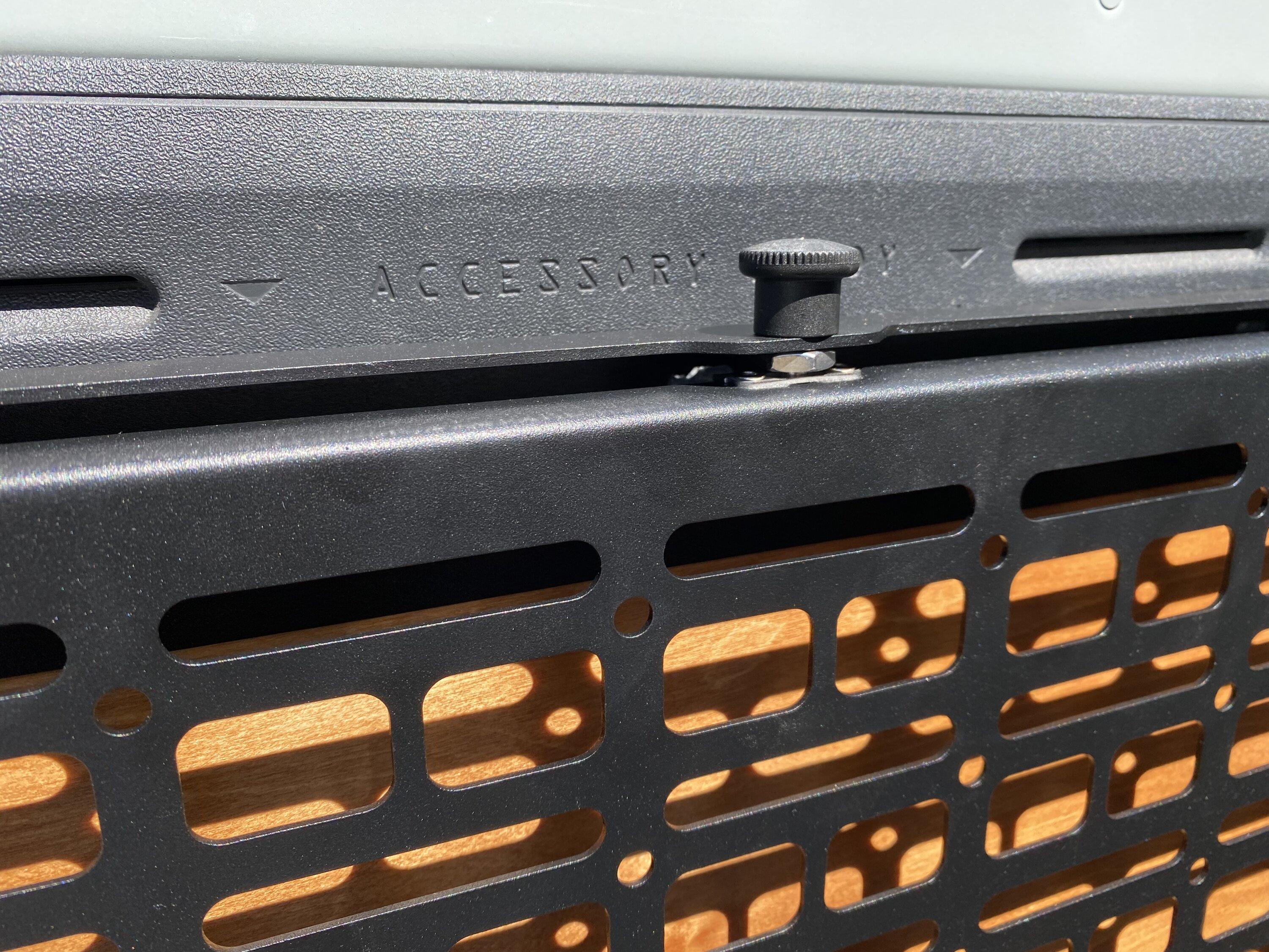

I installed the table this weekend. I decided to use two existing tailgate holes at the top of the bracket, circled in blue. I inserted two 1/4x20 stainless rivet nuts there and used two 2" stainless screws to hold the top. For the bottom, I drilled two holes in the tailgate to accept 1/4x20 stainless rivet nuts and used two 1" stainless screws. I didn't modify the mounting bracket at all and used existing mounting slots as there's quite a few to choose from.
The table is solid and doesn't rattle at all. Interesting that they used paracord for the hinges and it seems to be solid. My gut said to change that to a stainless cable, but after thinking about it, I don't think I need to do that. The slide-out wooden extension was a little too large to clear the tailgate protrusion (what is that thing called?) so I had to trim that wood back around 1.5-2" to clear.

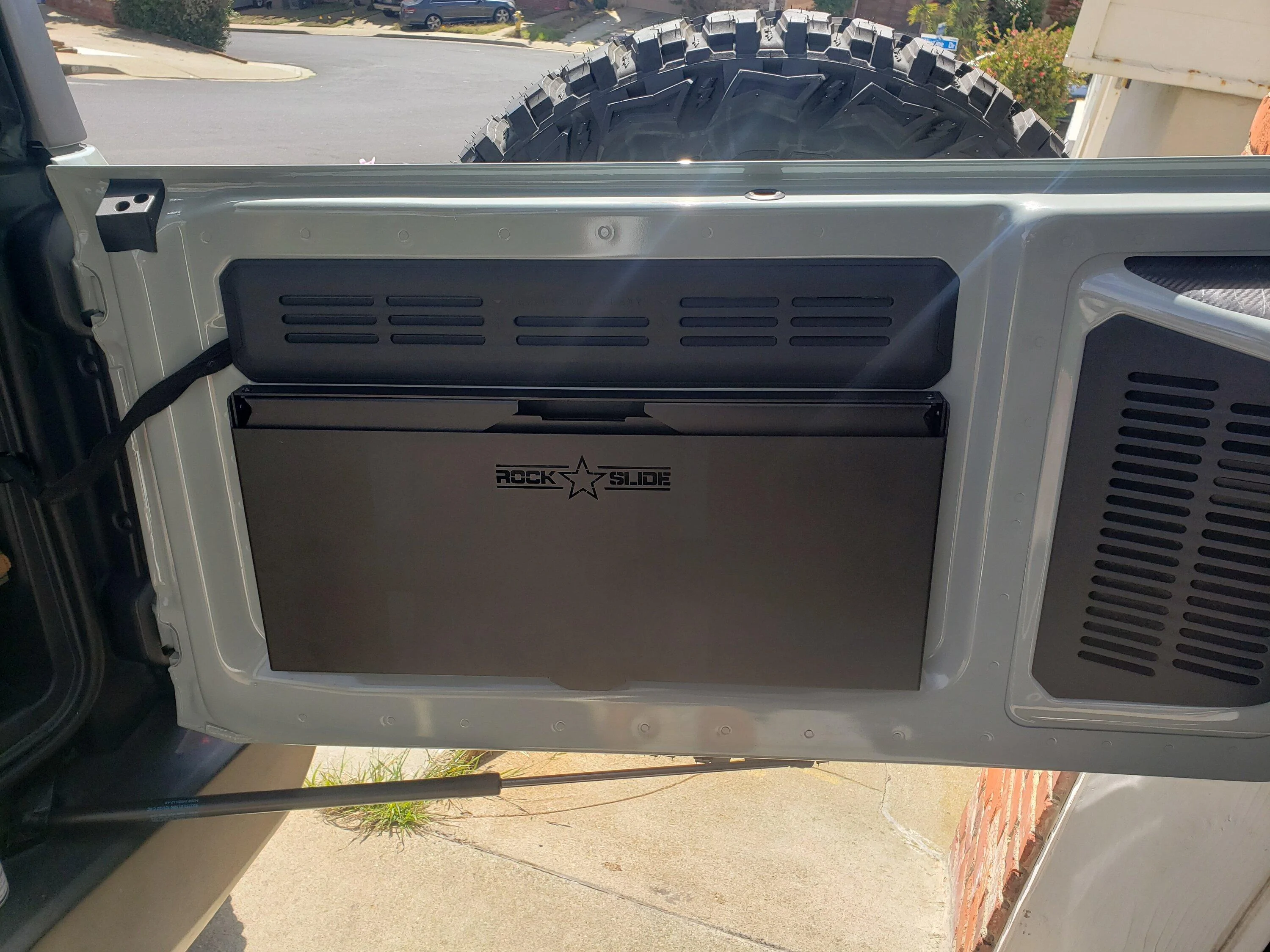

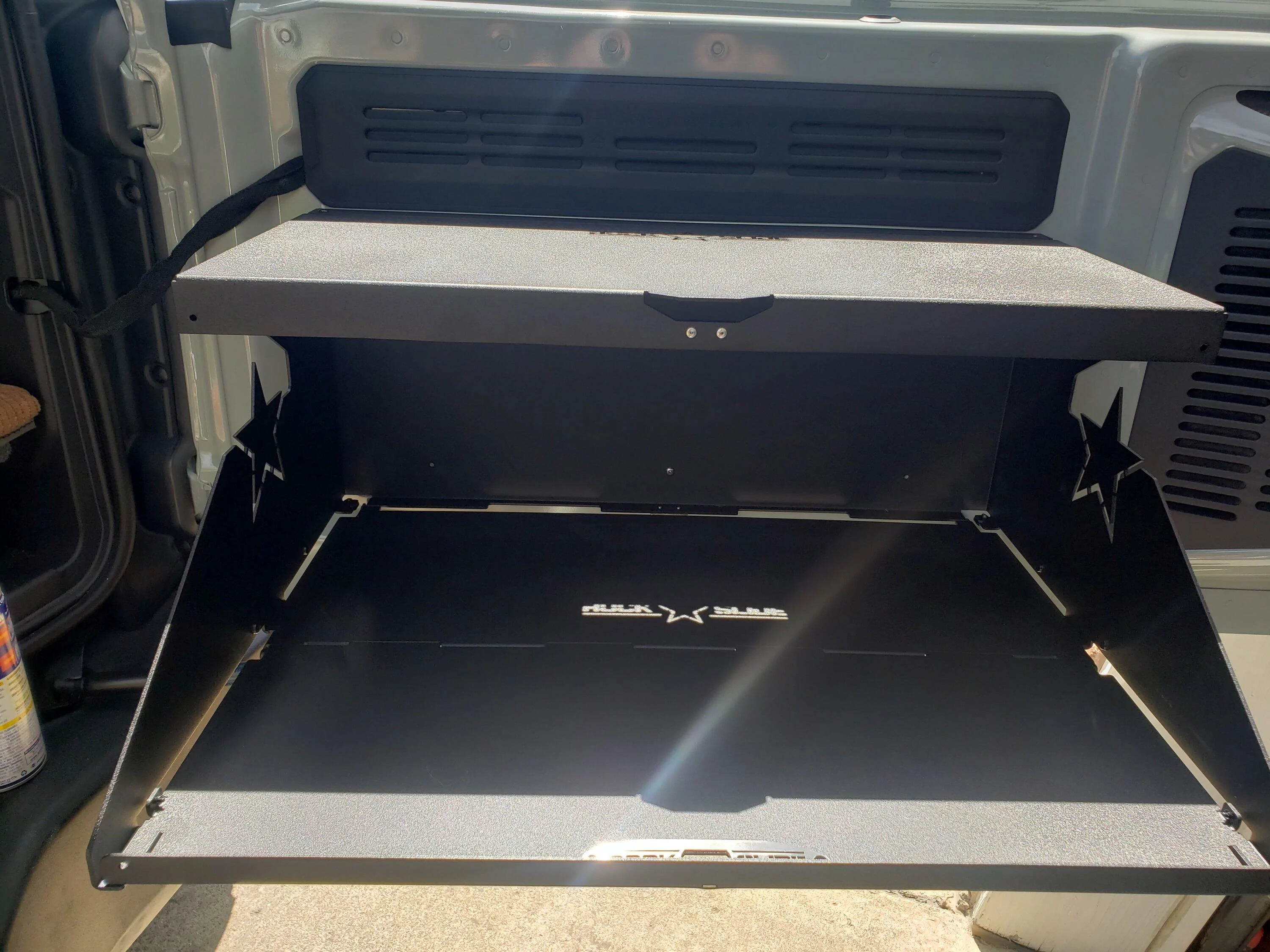

Rockslide engineering, took all of 20 min to install made for a jeep, fits perfect zero rattles my grill fits perfect.
I bought this exact one for my Jeep because I knew it was the same part number for the Bronco.
Plus I like the fact that it basically comes with two shelfs and that bottom shelf comes out really far once you open it up
