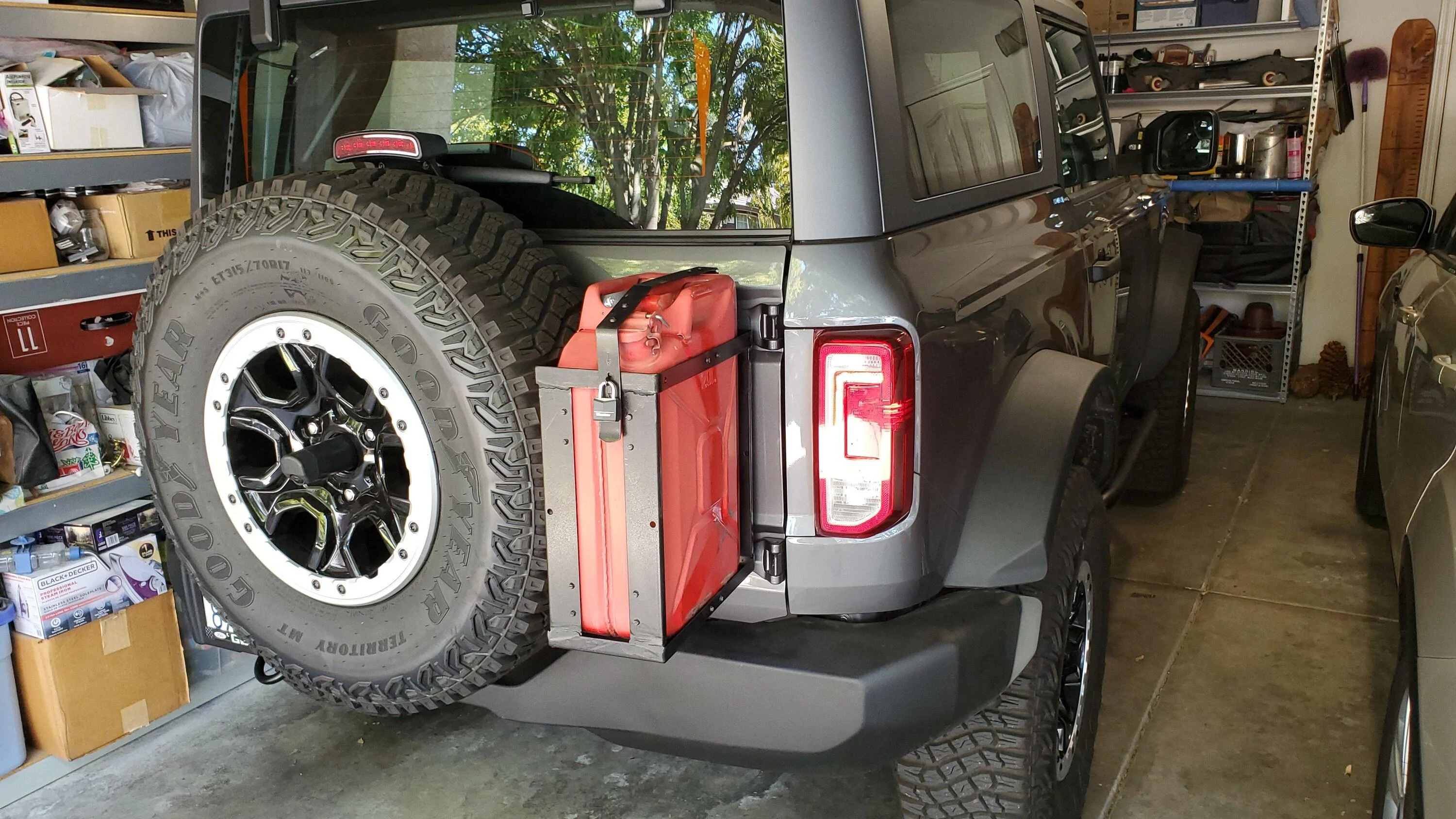

Decided to build a Jerry can mount after not finding anything currently available. It's made out of steel and I will probably build one out of aluminum to cut down on the weight. It's mounted on a Hammer Built tailgate reinforcement plate and so far so good!

Got my Jerry can mounted. I used the Wavian mount I bought at Swiss Link. The mount is built to mount on the bottom, and isn't as rigid as I would like. So I added some metal on the back to mount to, and some stand-offs to clear the Hammer Built plate mount bolts. I also welded more of the joints and it is now very rigid, and not too heavy. Anyway here is a pic. Looks a lot like the original post by @Eljohno
Note: I used my old faded can that I used to carry on my JK.
Ford Bronco Jerry can mount build. 20220905_155124

Forgot to talk about the strut. Be careful because the factory strut allows the tailgate to open too far and the can/mount will break the tail light. You can order a 28" strut off of Amazon. I got the one with 30 lbs of opening force, works perfectly.
