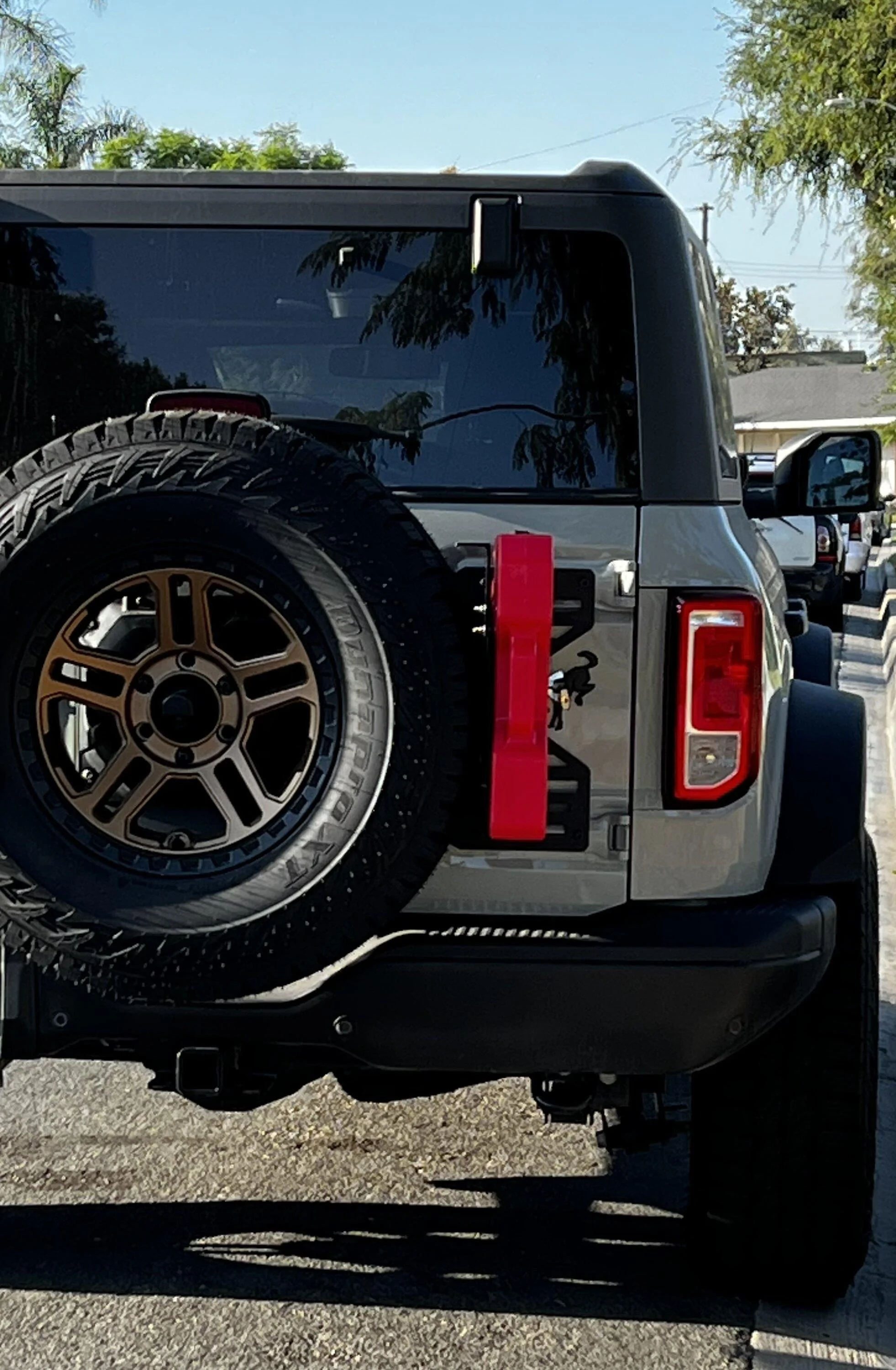

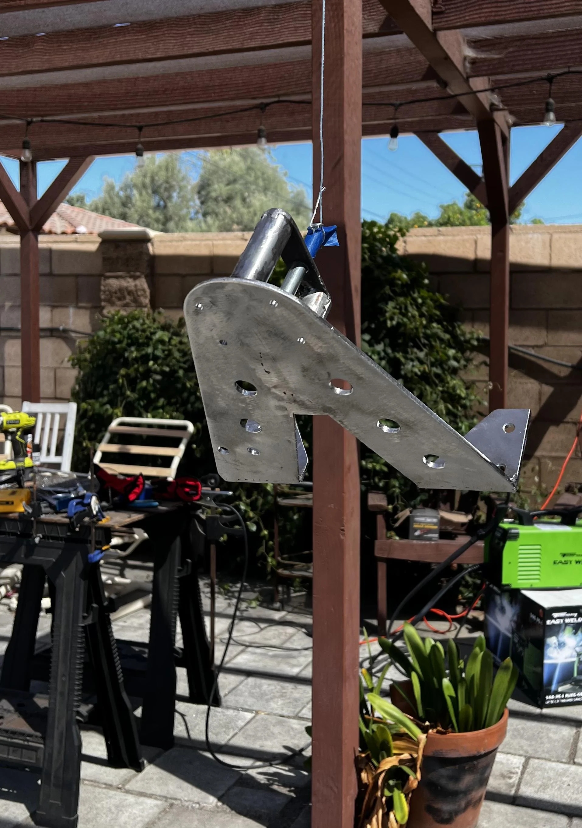

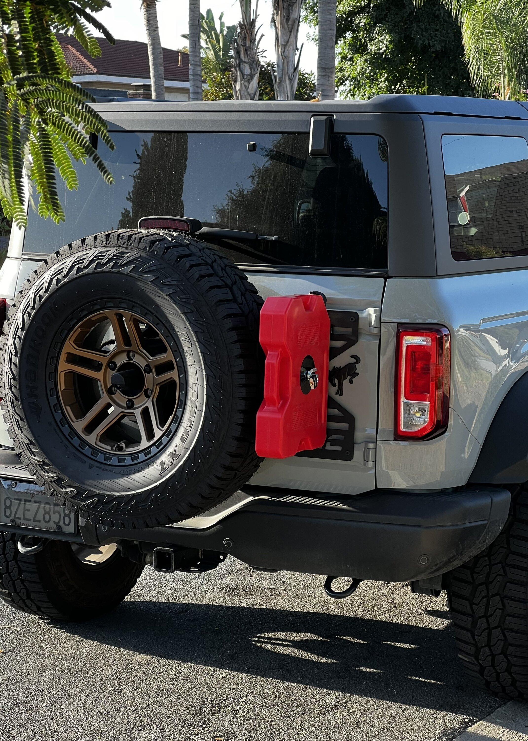

I built similar, but for Rotopax, and custom rortopax locking mount as well since I didn’t want to buy one from them for $60. I didn’t take many pics during fab and will have to take more pics of fuel can not mounted but here’s a few ✌
Ford Bronco Jerry can mount build. E9AE256D-93FD-4B8F-BAA2-128294CBAC8A
Ford Bronco Jerry can mount build. 837A3865-428D-4CA0-8631-49B9D97D4C31
Ford Bronco Jerry can mount build. 48CE5888-61FF-4DD2-965C-387BD38C7740
