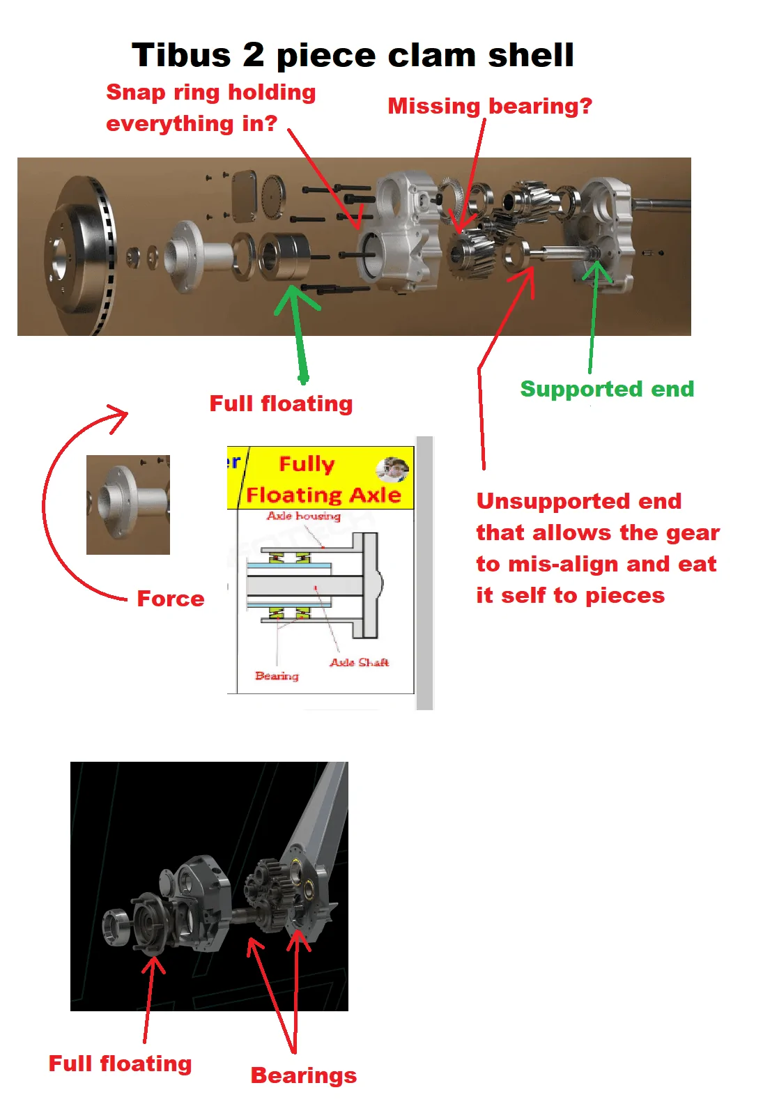

Some red flags, biggest issue is how you don't end up with to much play in the system as that makes gear contact shift. Its like setting gear pattern on a ring and pinion. A bad mesh will last 1-5k miles and a good mesh will last 150K miles.
Icing on the cake
I agree with a lot of what you pointed out but I think the "missing bearing" is just to the left of where your right most red arrow is pointing. So that would leave a hefty "wheel bearing style" dual race bearing outboard the gear, and a normal single race bearing inboard, which would satisfy the definition of "full float".
I also am one of those who would be willing to take a hit on efficiency to have the robustness of 4 gears, but regardless of 3 or 4 gears. These guys are right that a helical gear is superior to the spur gear, assuming you use perfect meshing and adequate bearings to handle the thrust loading.
I don't think its all propaganda, but you are right to bring up some of these red flags. Big one for me is the snapring as you pointed out.
Also, if they are going to force me to ditch my production 6 bolt pattern, why not go all the way to a proper 1 ton 8 bolt? Going to a 5 seems like a big miss. Hopefully that's just CAD mockup.

Instead why are you bothering with Tibus who absolutely have a reputation of being crap? Did Tibus fix it's issues of semi floating design? I watched the Tibus portals burn at the stake on pirate4x4 years ago why relive the pain?
Im sorry could you please give more details on why you call their reputation of being "Crap"?
1st off anytime you have innovators like Tibus designing and doing something that has never been done before that comes with some hiccups along the way. Tibus was the first to ever bolt on Portals. Ill do my best to answer your concerns and BTW I appreciate the comments and discussion, this helps to educate the community on why Tibus is the best in the industry.
PS hopefully you had a chance to read the Blog post because a lot of concerns can be addressed there. Meanwhile just in case here are the links just in case.
https://broncbustertx.com/blogs/bronc-blog/comparing-tibus-top-us-axle-portals-explained
https://broncbustertx.com/blogs/bro...ansforming-the-6th-gen-ford-bronco-experience
Here is some additional information that I believe will answer some of your other concerns that you had as well.
The drive shafts are full float and the vehicle's load is on the large wheel bearings with the flanges and not on the lower shaft.
The gears are guided so well that there is no problems with mesh.
I believe the problems described can only be based on Generations 1 or possibly 2. This old construction has been adopted by other manufacturers. Tibus over 20 years has learned and improved. The others are still trying to catch up.
For 20 years Tibus has equipped more than 500 vehicles with portal axles, which together have driven over 5 million Miles. That should be enough proof of durability.
Tibus portals have passed the very hard TÜV tests in Germany which is a mandatory to get them legal on the road.
Tibus has designed and tested various portal systems, whether with 2 gears, with 3 gears, 4 gears or with a chain.
At the end of a long test, they decided on the best variant, namely 3 gears with helical cut gears.
