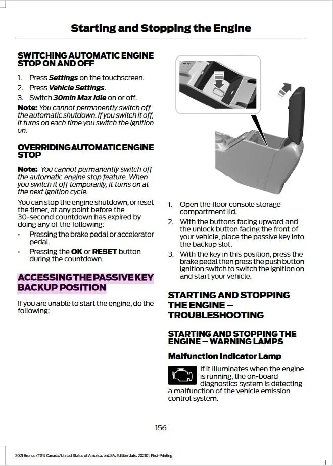

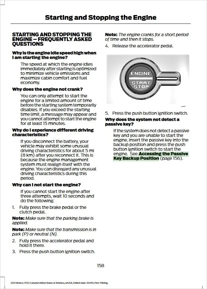

Or at least train us on how to get it to work when it happens....
It's covered in the Owner's Manual...
Ford Bronco Key not found error Accessing the PassiveKey Backup Position - Pg 158
Ford Bronco Key not found error Accessing the PassiveKey Backup Position - Pg 156
