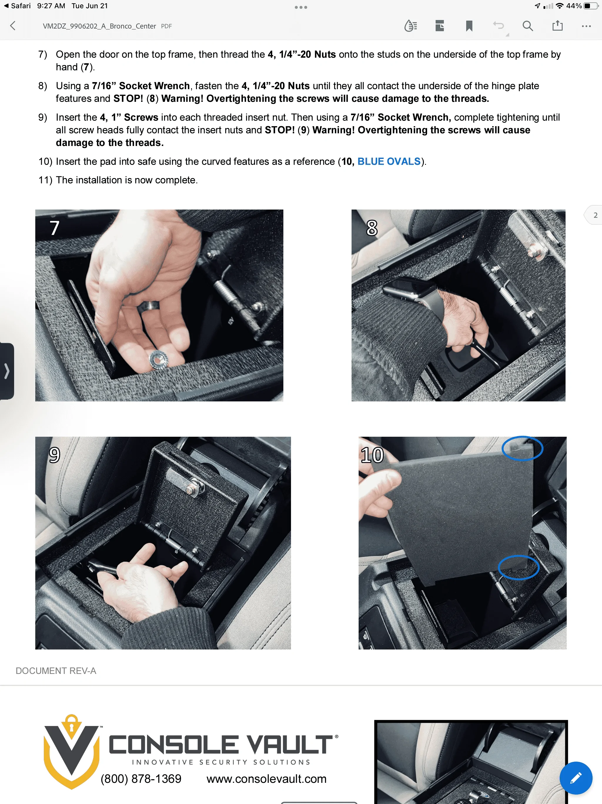

I have the console safe in mine so I would be SOL when it comes to putting it in the indentation. Mine was a weak battery in the FOB.
Been wondering about that. No opening in the bottom? Drill one?
There is no bottom it’s just a locking lid? Side pieces and a lid the bottom is open for the key
https://www.cjponyparts.com/ford-ce...MIqbWRvre--AIVNAytBh2UzQsfEAQYASABEgKC-fD_BwE
The Console Vault uses a removable foam pad as a false bottom, so the key fob indentation is still accessible.
