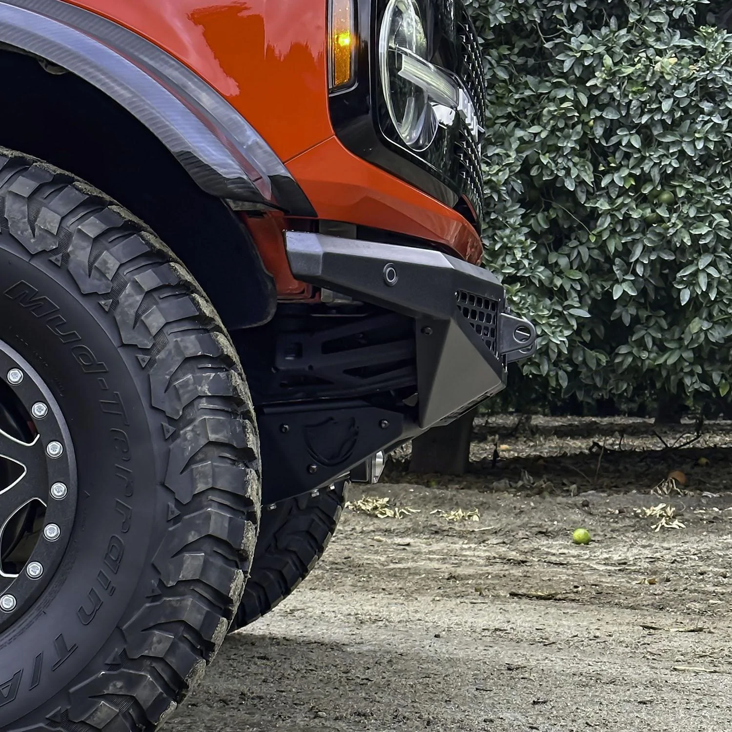

Well it seems like we've been working on this forever but we're happy to finally announce that our HNT Hidden Winch Skid is now available for Broncos with the 2.7L engine! I'm out at Bronco Super Celebration in Buena Vista, Colorado this week debuting it so look for our red 4-Door Wildtrak in the vendor area if you'd like to check it out in person. The kit turned out awesome but its a little differently than what we initially intended so let's get into the details!
Ford Bronco Lobo Off-Road HNT Hidden Winch Skid 2.7L Mount Kit Now Available! image9x-1500sq

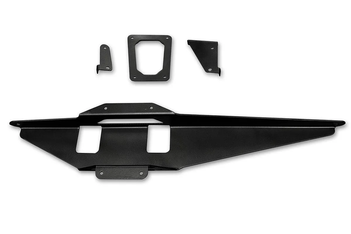

After many different trials and configurations, the final result is simpler than others that are on the market as it requires minimal drilling, trimming and only one water line needs to be shortened. We decided to keep the existing HNT Hidden Winch Skid as-is (but removed the 2.3L-only designation from it), and have designed a separate 2.7 Bracket Kit that is needed when installing it into Broncos with the 2.7L:
Ford Bronco Lobo Off-Road HNT Hidden Winch Skid 2.7L Mount Kit Now Available! F6-17-133B_A-1200w

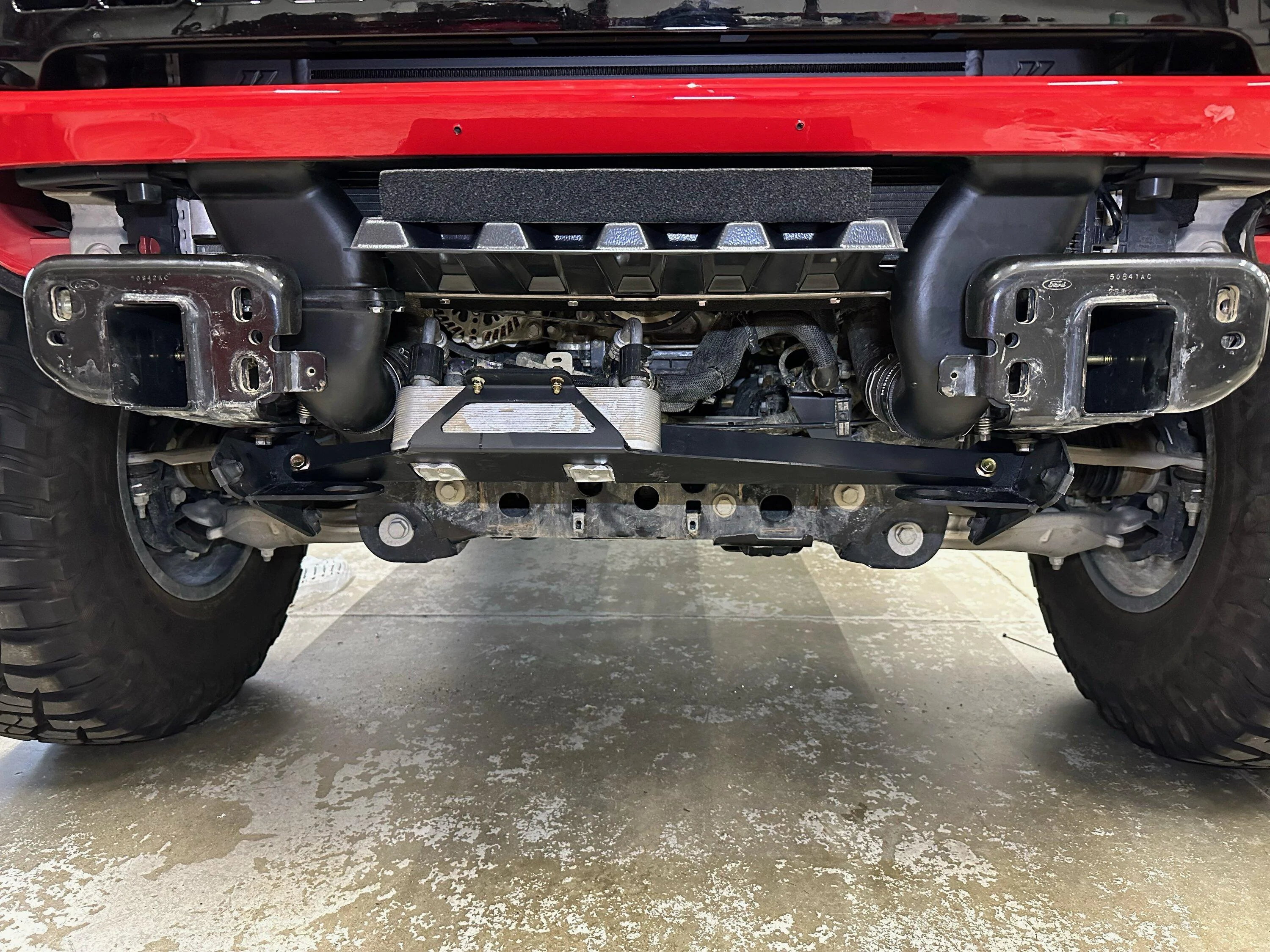

The brackets in the kit reposition the stock transmission fluid heat exchanger, a brake line and a water hose to make room for the winch. Here's a pic of the heat exchanger sitting in the new mount, but please check out the product page on our website for additional photos and a basic run-down of the installation procedure.
Ford Bronco Lobo Off-Road HNT Hidden Winch Skid 2.7L Mount Kit Now Available! image2
You may have noticed the big air ducts inboard of each frame rail in the photo above, which leads me to the last piece of the puzzle. The HNT Skid will require installation of the Mishimoto High-Mount Intercooler to provide adequate room for the winch and repositioned components. Unfortunately that does add significant cost to the installation, but you do get a very nice performance upgrade out of it. And since you've all been waiting patiently, we have a bonus incentive for you to lessen the pain...
