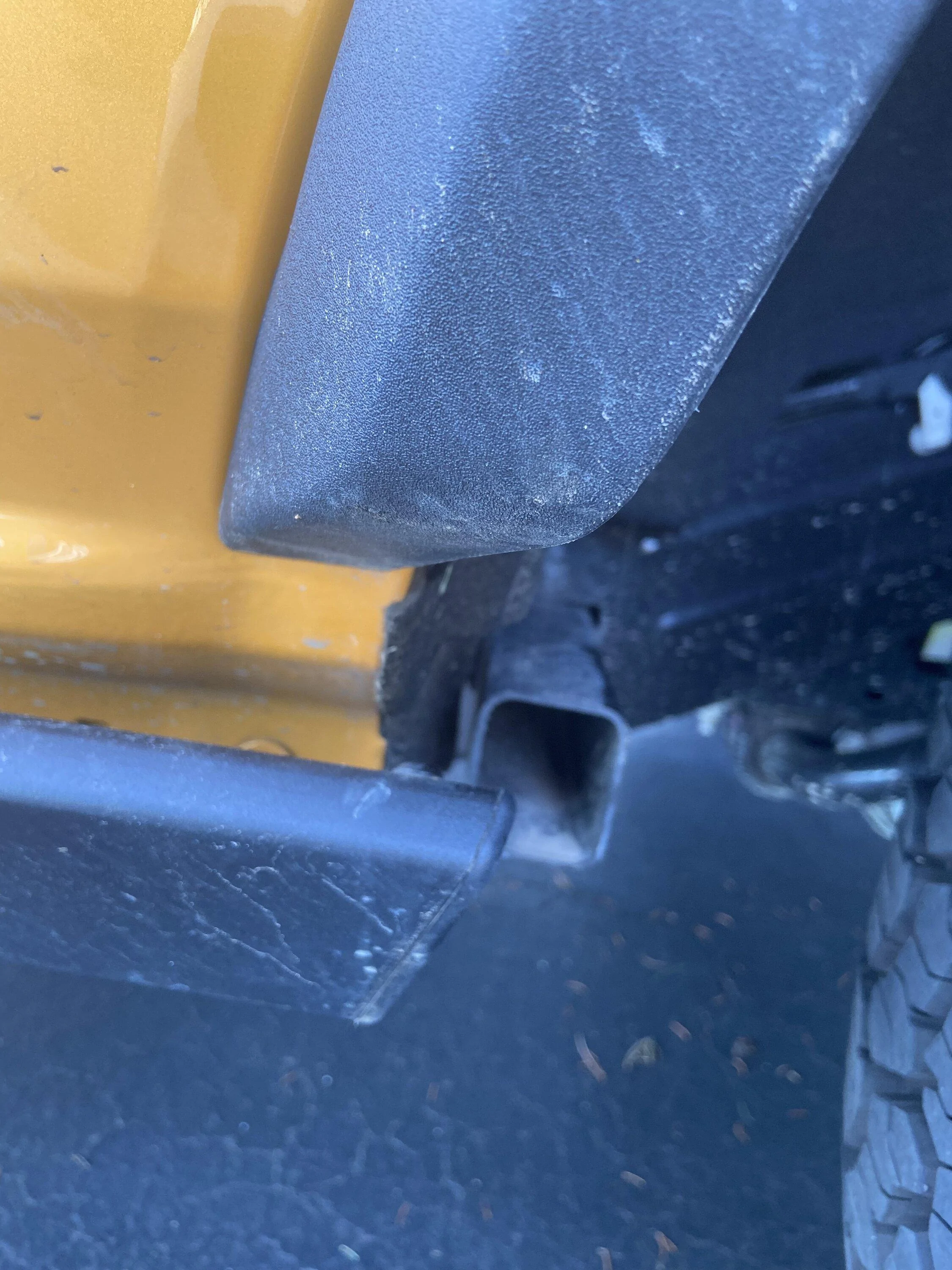

It is completely possible that I did something wrong, but I spent the last two hours trying to get these things on. The ends of the rock rails are angled and this prevents the inner attachment point of mud flap from resting flush with the wheel well. I tried to take a picture of the angled part, but I’m not sure how clear it is from the picture. I suppose that a small notch could be made to allow the portion of the rock rail that is hitting to come through, but I feel like for the price of these, I don’t want to go hacking them up.
Another issue that I ran into is that according to the instructions, the original plastic screw thing should be put back into this inner attachment point. This screw would likely be ripped out by heavy snow/mud or if the mud flap made contact with just about anything while driving. I thought that maybe I misunderstood the instructions. The hole used for this attachment point does not appear to be threaded. I tried putting the screws that came with the flaps into the hole and they just pulled right out.
Even if they did fit around the rock rail, I would probably be hesitant to install these until that attachment point was a bit more secure.

I watched the video several times and read the instructions. I could not get these things to sit flat. If the rock rails were straight, then they would fit perfectly. I am not sure if there are different rock rails out there and nobody noticed yet, but I couldn’t figure it out.

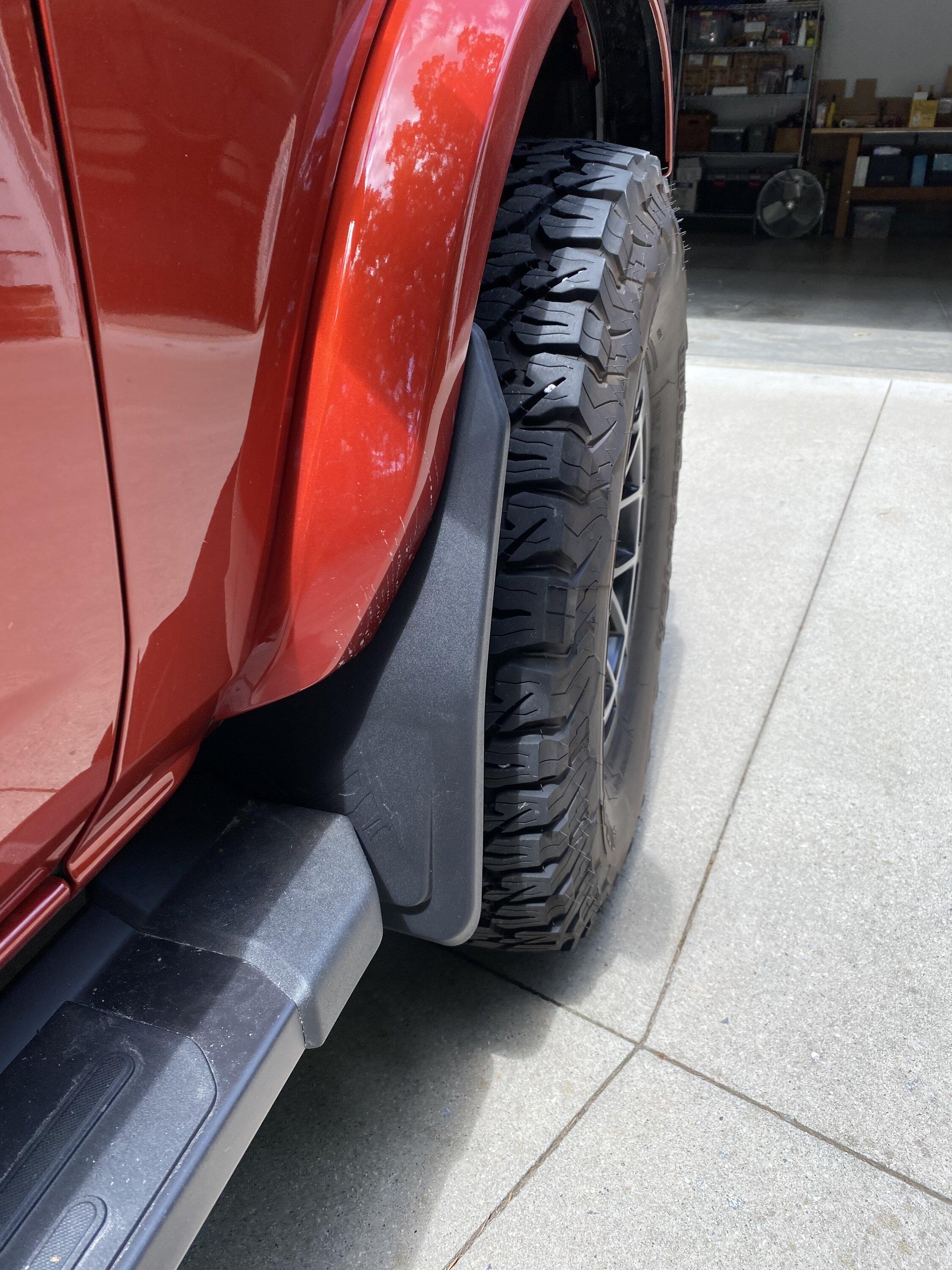

Ford Bronco Mabett Mud Flaps 421508FB-DAD7-4204-8BEE-90C6253287F2
You could cut the rock rails too.
406g
Aug 4, 2021
156
Montana
2022 Ford Bronco
Mine fit with the factory rock rails on my badlands, but I do agree I am slightly worried about the plastic screw surviving winter/off road.

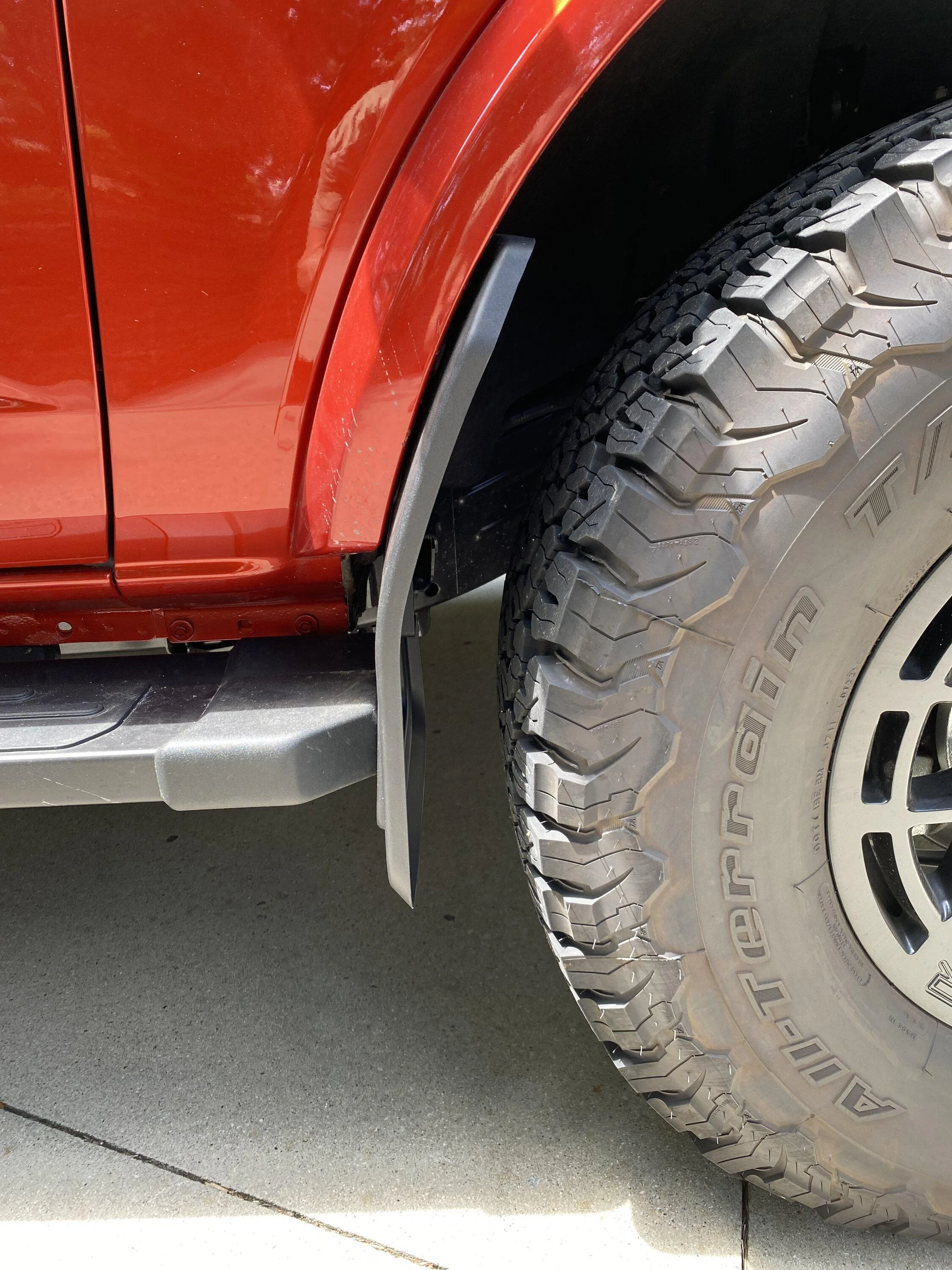

Ford Bronco Mabett Mud Flaps 599FA3A0-9D70-40BB-8CD0-25F04EFC837F
Hey, I just tried to install the front mud flaps and it's not working! The third point of attachment, where you use the original plastic fastener near the crash bar, did yours work correctly? Unfortunately, when I mount the flap to the steel mounting bracket, the third hole near the crash bar doesn't line up, so I have to flex it over and back to press against the felt wheel liner and the plastic fastener wouldn't grip. So I mounted the plastic fastener neat the crash bar first, then after flexing the flap and the steel mounting bracket, I got the holes to line up! After I tightened the two steel mounting bracket screws, the plastic fastener popped out! Am I doing something wrong? Even if I get the plastic fastener to catch, I can't believe that that will last through the winter!

This was pretty much the exact problem that I was having. The tension on that inner attachment site would not allow that plastic screw to hold. I tried coming in at different angles. I tried using the different bolts in different holes. I tried pretty much everything that I could think of. In my case it seemed like the rock rail was pushing on the flap, but now that I think about it, maybe it was more the crash bar causing the problem.
I am not big into cutting products that I just bought.
