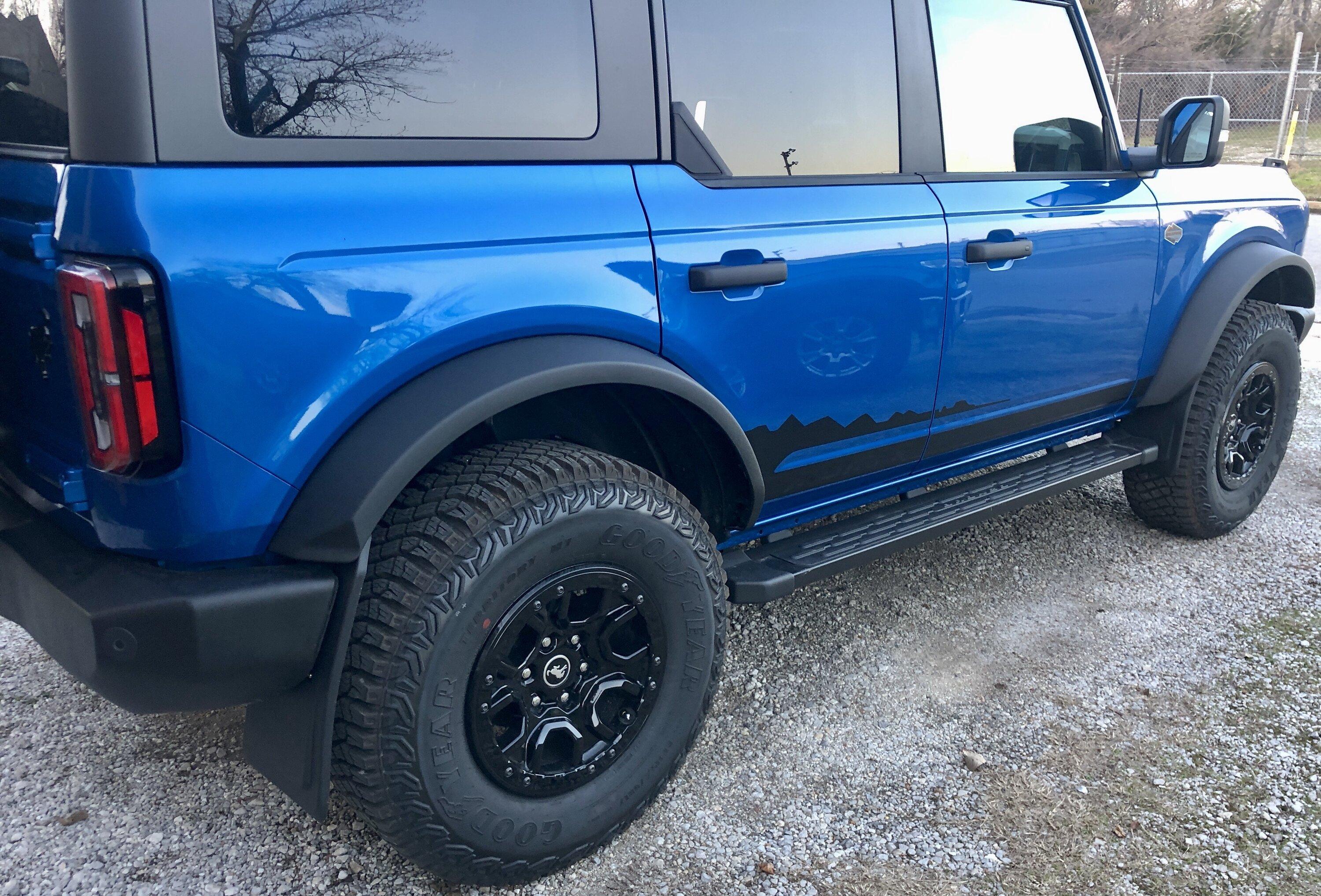

Ford Bronco Mabett Mud Flaps IMG_2414
Ford Bronco Mabett Mud Flaps IMG_2418
I was able to get mine secured by pushing on the fender while I used a long handled screw drive to reach and turn that last clip
I was able to get mine on my 23 Wildtrak easy enough

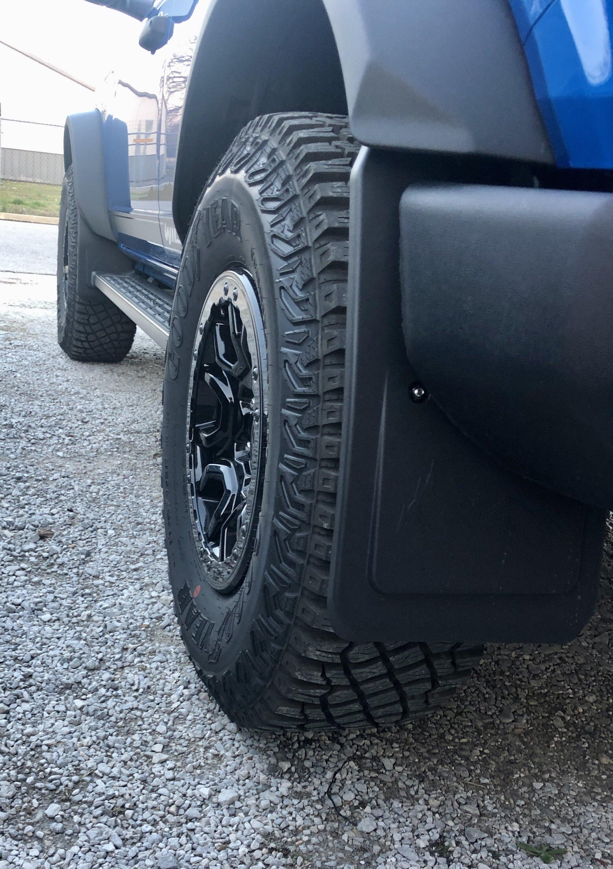

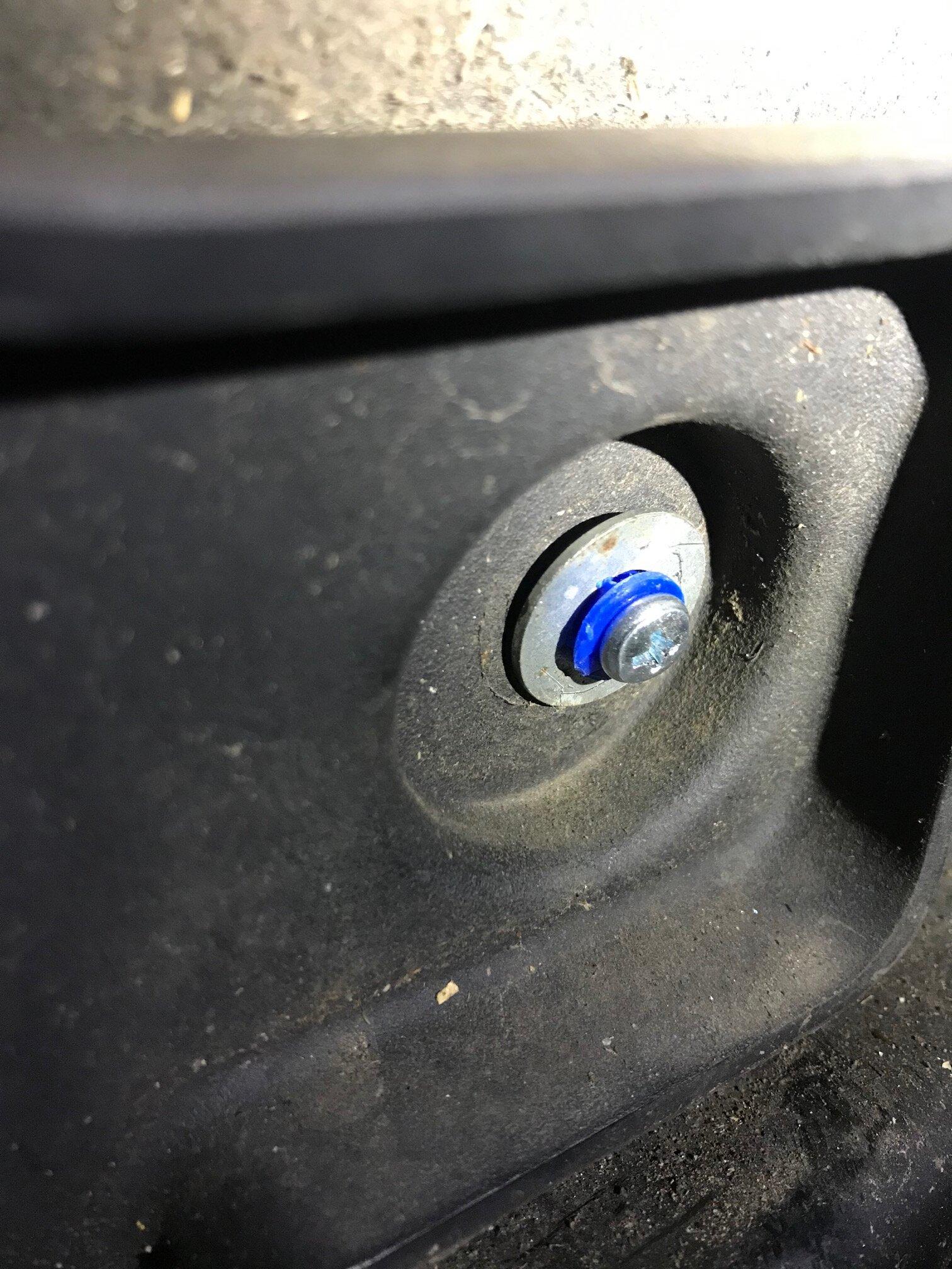

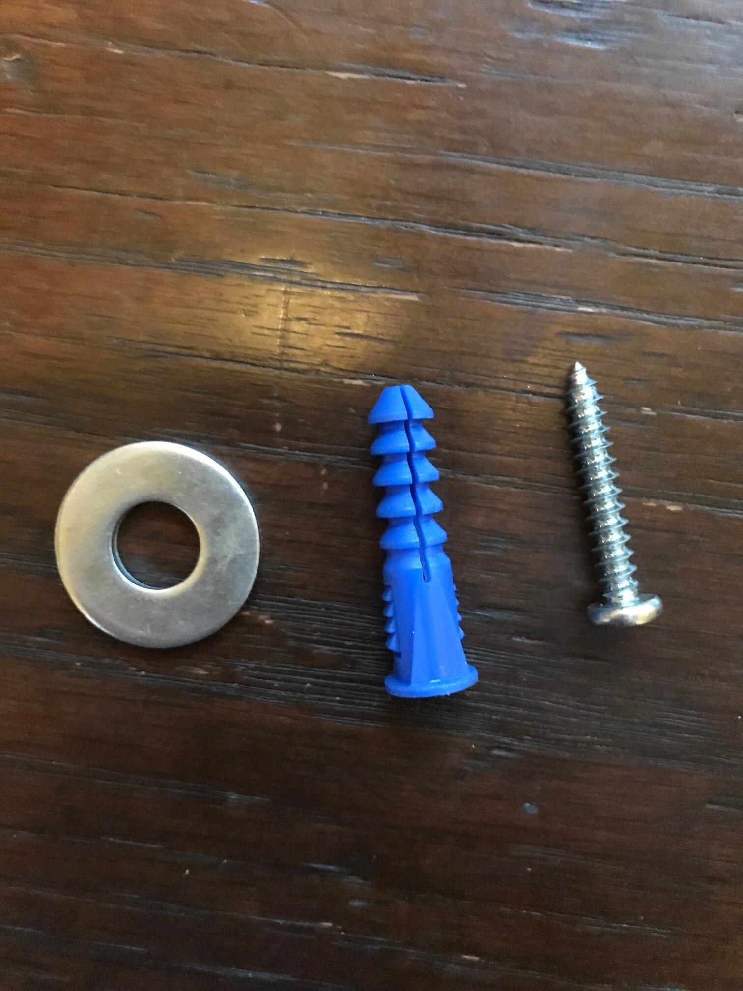

I’m having the same issue with the 3rd screw. I have the crash bars and the running boards which makes it hard to line them up. Even once I get them lined up I can’t get the screw rivets to hold well enough to leave them. I found some slightly longer metal screws that are holding the rivet on for now, but I don’t think it will hold. Did anyone come up with a better solution?
I tried a larger push pin from the auto store. It still seemed flimsy, but held for several months. I just checked and it had popped out on one side.
I just tried this plastic anchor screw which was the same size as the 3rd screw hole. It seems to be holding very tight.

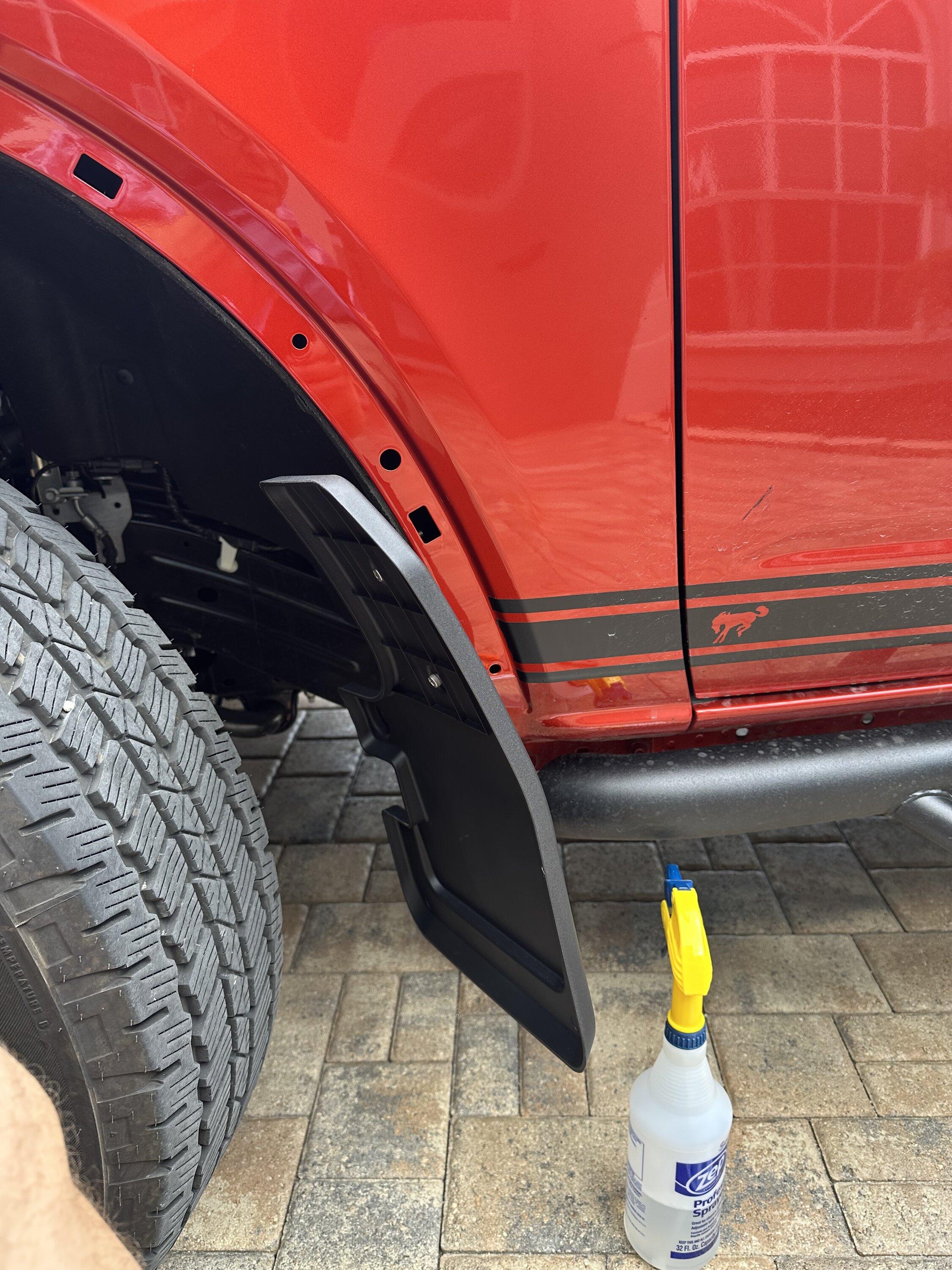

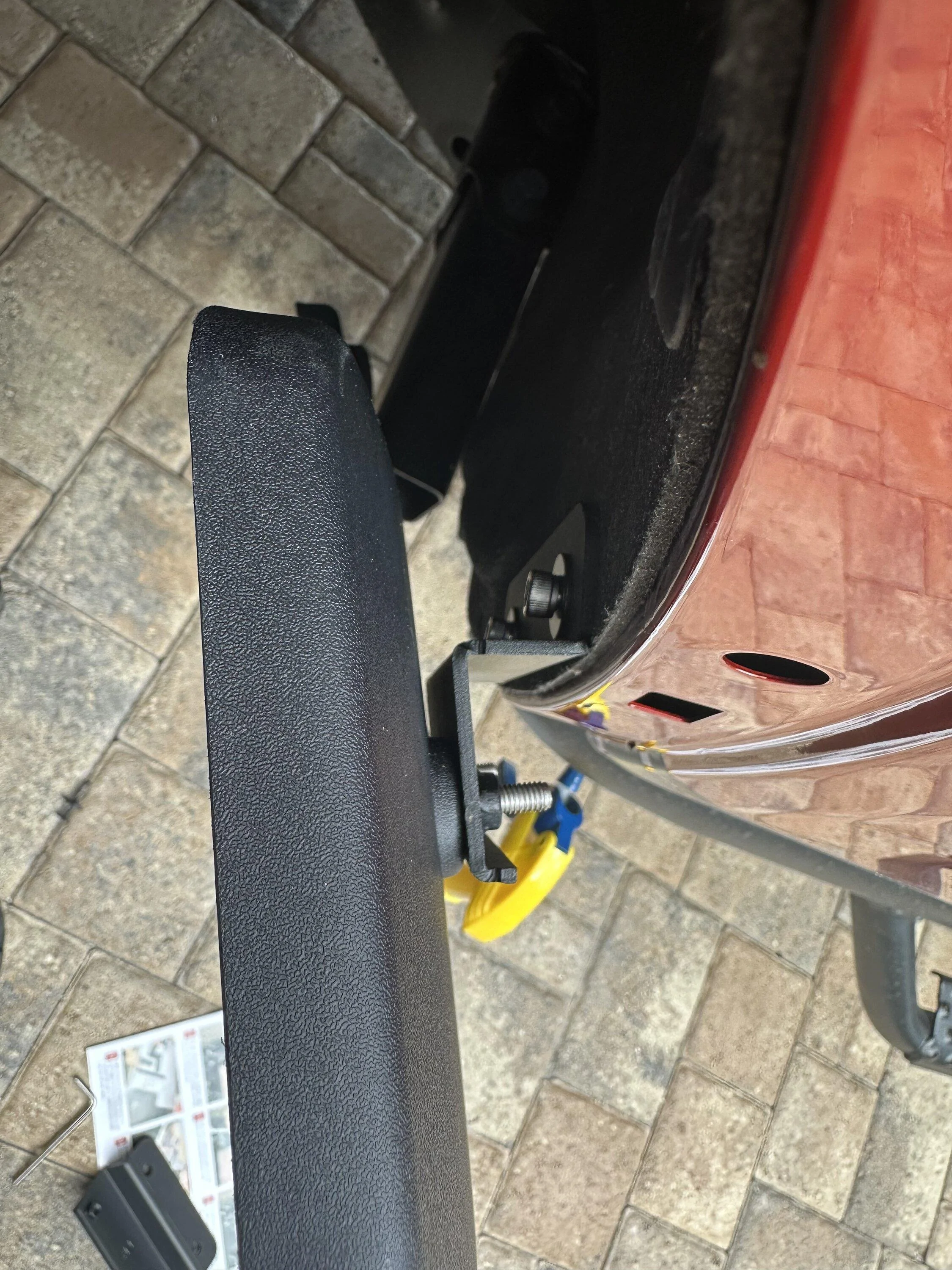

SO after much frustration on what flaps to buy, I added the Ford to the rear for simplicity and decided on the Mabett for the front. I HAD NOT SEEN THIS THREAD. So I tried to install and also found the angle at which the bracket holds the flap does indeed cause the flap to sit crooked. The last clip is not long or robust enough to stay in place. I also felt the install should have had a slip nut and bolt for the last hole. They dont, and after reading all the comments, I decided to keep looking for flaps. I wasn't really thrilled about them during the install and simply won't put them on my Bronco.
