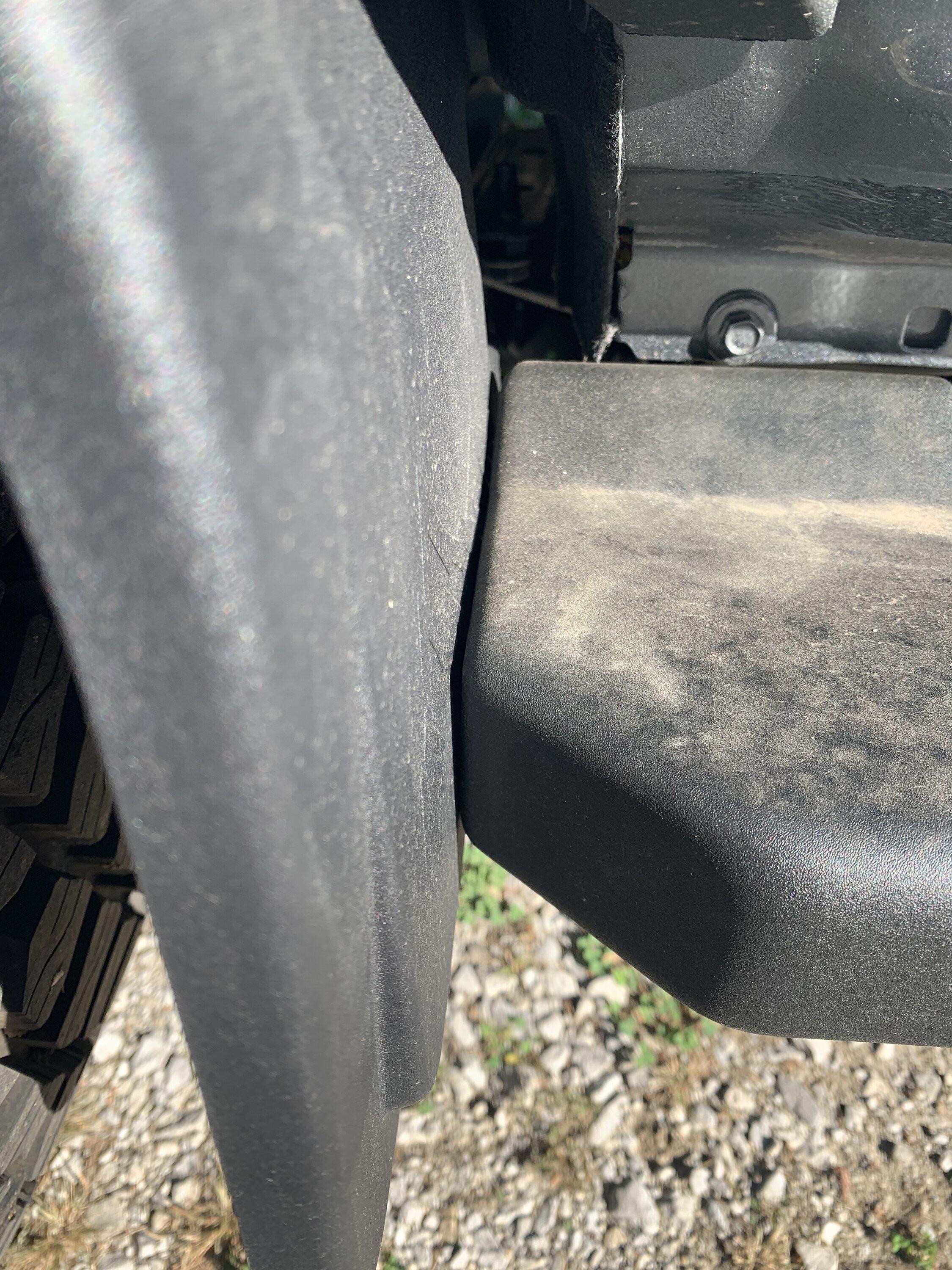

Got the Mabett flaps on the prime day sale and I tried installing them today...
I have a WT with factory tube steps. The flap pushes against the step, and if I fully screw the 2 "good" screws on the bracket, the flap twists and the plastic screw comes out (screw and clip).
On Amazon it says they are compatible with the tube steps, so I wonder if I am doing something wrong. The flap has a cut out that "appears" to fit the tube step, but it must be for something else since it doesn't get anywhere the step...

Here is the flap with the screws very loose, but you can see how it is already pushing against the step:
Ford Bronco Mabett Mud Flaps fla

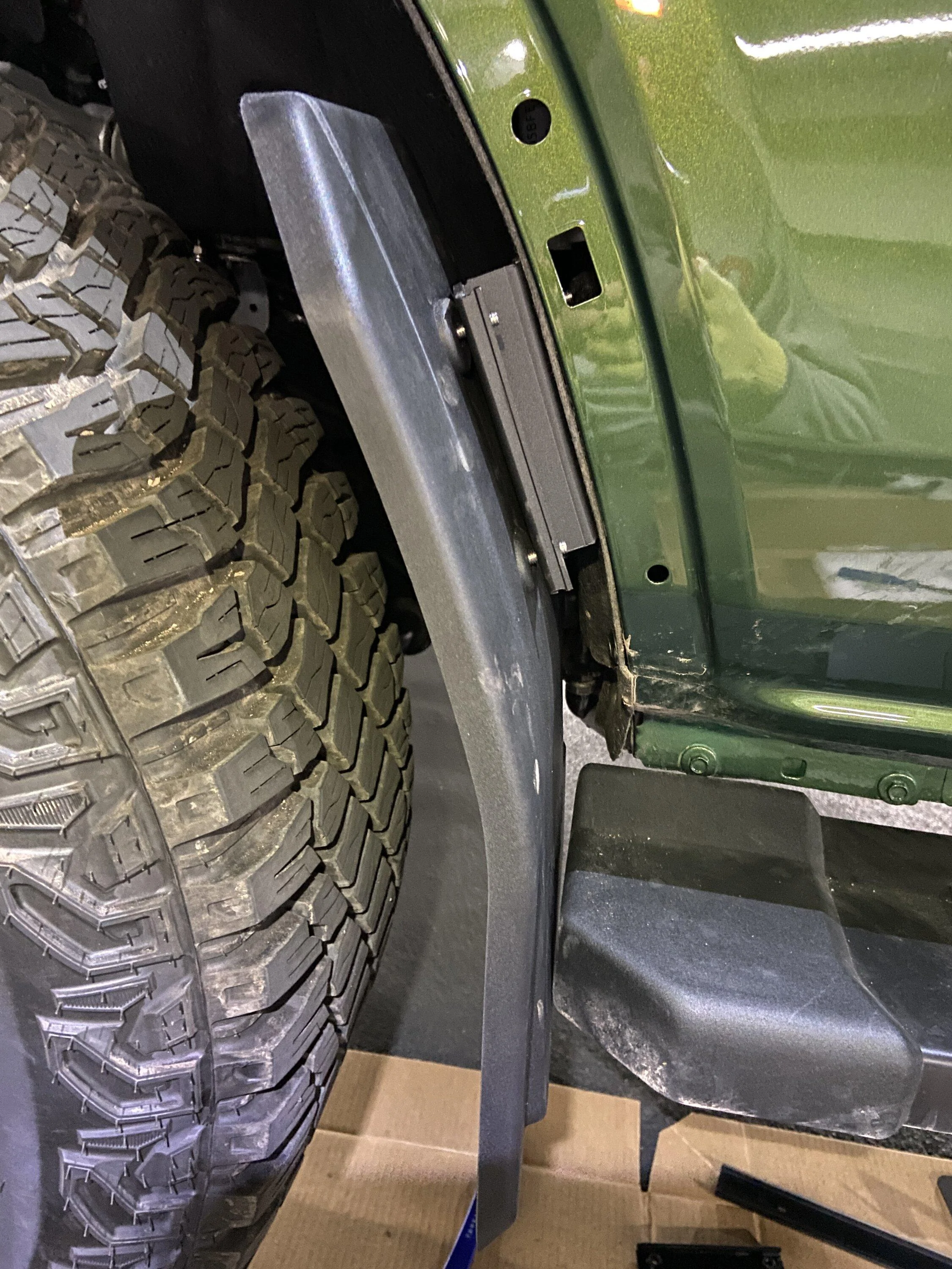

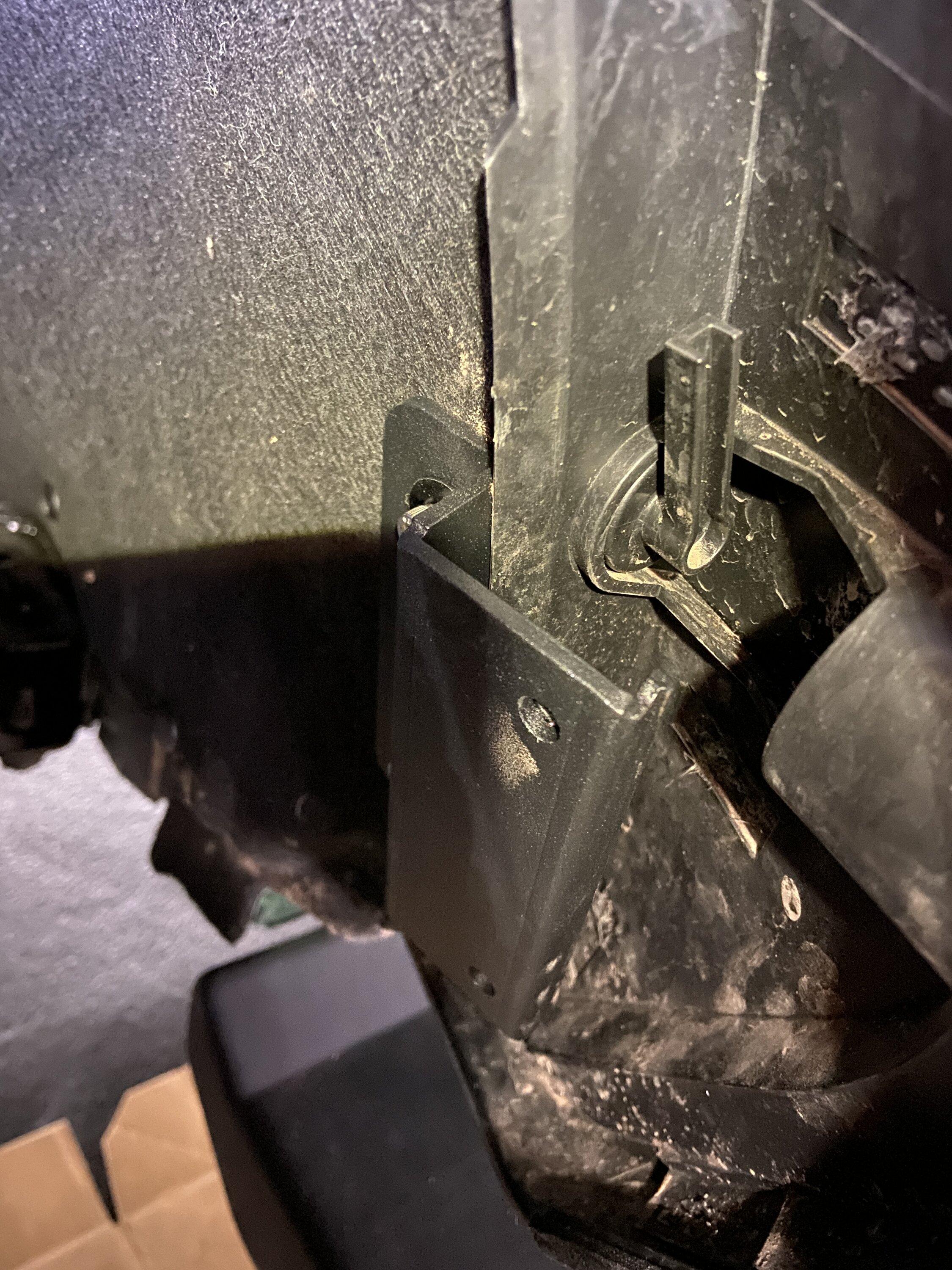

And that may not be a big deal, but I felt the backet was pushing the fender out:
Ford Bronco Mabett Mud Flaps bracket

I didn’t notice the bracket affecting the fender flare. I’ll have to look at mine when I get home. Once I I started threading the mabett screws, I pushed hard on the plastic pop rivet to get it in place and hold. The insert goes on the outside of the flap and then through the hole on the body. Then I tightened the Mabett screws and it was straight. I’m pretty sure mine touches the ford tube step but it was acceptable to me. I think the cut-out you are talking about is to accommodate the crash bars, which we don’t have on the Wildtrak.

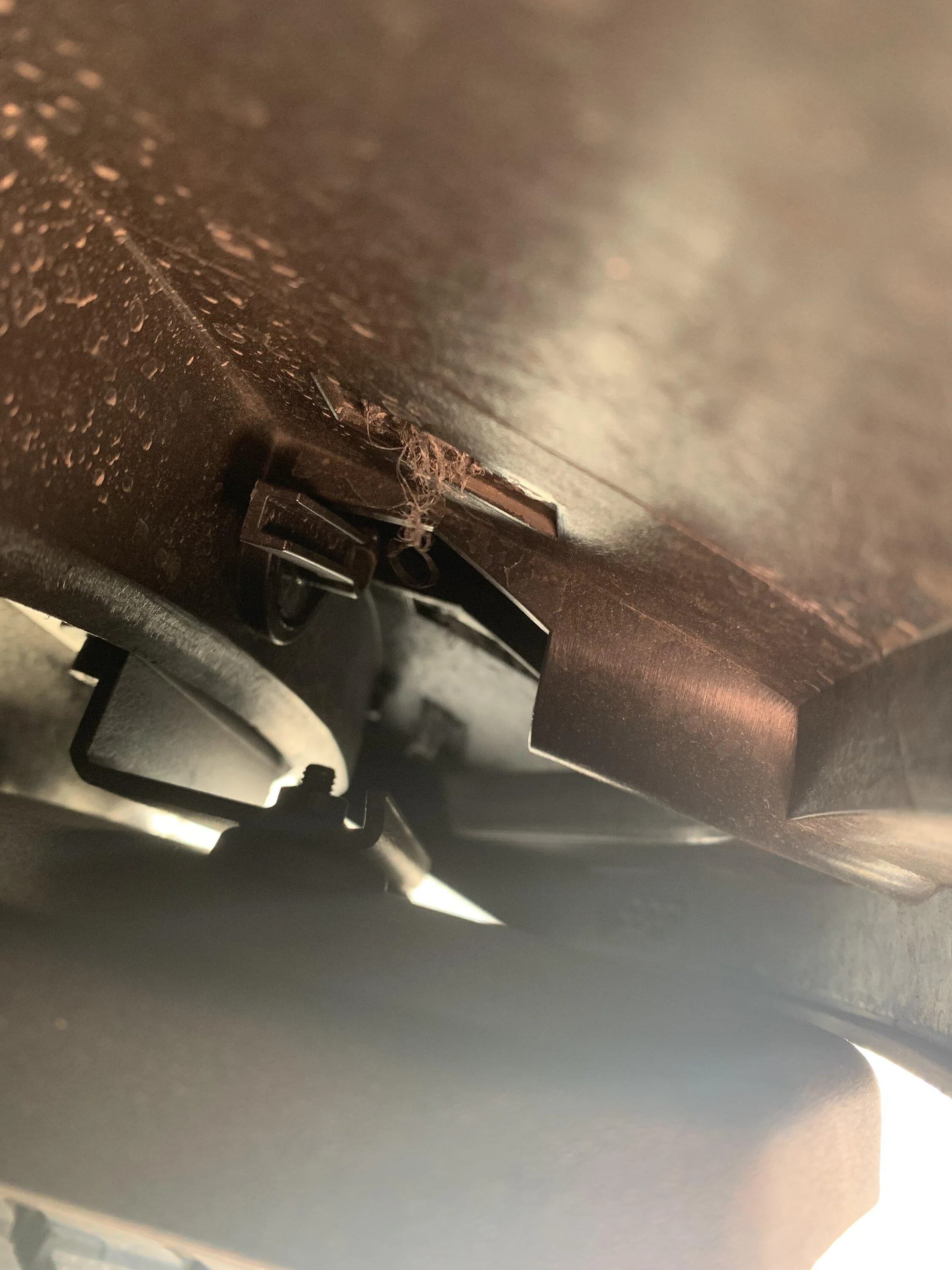

I have a set to put on today to replace the weather tech ones I have which are horrible. Any of the plastic fasteners that ford put on there are horrible. If you know the process to get them installed they will hold roughly. You have to remove the threaded center part completely. The you have to push the female end into the hole and press very hard as you start to thread the stud into the other side. Its a pain in the ass but it can hold well. The other issue if you do not press hard enough , the screw will expand the plastic on the wrong side of the metal and it will just fall out over time.
SOLUTION.
Go to your local automotive store , buy the same kind of metal slip on clips and the appropriate bolt like they give you for the kit and use that in place of the other. Then it will never go anywhere. Also , I noticed in my kit , something different than what I see people getting in kits on you tube videos. So the older kits I'm seeing came with blackened hardware ( screws and nuts ) which shows less but it also is more prone to oxidation (rusting). When I got my kit today , it was actually all stainless steel bolts and nuts. I was pleasantly surprised. I go to the outer banks frequently in the summer , so I'm thankful of anything stainless or aluminum.

Ok so heres the definitive solution , I put my front ones on today. I have a host of assorted plastic automotive push pins for different things. This push pin will work better than any of the ones installed by default. Its a very snug fit and holds very well. The problem with the spot is there is no way to get behind it but this works exceptionable.
Amazon.com: 25 Splash Shield/Fascia Clips Compatible with Ford N802781-S and GM 14093088 : Automotive

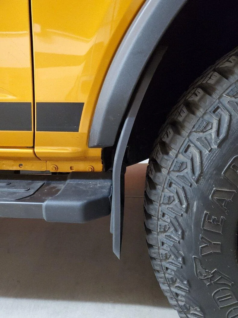

I just finished installing the front ones on my WT with the Tube Steps. After attaching the Mabett bracket to the fender you may need to 'flex' it a bit to get it to line up with the rest of the wheel well. I think the tab it's mounted to is bent a little outwards. If you push on the outer side of the bracket (after it is mounted) towards the tire then when you attach the mud flap the third hole will line up perfectly and the original plastic push pin will fit and hold.
Ford Bronco Mabett Mud Flaps 20221119_154845

Basically what I did. But about 2-3 weeks ago the plastic pin popped out. So it only lasted about 8 weeks.
