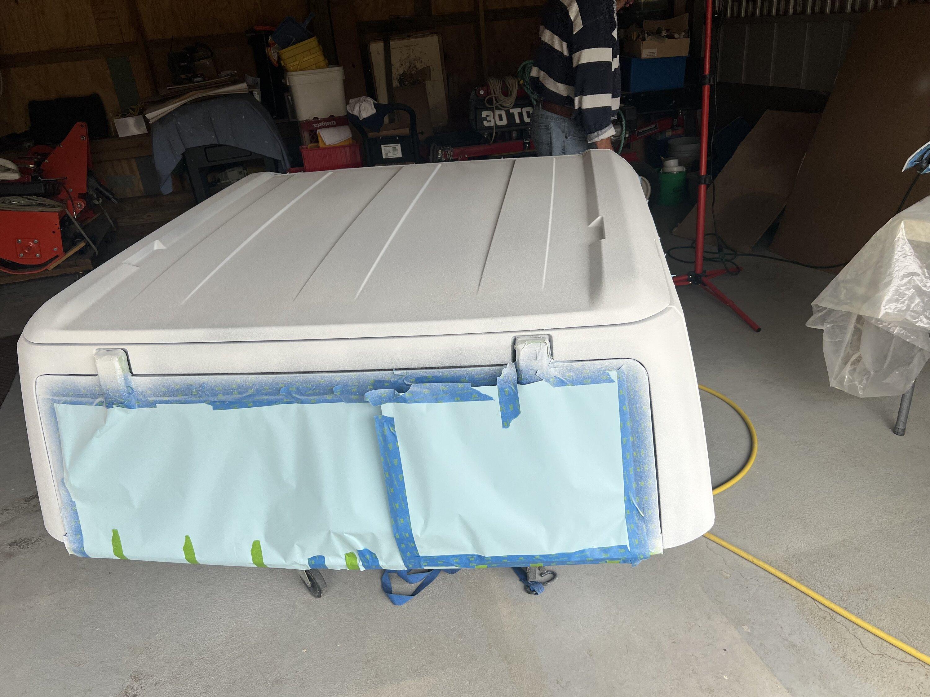

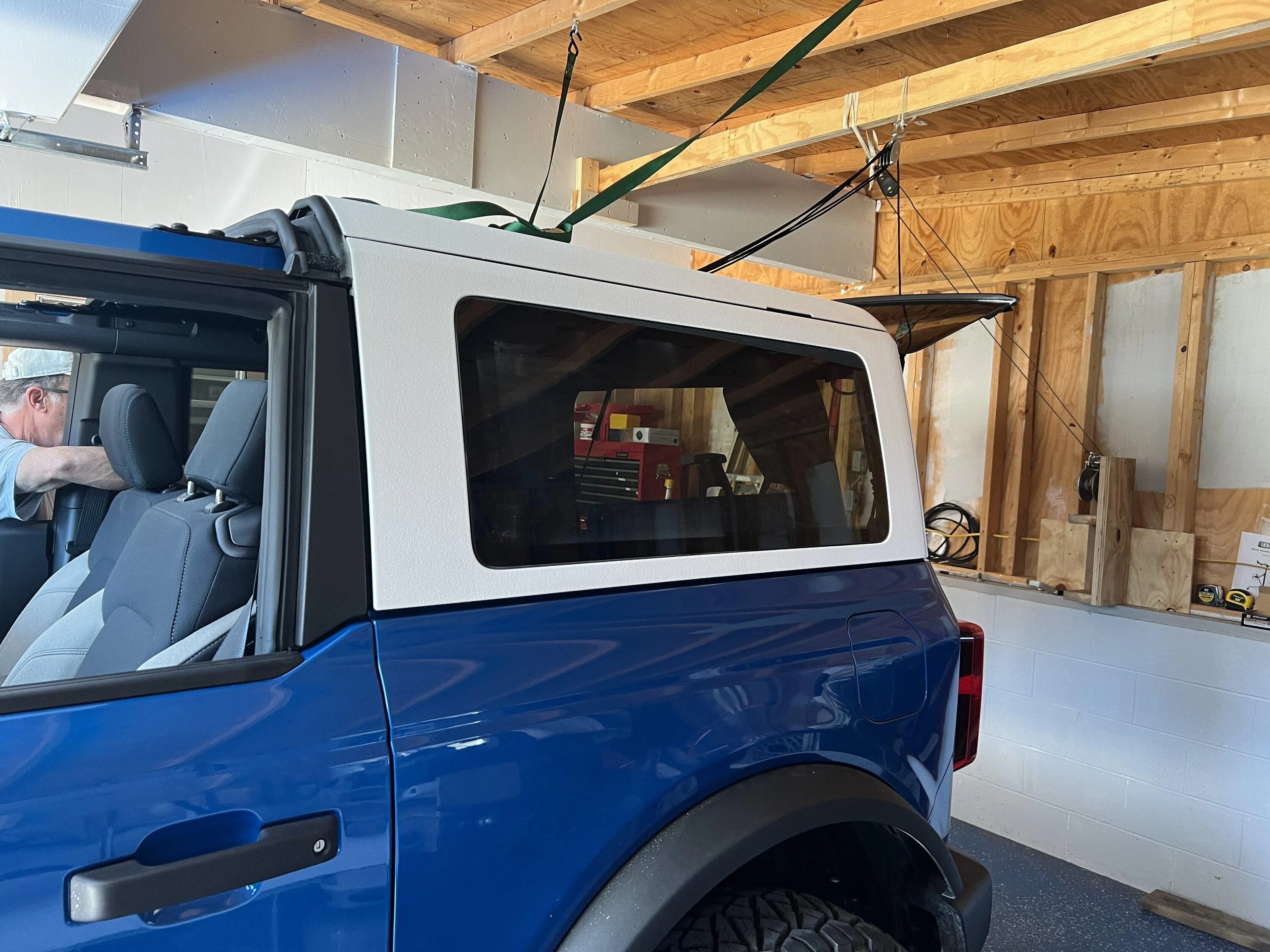

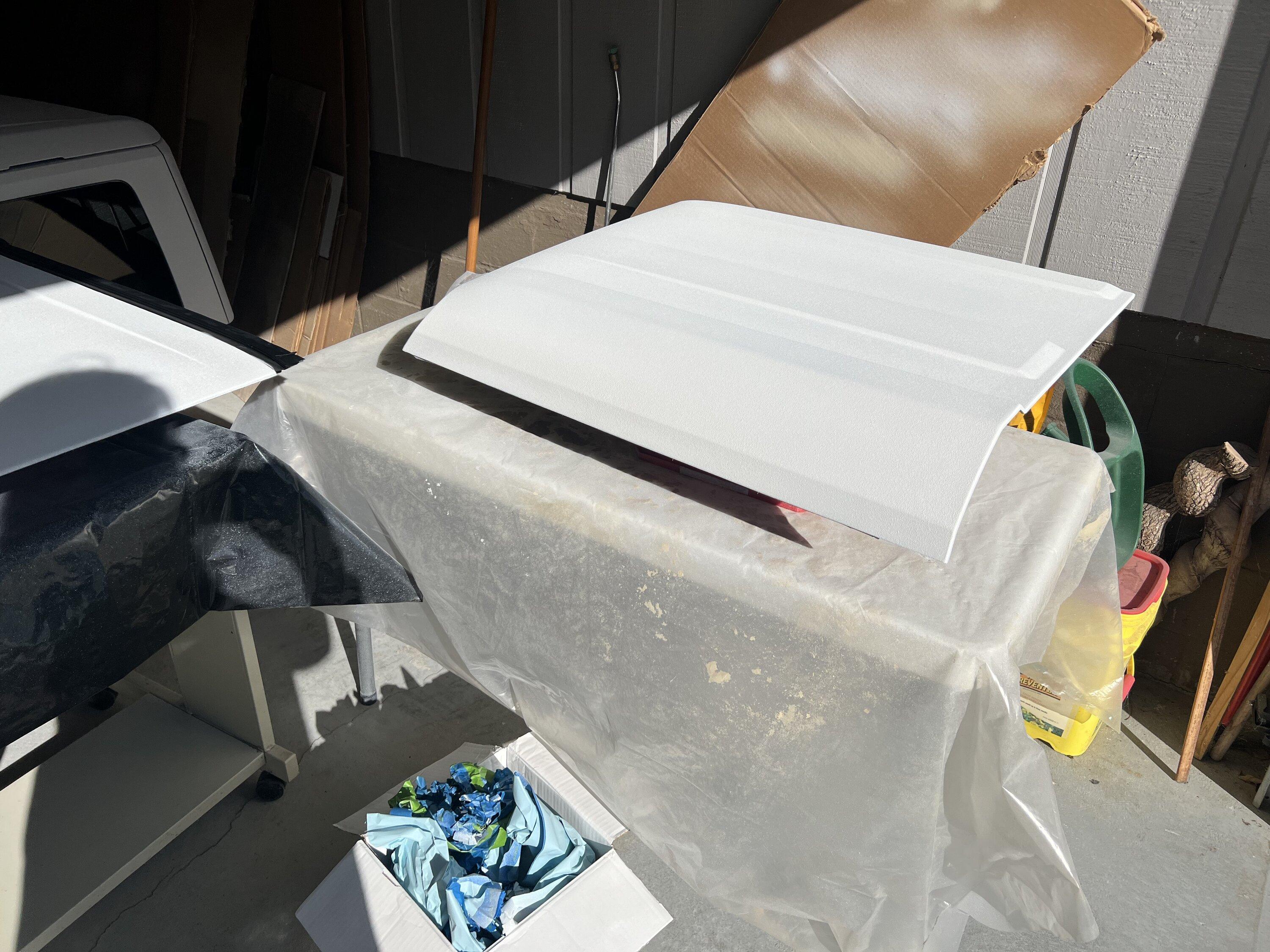

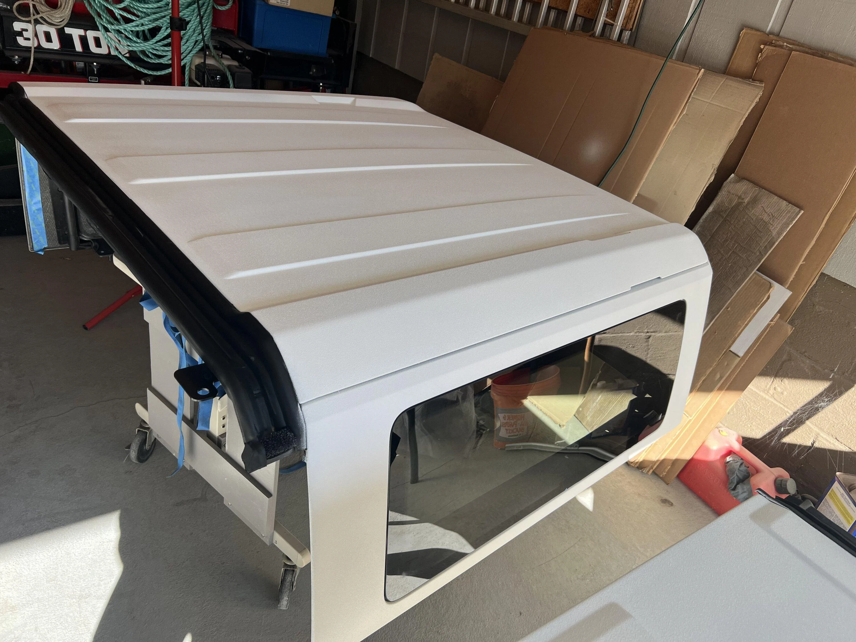

I wanted to get a Retro Look, and Line-X wanted $750.00 to do the top and hatches. I had read a lot about Raptor Liner (I have no connection with the Company) and decided to give it a try. I used my Kubota RTV to try out the spraying of the liner and had real good luck with it. So I gave the top a shot at it.
Once the top was off I washed it twice with car wash, and then did a third wash with Dawn Dish Soap. When it was dry, I went over all of the surface with 220 grit sand paper, and then wiped it down twice using Lacquer thinner. After that was dry, I went over everything with a tack cloth to remove any dust or small particles that I missed.
I then used Adhesion Promoter over all of the surface and let sit for 20 minutes, and during that time I mixed up the Raptor liner. If you do this project, keep in mind that the Blue Painters Tape and Green Frog Tape do not stick well to the seals. I had a little overspray where the tape did not stick.

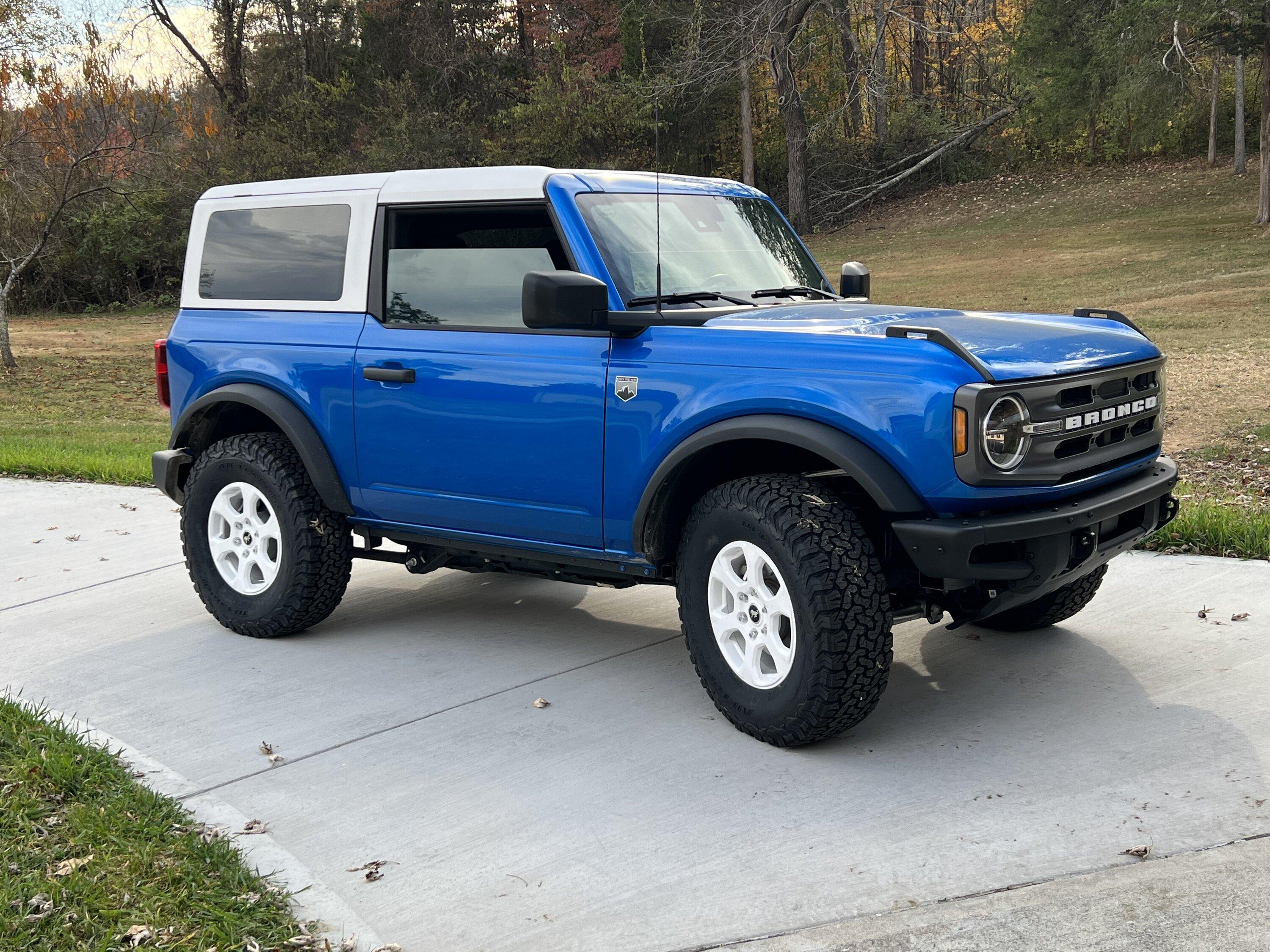

My final part of the Retro Build was having the Factory Big Bend wheels powder coated white. The Tires are BFG-K02's size 285-75-17. No rubbing during turns and the Crash Bars are still in.
Nothing special about my equipment. I have a 30 gallon Dewalt compressor, and used the Adjustable sprayer that Upol sells. The adjustable sprayer gives you the option to have a heavy or fine finish. BJ.

Did you remove the rear lift-gate hinges before spraying, or did you just tap around them?
Also, did you stop the Raptor liner at the edge of panels, or continue the liner under the "lip" of the panels? I would love to see pics of the "edges" of the panels.
FWIW, I've used Raptor liner before and am a fan, but never in situations that need precision fit.
thanks,
Herb

351W: Herb, I tried to get the Blue tape below the edge, and then as I was spraying I overlapped the edge of it. I did not remove the lift gate hinges, but just taped and sprayed around them. I will try to get some pictures if the edge tomorrow weather permitting. Thanks, BJ.
