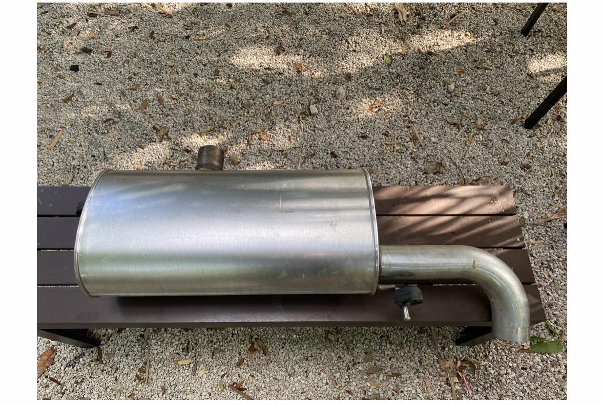

I decided to upgrade factory exhaust to Corsa dual tip for my 2.7L. During installation, the Corsa passenger side tailpipe exit hanger would not line up with the exhaust hanger/grommet on rear bumper mounted by Ford. It was about 2 inches off. After some research, it seems ford mounts the exhaust hanger on the rear bumper according to your engine (2.3L or 2.7L), and the corresponding exhaust for your engine….IE the factory muffler hanger closest to tailpipe exit is flipped for 2.3L engines and 2.7L engines.
I then looked back at the factory muffler removed from my vehicle and the part number (MB30-5K214-AEH). Matches 2.3L?

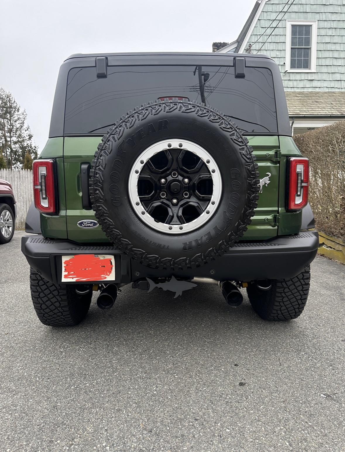

The Corsa is on and sounds great

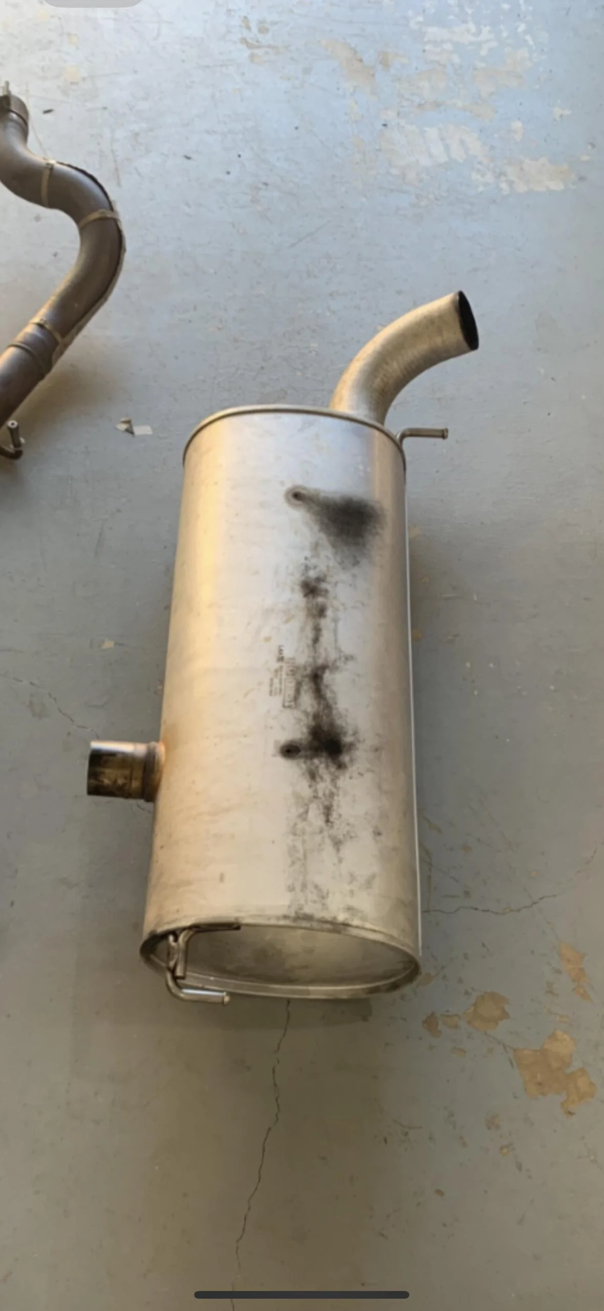

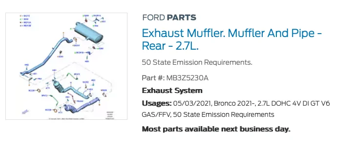

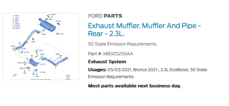

Here’s two pictures of OEM mufflers from ford for 2.7L and 2.3L. It appears the 2.3L muffler is not as wide but has a longer tailpipe. 2.7L has wider muffler/resonance chamber and shorter exit pipe. See how the hangers located closest to tailpipe exit are in different spots?
