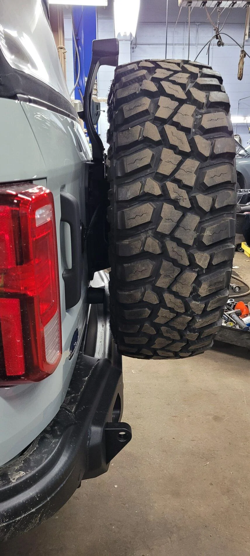

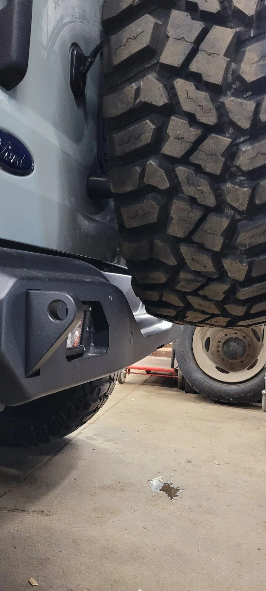

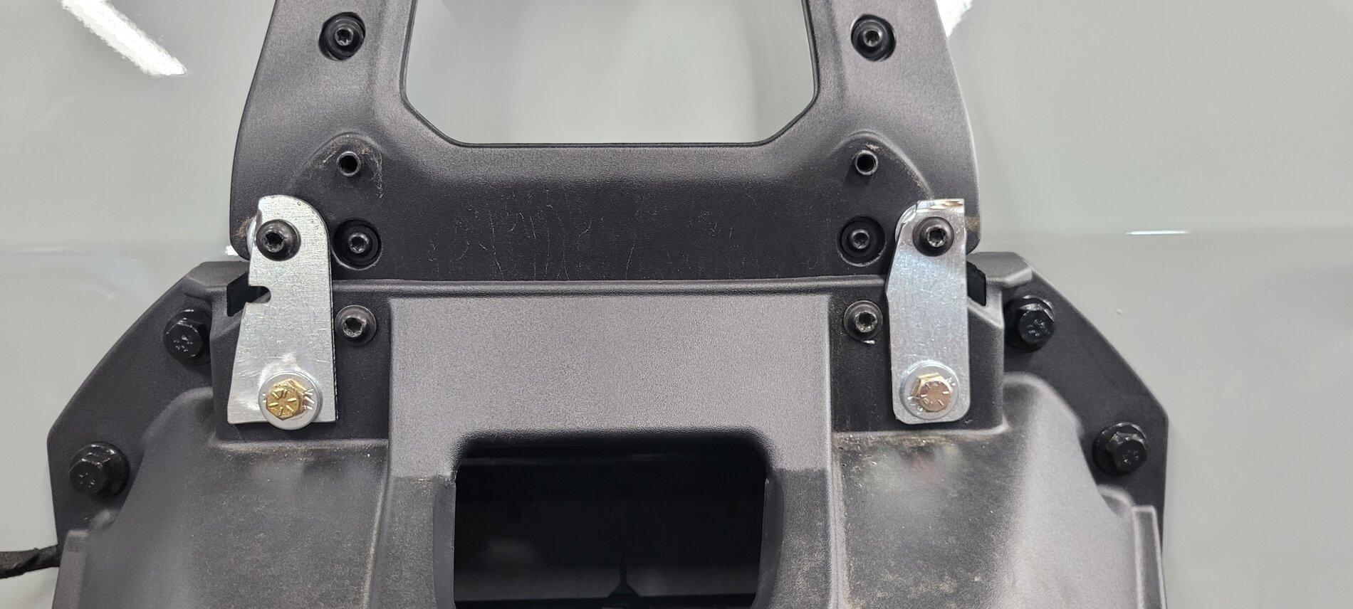

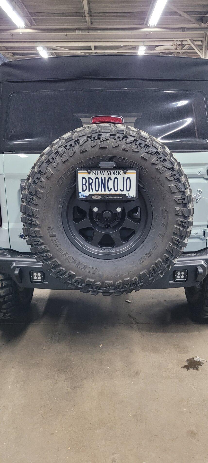

Mounted spare on stock carrier. Moved third brake up without buying any bracket. There is another set of holes below factory spot (my guess bracket sasquatch wheel), then just made support brackets out of what I had. Sturdy and visible. Need longer rubber supports. Vanity plates finally came in also
Edit: sas wheel weighs 82lbs. My factory specs equal to 107. Haven't physically weighed it yet

Do you think this will clear on the lower part on the stock bumper with out the relocate?

I don't think so. I think town and country test fitted on one of their YouTube videos and it was touching
