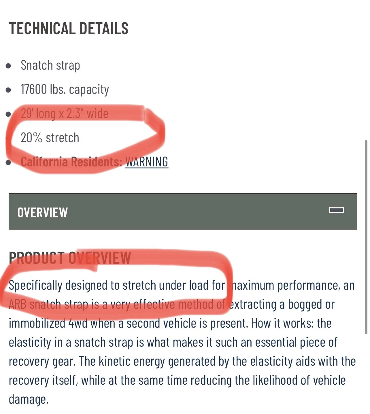

Maybe this is just nomenclature, but what I've read is that a snatch strap is flexible/dynamic vs a tow strap is static. Below is an ARB snatch strap that I was considering. Kinetic rope is a term that I just learned today. It seems like the same concept but they do look different:

Ford Bronco Need Kinetic Recovery Rope 82DCE44A-DD85-4F64-8C0A-19DDDD34DCF0
Yea, nomenclature, I've referred to tow straps and snatch straps as synonymous for a long time... apparently incorrectly lol oops
Yes, a kinetic/recovery rope and kinetic/snatch/recovery strap are the same concept but a rope has more stretch, is more durable, and is field repairable.
A tow rope or tow strap has a little stretch to make the initial pull less jarring, but are basically static for towing.
