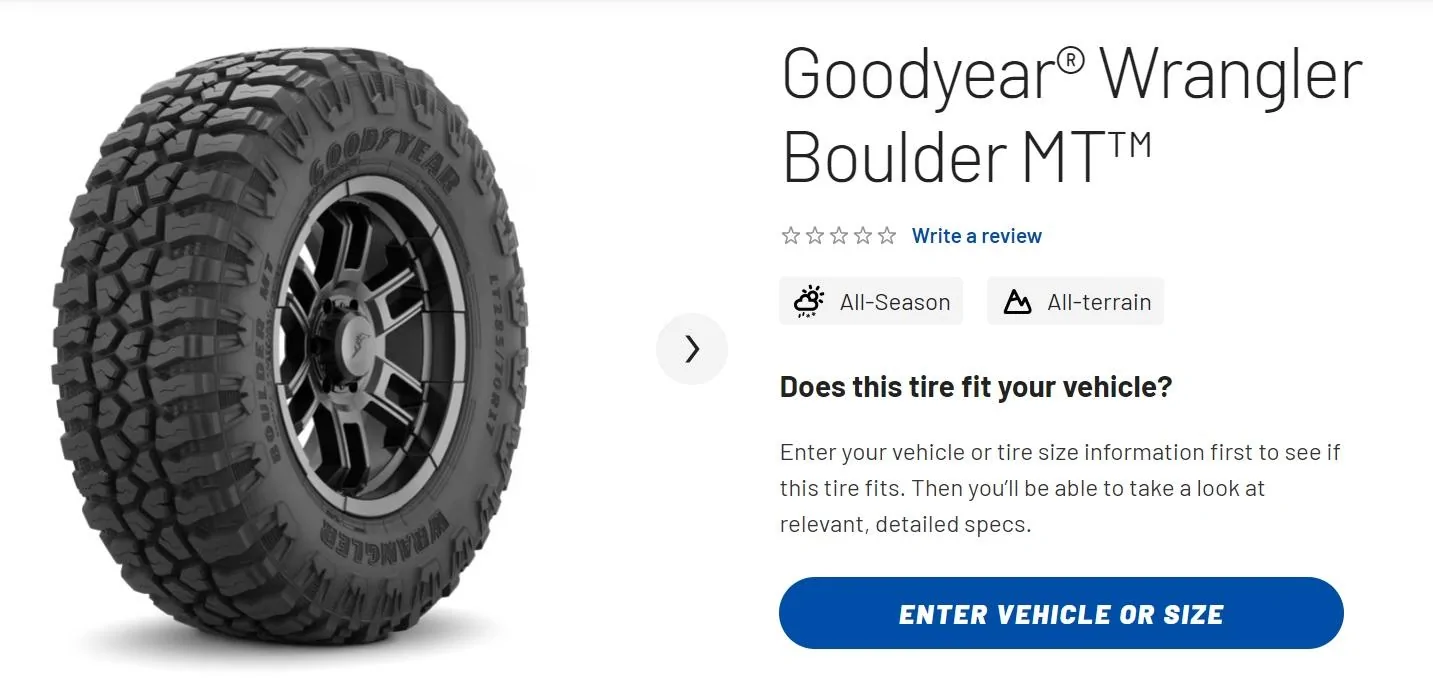

But....are you really going to put a set of "Wrangler" tires on your Bronco??

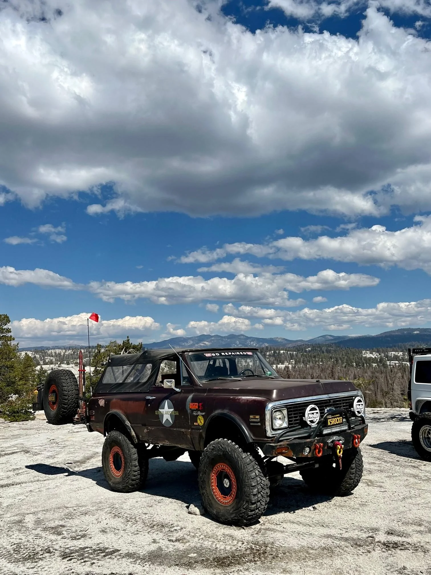

Well, I run 40-13.50-17 LR C Wrangler MT/Rs on my 72 Blazer so...Yeah, I would, lol.

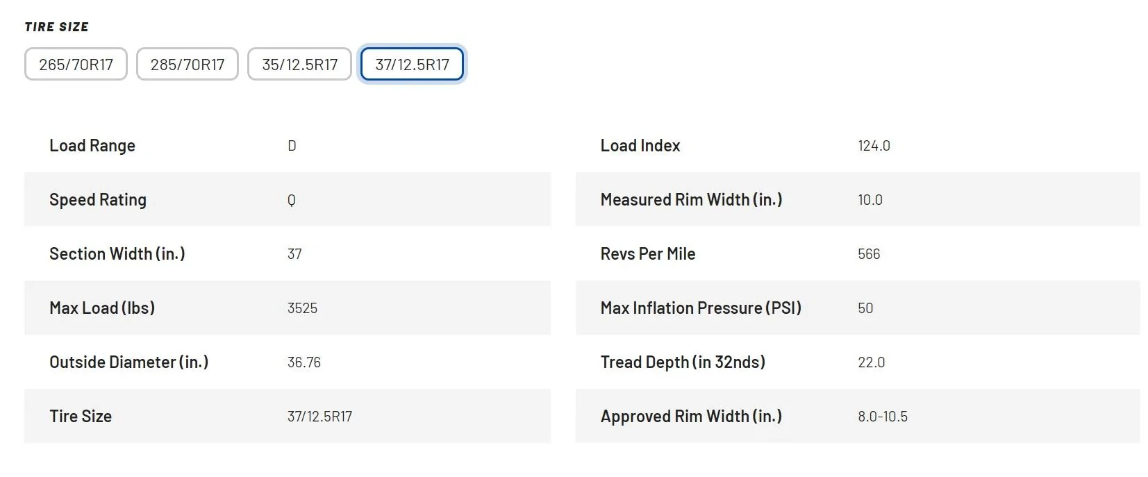

I agree with that but if a tire is made for "extreme offroad situations" it shouldn't be C rated. These should be built with stiff and heavy ply sidewalls to withstand offroading.
You do realize that the load rating does not equate to the sidewalls strength off road, right? They are stronger, but stronger to take a higher pressure without deforming and subsequently generate less heat at load and speed. Buying load range D or E tires over a C does not automatically give you a tougher sidewall in the rocks. But, it sure will give you a shitty ride quality, even when aired down. One of the toughest radial sidewalls, the 40" Nitto Trail Grappler, comes only in a simple C rated sidewall, and that tire was quite literally designed for KOH.

Apart from the BFG KO2, And perhaps a Milestar Patagonia, Please list up the 37-12.50-R17 Load Range C offerings, from all of those others.

I’ve aired down in the desert SW in the rocks for 16 years on various C load rated General Grabbers, on a heavy JKUR, and never had a sidewall issue. At least for me, the trade off for what I may lose Offroad is well worth the on road comfort of a C rated tire whenever possible.

My bad @Rwhite692 I overlooked the C rating requirement, there's a lot of D rated tires that size but not C.
