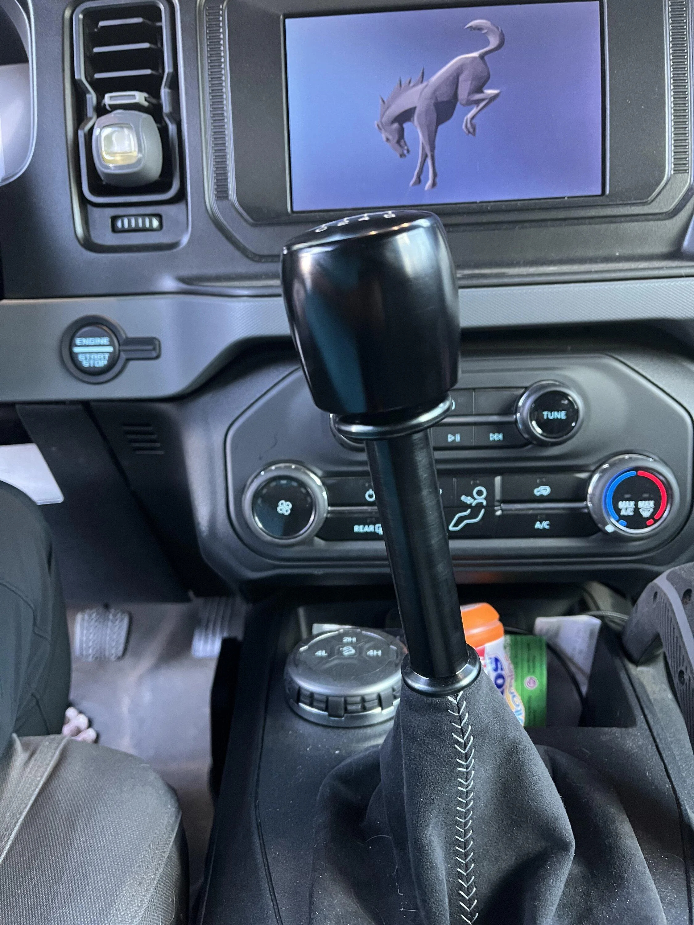

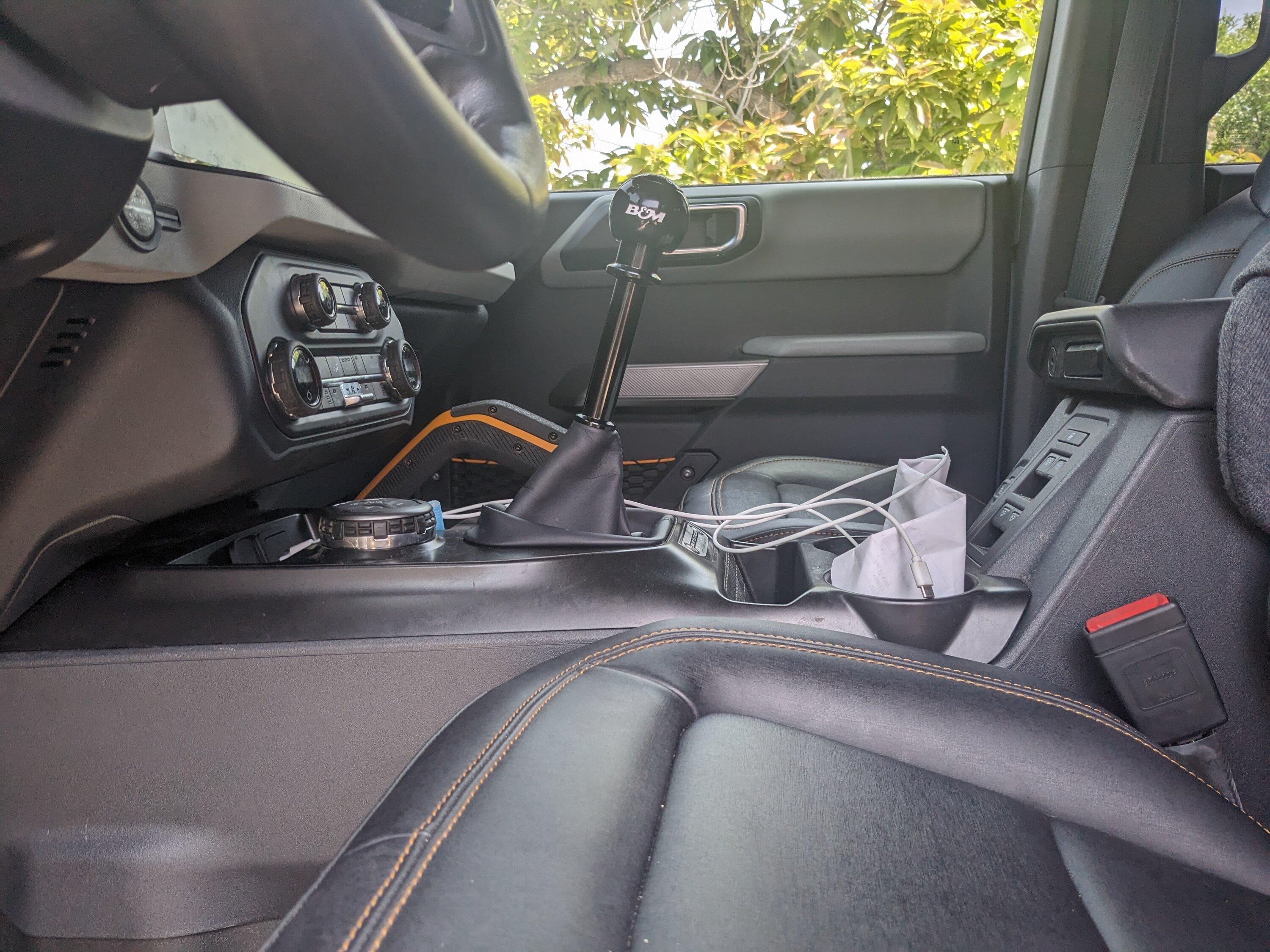

Alright just finished ran a little over 3 hours. Murphy is an A-hole, damn near 1 hour was spent trying to separate the lower shift cable. Eventually I said F it after breaking two forked trim tools and grabbed some needle nose pliers. Came off in 30 seconds after that. I skipped ahead at that step to I think #17 to remove the harness bracket to give myself more room to work with my fat hands. After that things went pretty smooth aside from the usual where did I put my socket?
It's a good thing the retaining clip isn't reused because it's probably starting its second trip around the sun right now.
Tools and sizes you need so you're not walking back and forth:
7mm, 8mm, and 13mm sockets and get some extensions.
3mm hex key, I think a 2 or 2.5mm for B&M extension set screw.
And I forget which torx bit for the grab handle.
If you have lux package there's a few extra wires you have to unplug, no biggie.

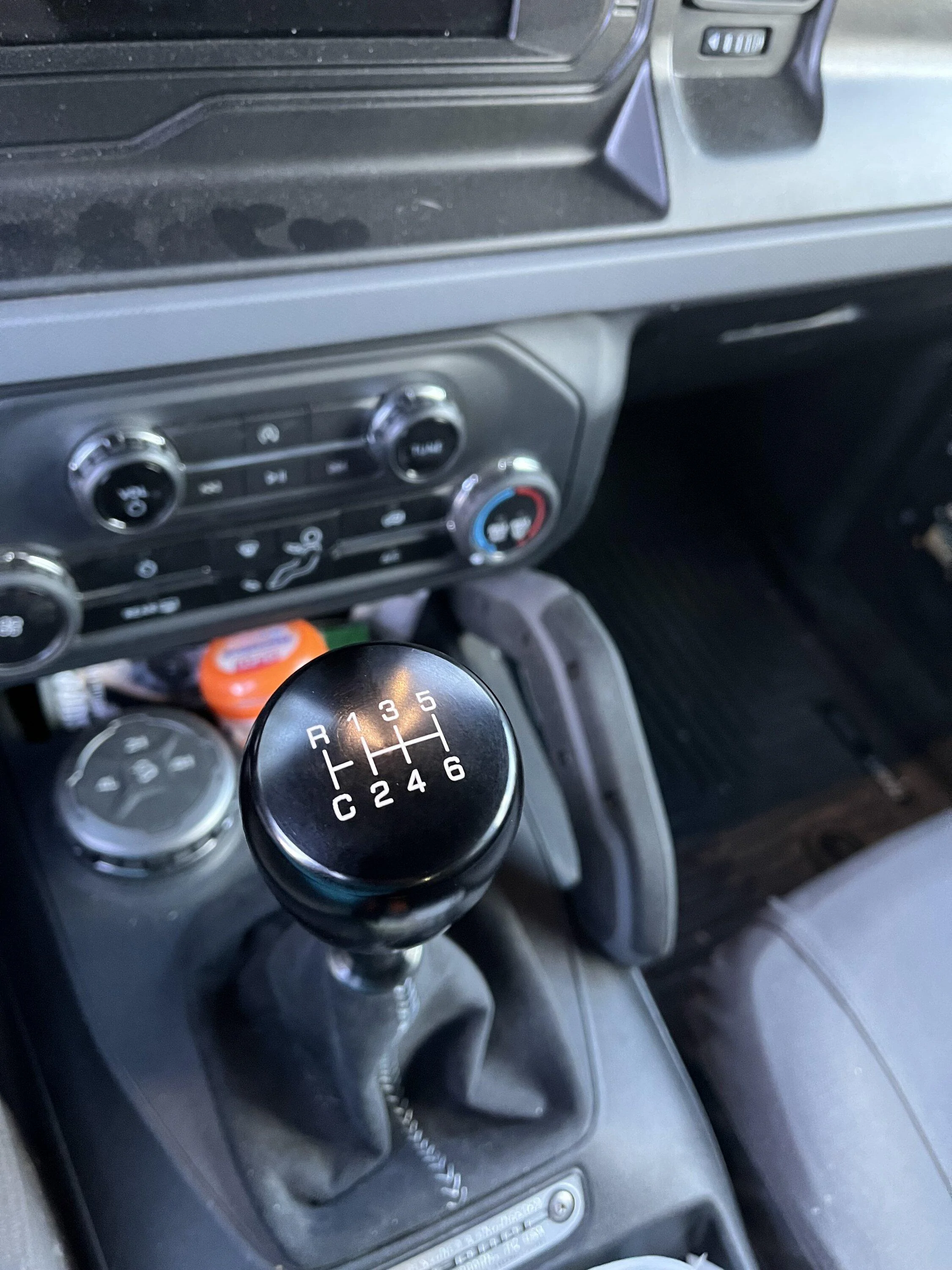

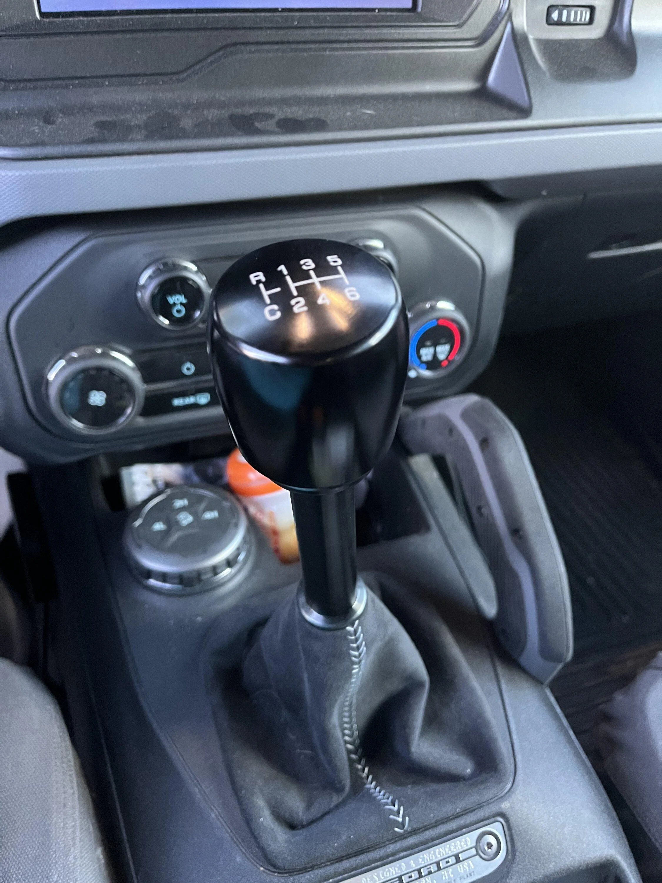

I had to adjust my cables to get full throw to C/2nd/4th/6th. Could been because I had a trans put in under warranty last week, or just cause the shifter is a little different, but now it's MINT. Really like the tactile feel, throw, and hieght. Definitely not switching it back now!
