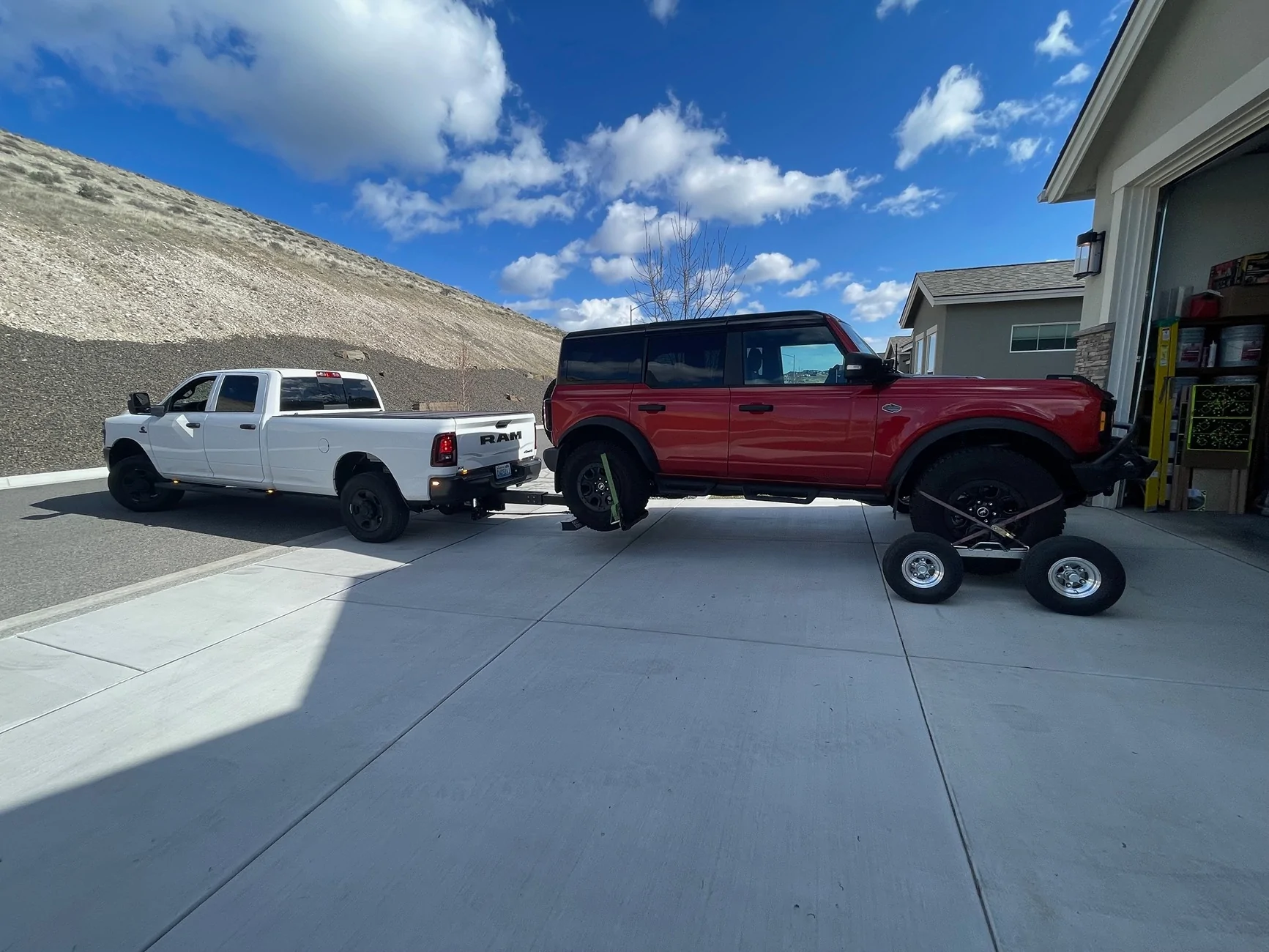

In my case, we just got back from a weeklong camping/fishing trip in the Mammoth Mountain area, so my Bronco sat in the driveway for that week, we took my F-350 to haul camping gear, float tubes ect. We got back and went to move cars out of the driveway and the Bronco got the "Fob Not detected" massage, I tried the second fob, no go, put them in the little pocket in the center console, no go, new fob batteries, no go, charged the starting battery (it sat for a week), no go.
I called ford and had it towed to the dealership, but.... with the way it was sitting in the driveway they had to tow it from the front. Since I could not put the ignition in Accessory mode it would not shift into neutral or go into flat tow mode to free the rear wheels. I did the manual override with a screwdriver under the boot and moved it into Neutral, but..... with anti-roll away safety system, after a couple feet the parking park locked up and it would not roll. I've read the ignition has to be in Accessory Mode to turn off the parking brake, which I could not do...... so they towed it on skates to the dealership.
After being at the dealership a week they determined the BCM failed and since I bought it from them 4 months prior, they graciously replaced it under warranty. no problems since.
I hope I'm missing something with the parking brake issue, not being able to put the ignition in Accessory mode to unlock the parking brake and put it in flat tow mode makes you a stationary brick, if this happens a down a long 4x4 trail and you can't be towed out.... I have to be missing something....

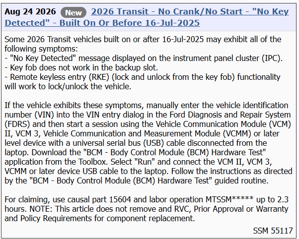

That would be SSM 55117...

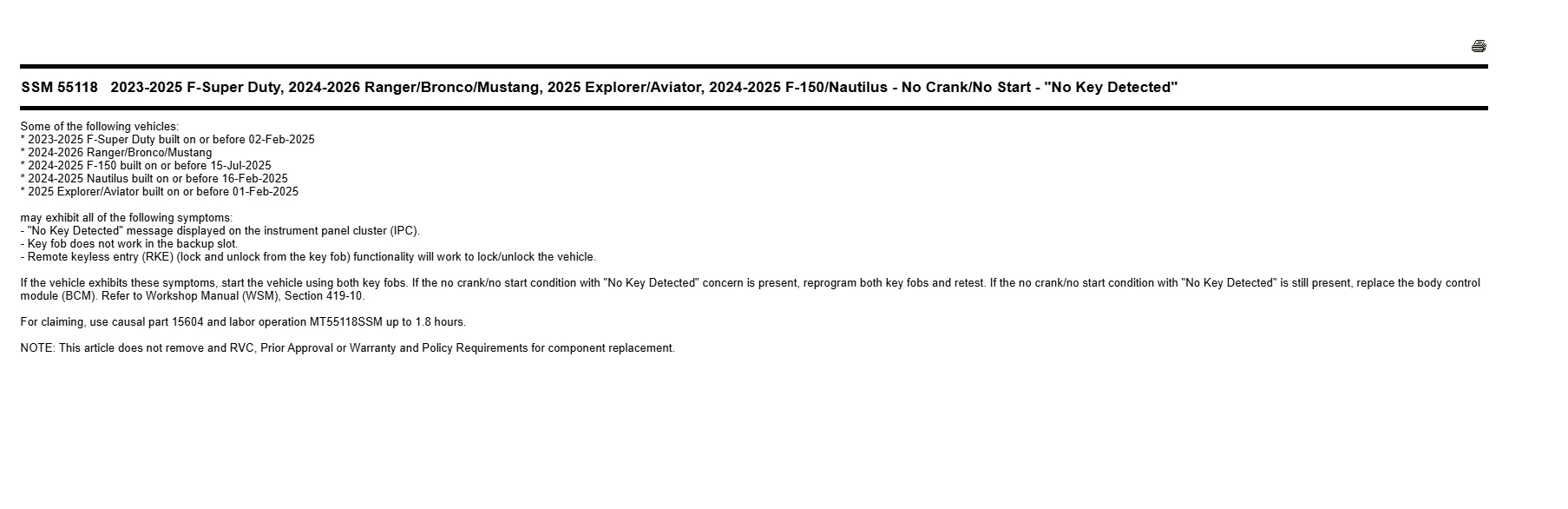

Similar, but this is the correct one:
Actually one is from the PTS home page announcing it...and the other is what you get if you put "55117" into the search box at the top of the page. They're the same thing.
55117 is 26 Transit alone
55118 is 24-26 Bronco (and other models)
Ahh I see that now...you're spot on. It's apparently the same fix though.... a new BCM if nothing else works.
