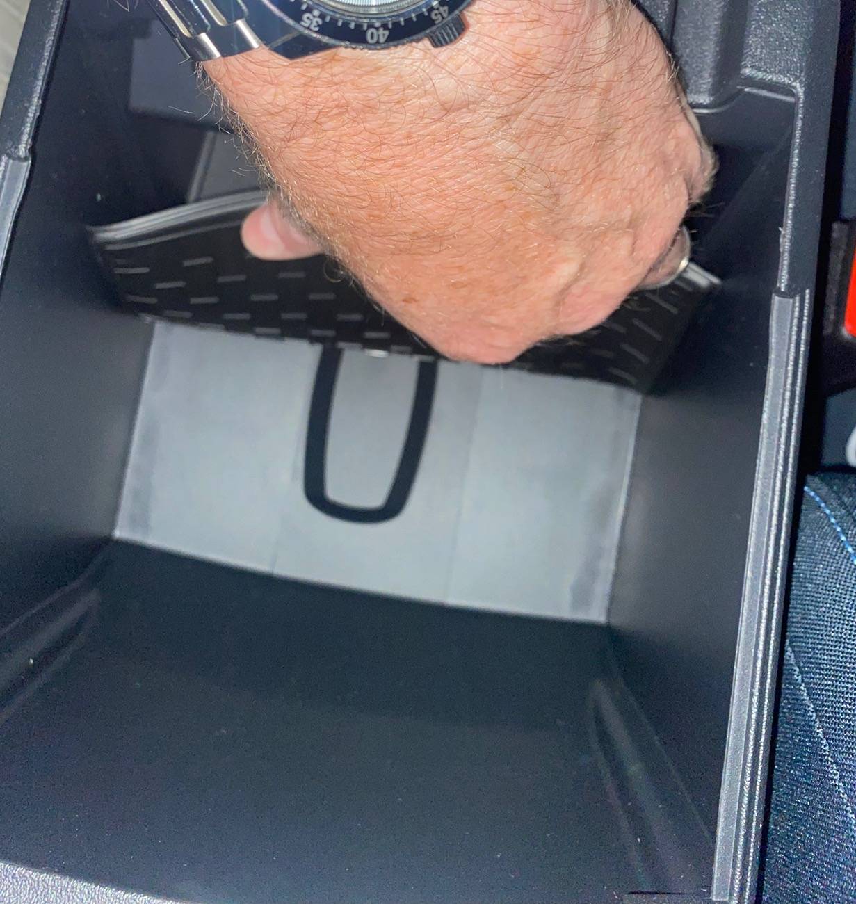

I know it’s a dumb question but I have to ask, did you touch the key to the bottom of the center console to re-establish the connection?
Hasn’t happened to me but I didn’t know this procedure was a thing. Guess I need to reread the whole manual.

Just checked mine. I never noticed the slot because it’s hiding under the rubber liner at the bottom.
Yeah, tried the slot and some other things on the boards. No luck.
