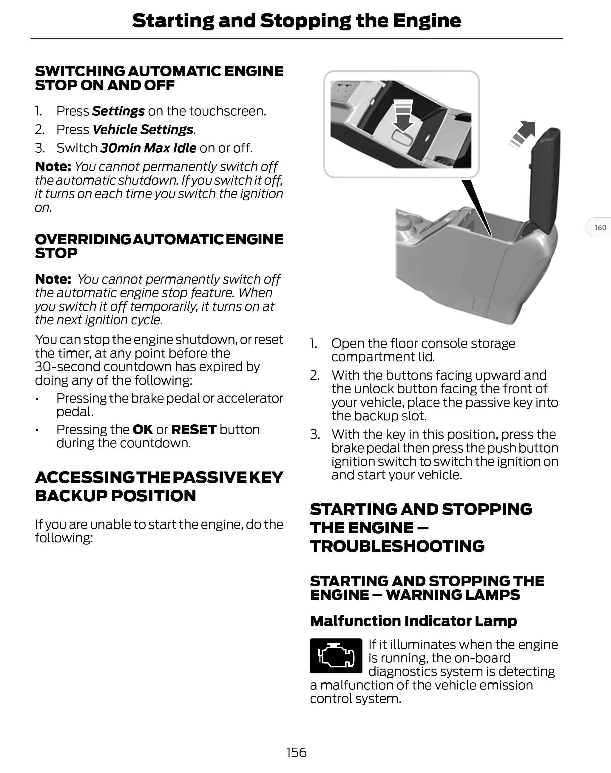

I got that error message multiple times yesterday during a trail run, so it may be a bug?
Remember, you always have a fallback plan in the owner’s manual if you cannot get your engine to start normally with the key fob inside the vehicle (i.e., “Accessing the Passive Key Backup Position”)…
This saved my bacon tonight thank you.
My 2023 showed no key detected but the lock and unlock worked. Used the console slot, got it started and picked the key up and tossed it in the tray under the radio like I normally do… wouldn’t let me put it in gear. Had to dig out my console again and put it back in the slot and Bronco allowed me to put it in gear.
Next time I stopped I had no issues. Very strange.

Why not just let the driver use the physical key into a traditional ignition switch.
They do have the slot in the console.
My VW and my Ford C-Max (and my previous Chrysler van) each let you simply hold the key up to the steering column where a physical key would normally go, then you press the start button. Yeah, it's aggravating that the Bronco team put it in the center console--but every car like this has a way to start the car via physical proximity of the key.
Now, if it starts and runs you're supposed to be able to use the vehicle normally. Put it in gear and drive away. If THAT doesn't happen, something's wrong.
