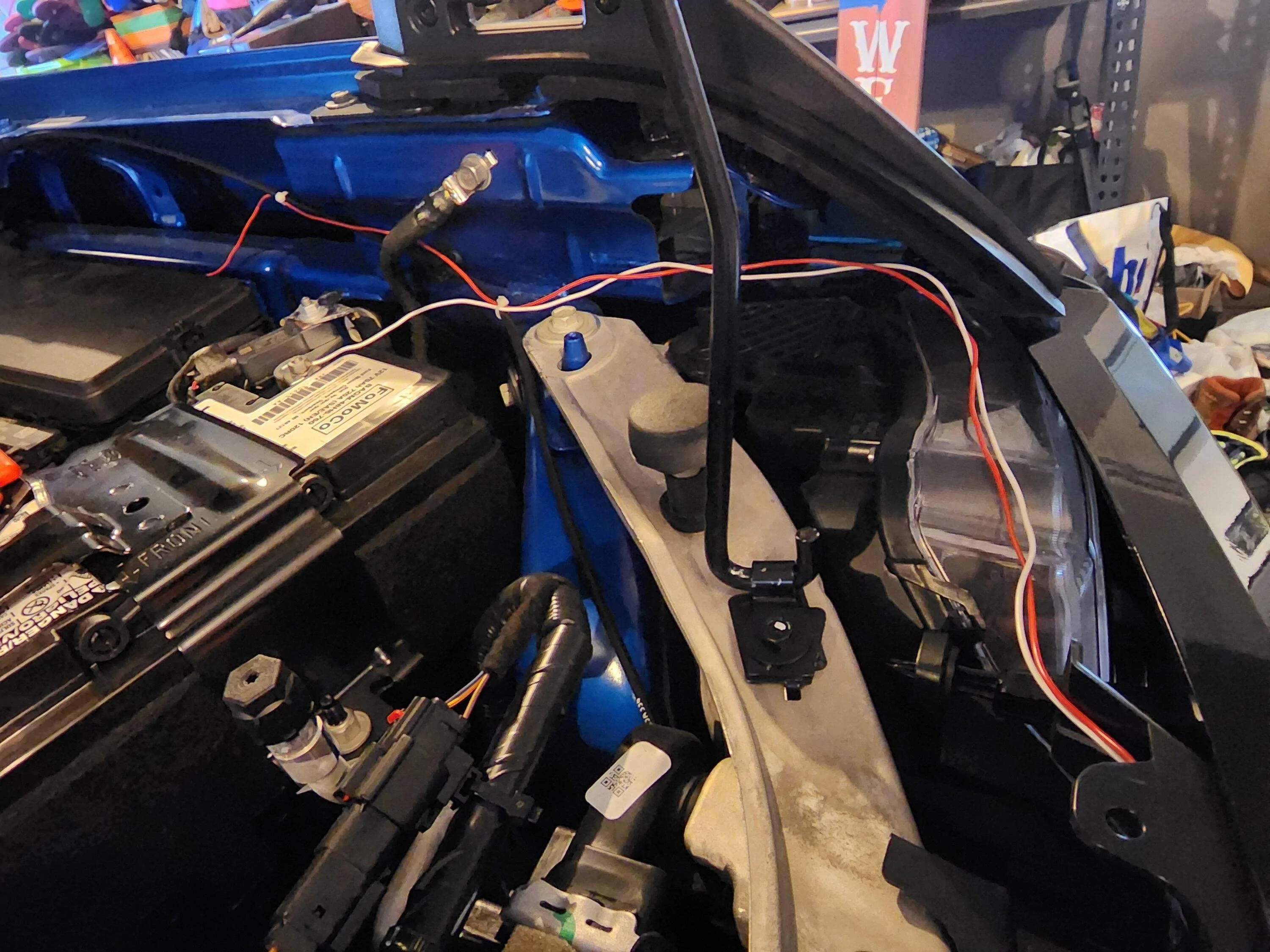

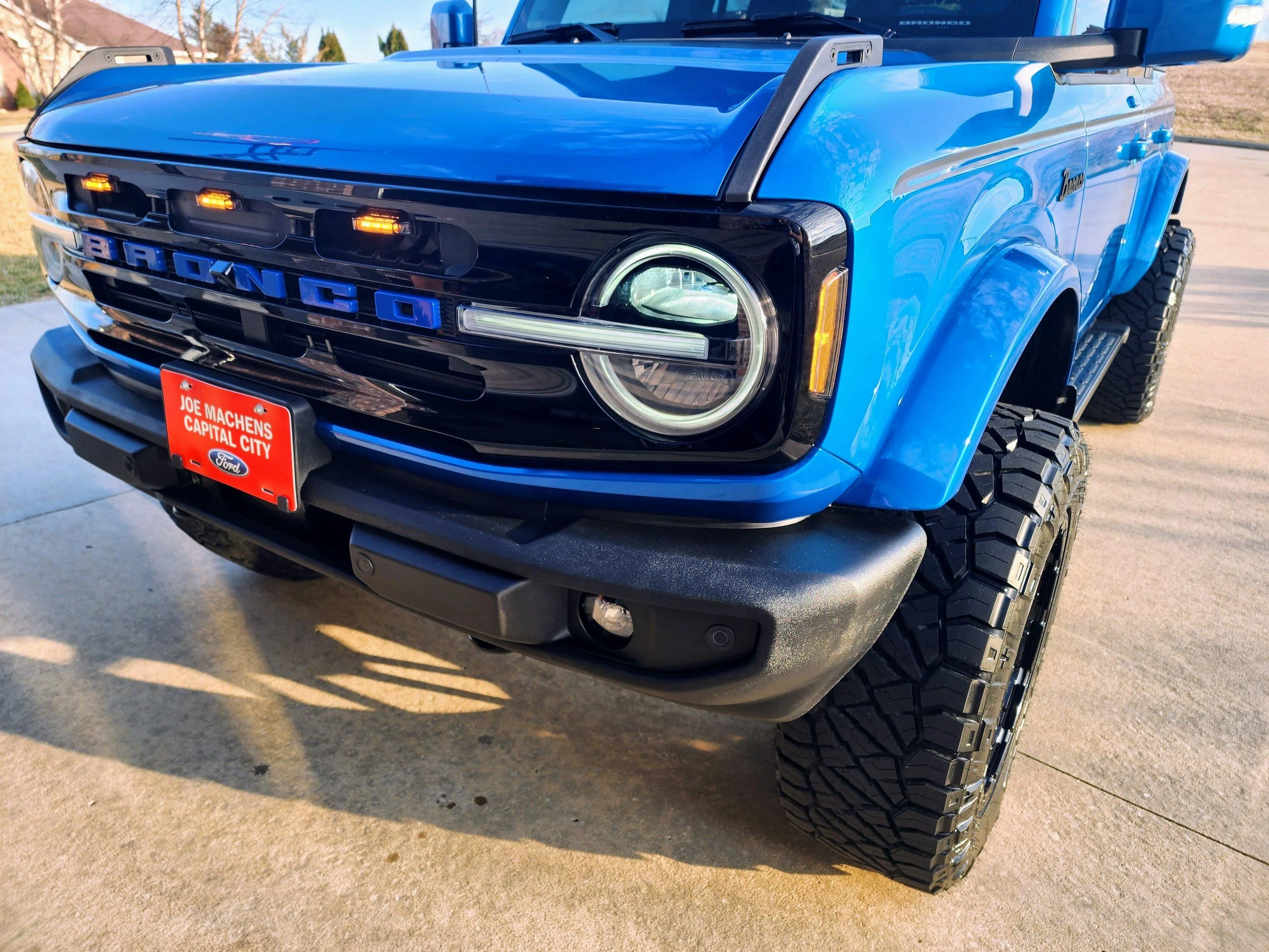

Looks good. Interested to hear how you did your 3 amber marker lights in the grille. Yours is the first one I’ve ever seen with the OBX or Big Bend grille to pull off the 3 marker lights. Many kits are available for all the other trim grilles, but not the OBX / Big Bend shaped grilles.

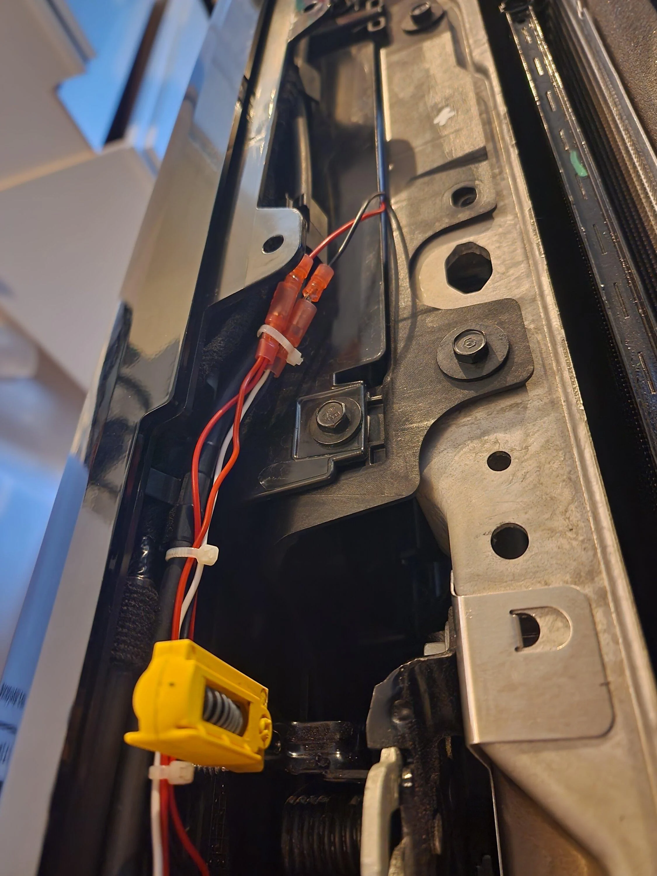

Thanks. Here's a link to another thread where I put a few details. It was honestly super easy. If you need more Info, let me know and I'll do my best to get you pics or anything else. https://www.bronco6g.com/forum/threads/outer-banks-grille-question.33215/post-1796619

Awesome, thanks for the help! Totally missed that thread. That's all I needed, as I can take it from there.

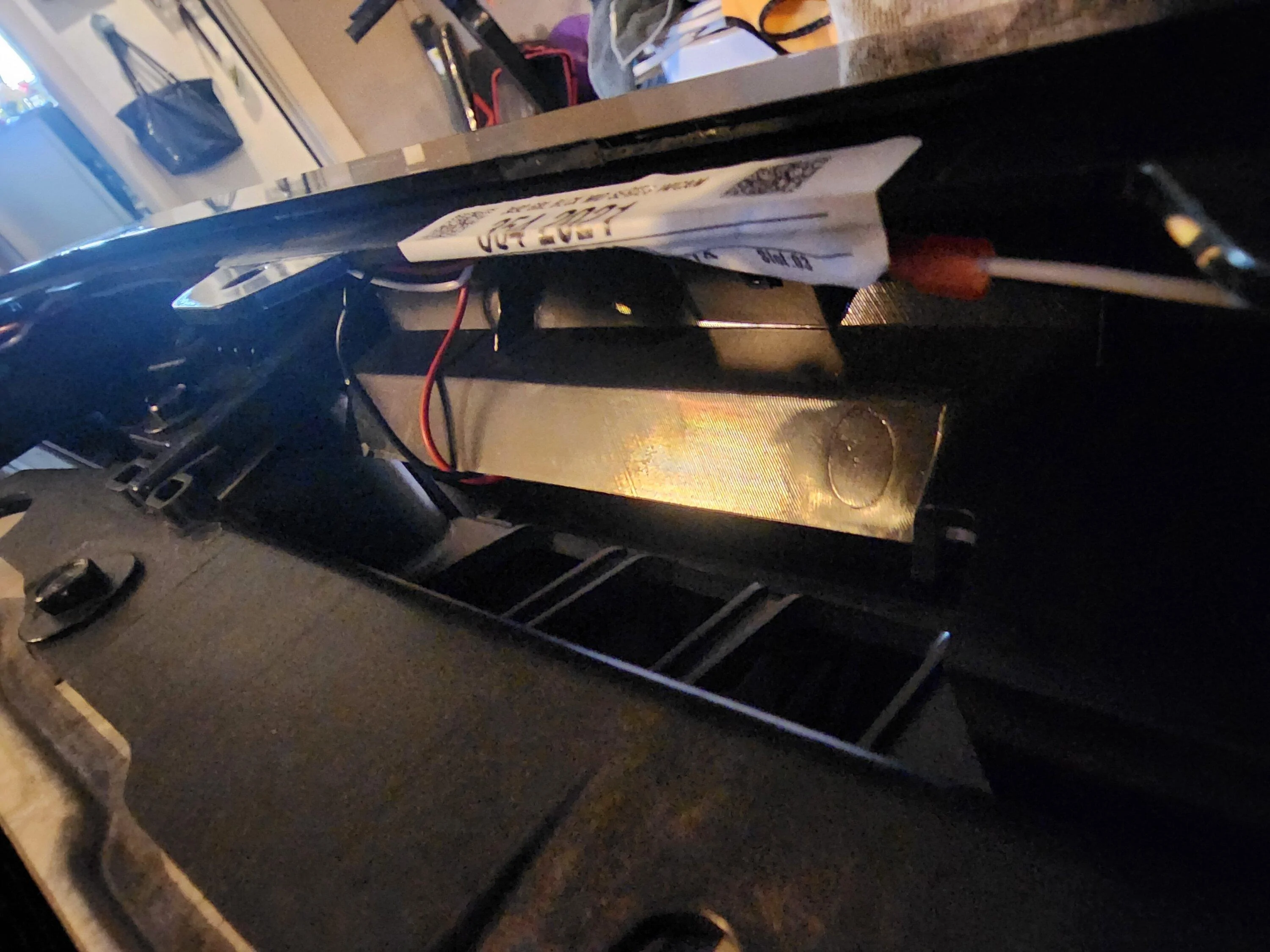

For the outer 2 lights, I actually cut a block of wood (painted it black), 3/4" tall, 1/2 deep, and 4" wide. I screwed the amber lights to the block, and used 3m adhesive on the top of the block to stick it to the top/inside of the grille since there is a flat spot there (it would be possible to drive a couple screws through the plastic into the block if u want). It's super solid, they're not going anywhere. The only obx prefab kit I've seen is 2 lights and $100, mine was less than $30.

Great, thanks. Yes, I've seen the 2 light kit before......but it's just not right without the 3rd light!

Looks good. I’d wrap all those wires in conduit, for aesthetics and a complete job commensurate with your great looking build. Practicality concerns also tell me in-protected wires rub through and eventually short. Plastic conduit is cheap, and adds to the install time of anything you are doing, but I would do it.
