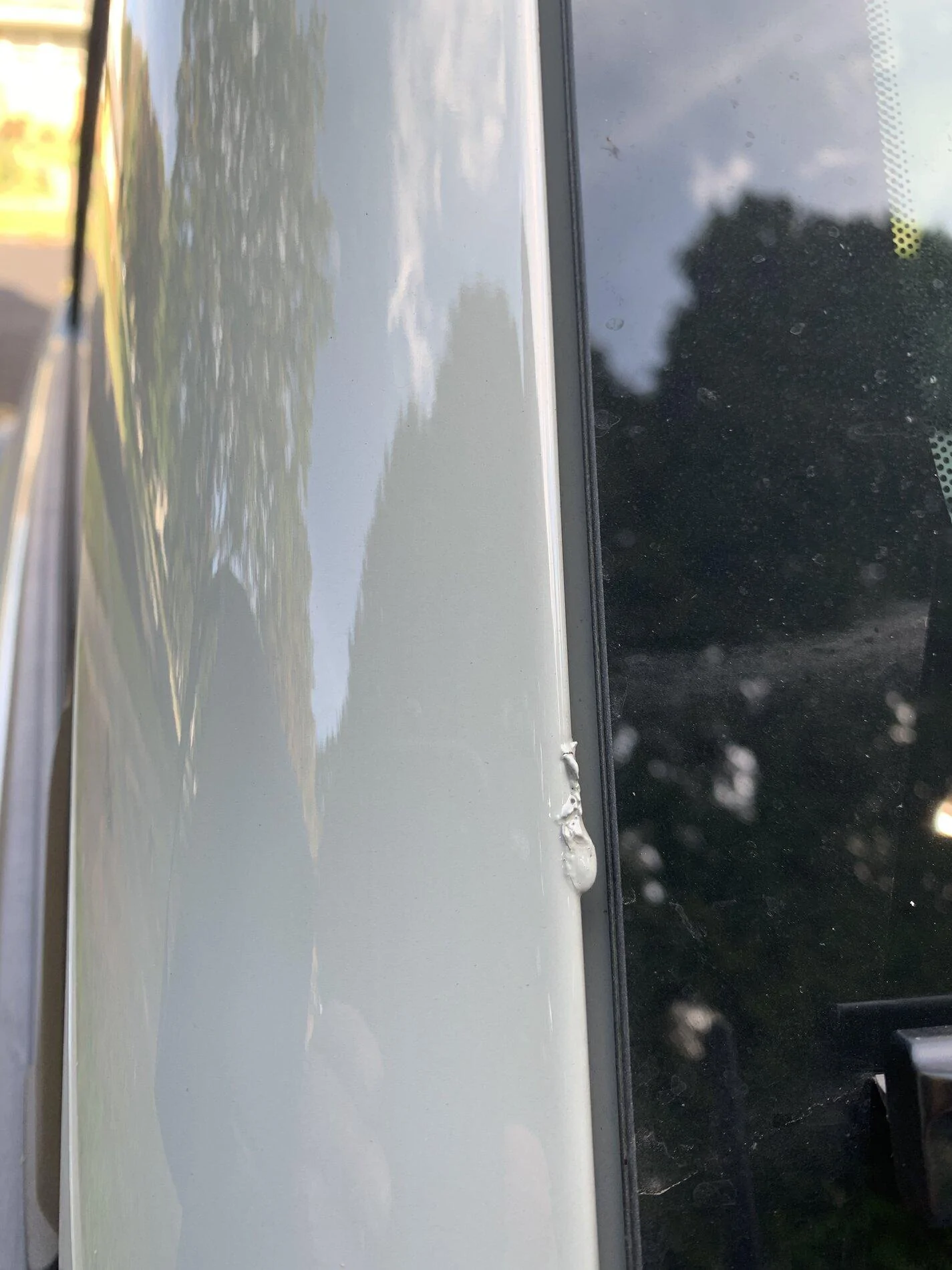

I have some similar issues on my paint and intend on having the dealer correct it under warranty. A few small bubbles on various panels, if Iā€™m being pretty picky (which I guess I am). In addition, the bottom of the doors appear to have some paint drips and I have a ā€œglobā€ of extra material on the passenger side a-pillar.
I posted this picture in the QC thread, but figure it applies here as well.
Ford Bronco Paint Issues 18005C92-0704-4520-9DC2-D3E693BCB529
WHAT THE ACTUAL F?! That is one of the poorest representations of paint QC I have seen yet. How big is that glob?
Not acceptable. If thatā€™s representative of what an average Bronco will look like at delivery mine will be going strait to a reputable body shop for paint repairs.
Wow!! How that made it through QC boggles the mind. I'd be pissed.
