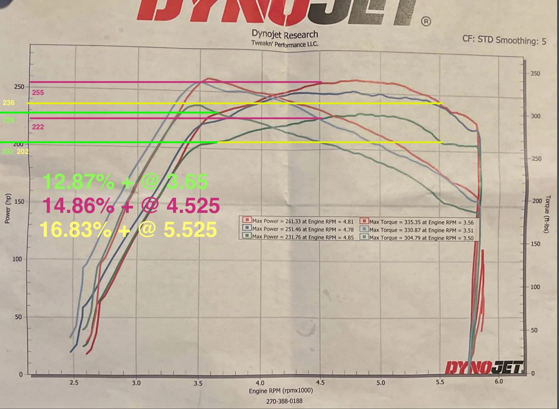

I have been running the Panda motorworks Panda Power Module for a while now, I have been enjoying it, and by the butt dyno, I can tell a difference,
especially if you put the Bronco in Sport mode, then crank the power module up to 7.
Finally got a chance to see what the results were on an actual dyno.
Attached PDF of results.

Awesome Video Bill! Happy to see more verified dyno results out in wild! And you hit the nail on the head when comparing the graphs. The largest gains are not peak power, but rather the heart of the power band where you will be driving the most time anyway. Happy to see you enjoying the product!

Never ever ever put horsepower and torque on different scales. It took me a second to figure out why the curves looked all messed up.
Took me a minute to figure out why the didn't cross at 5252rpm.
Thanks for does this

Thank you for sharing this info. Just FYI... gains at peak hp & tq are 12.76% and 10.027% (not 15%) respectively. Would be curious if the place you did your pull could calculate the max percentage gains throughout the rev band vs just at peak numbers ?

Rough calculations at different rev ranges. I tried to plot out 3 in the 3/4/5k range.
Ford Bronco Panda Power Module Tested on 2.7 with dyno results DYNO_PPM
