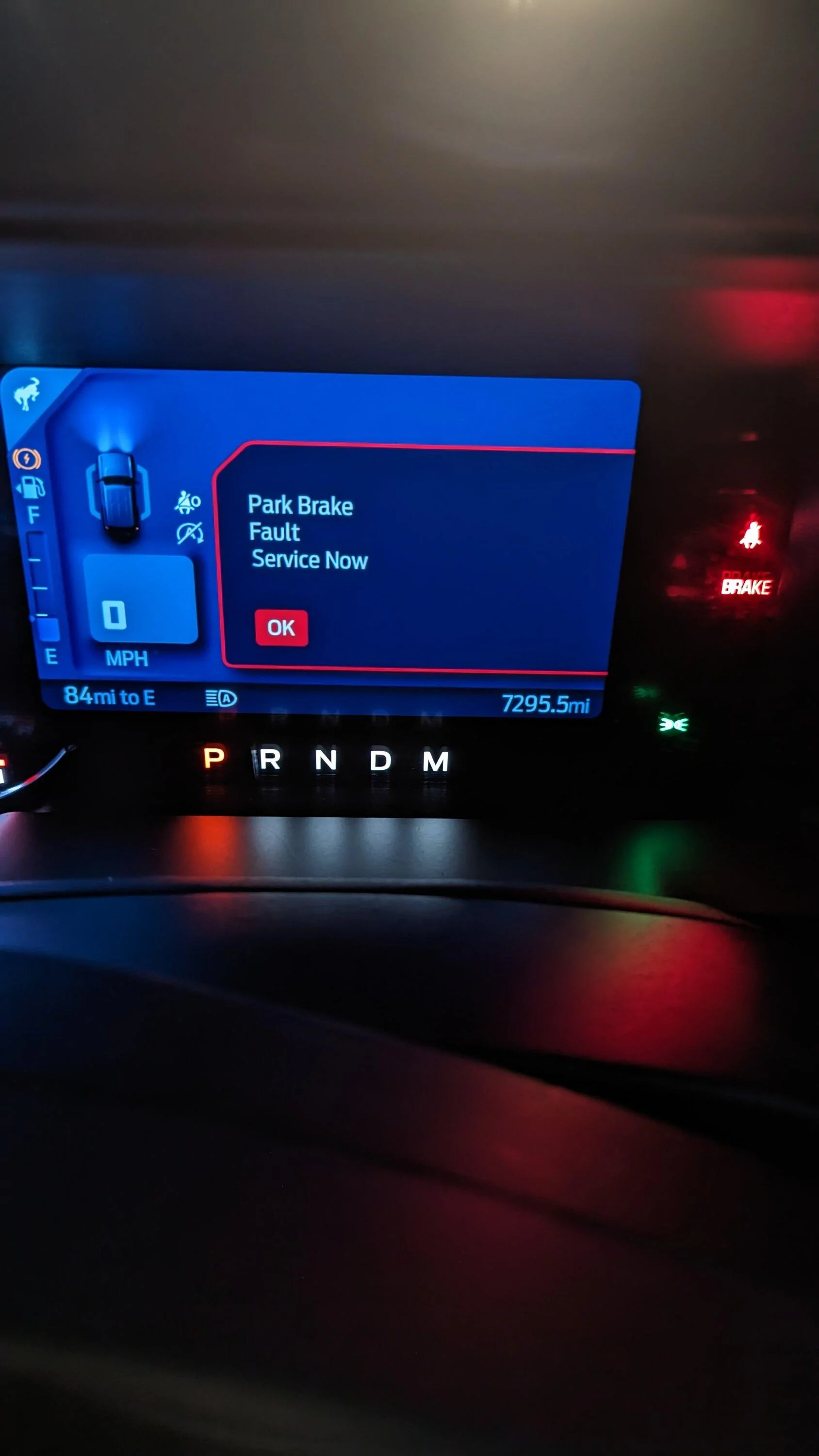

Anyone see this yet?
Ford Bronco Park brake failure PXL_20230224_233910483
Lots of loud alarms.

I randomly had that a couple months ago. Restarted and went away.

Parking Brake broke, or just taking a break.
Can you still hear it engaging when activated?

no. it won't engage. and i thought bc it was the parking break i'd still be able to drive it. but more alarms starting going off and flashing lights. I didn't make it 40yds before i turned around and parked it back in the driveway.
haven't started it this morning yet tho.

Thx. I promise you, no lie, I searched and nothing came up. Why I created this post. :)
Now, the alarm goes off before I even turn the car on. As soon as I open the door it starts dinging and flashing.
Anyway, having it towed today. since it's a brake alarm, I'm not risking it. Dealer can fix it first before I drive it again.

To update... Ford towed it and the dealer fixed it. Reason I was told was an OTA update messed up the electronic park software. Re-install fixed it right up.

FYI - I had this happen and it wasn’t the update. I engaged the parking brake and when I went to disengage it gave me this error. Despite that, it would make an audible noise when engaging/disengaging and would act differently, so it was clearly working in some form or fashion. But that wouldn’t stop it from beeping non-stop. Turns out it needed a new motor for it, and they’re seeing this happen with some of these. It was covered under warranty. Nothing like complicating a parking brake. I hope this helps someone!

Great... I had the parking brake error today while running errands. Popped up when I opened the door, before even starting it. I was parked on a very slight incline, so it may have tried to apply it while I was in the store. It went away after I started so I didn't sweat it.

Ok just looked at the receipt. Unfortunately no price is listed. But the official part that had to be replaced was the actuator motor.
