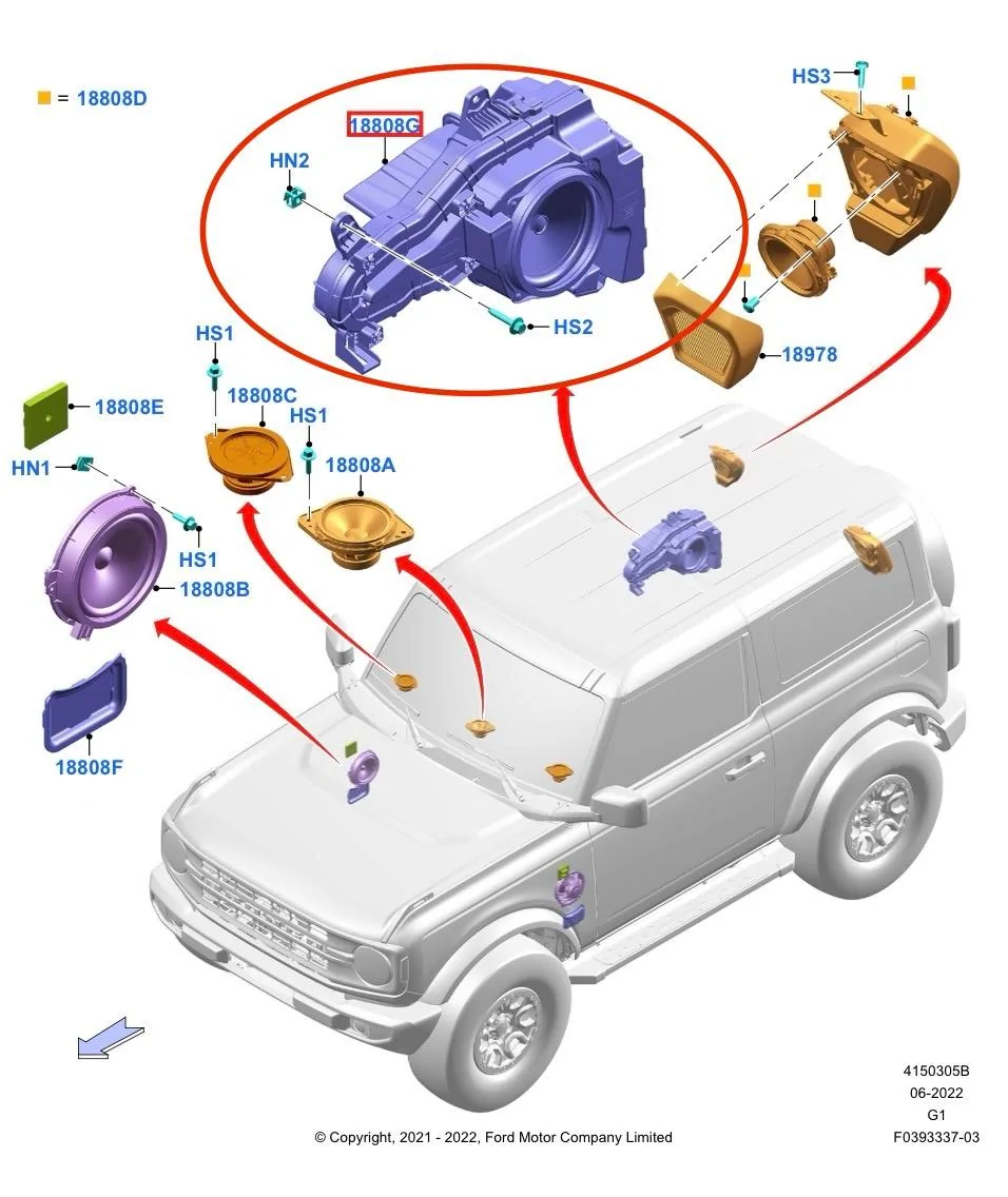

Does anyone know what the part number is for the factory oem subwoofer?

M2DZ-18808-L is the newest part number.
Looks like that is a complete assembly with housing, about $300. The speaker is not likely avail by itself.
Nice that MontanaBronco is offering you one!
Yep, not available separately.

i guess back to the original question anyone know if the subwoofer speaker is available to purchase alone without the enclosure and what the part number might be?

The B&O speaker is larger(almost 8”). For a near OEM replacement you can use the Kicker 6.75 subwoofer. Fits perfectly. Folks have also been using a Ford Fusion amp since it utilizes the same OEM connector. Many threads about this.

yea I’ve read most of the posts regarding the fusion amp and the kicker. I really wanted to try and locate the original sub speaker driver rather than go with the kicker I already purchased the fusion amp so I just wanted to see what the original speaker might cost to replace my dummy speaker.
Not many out there to be had. The sub in the stock system was new for 2023. Ford put a few in until mid Dec then the delete was mandatory. Restarted a few months ago. Weird you can't buy just the speaker and have to get the entire enclosure. Probably in short supply.

Oh so the woofer is not available as a stand alone part. only part of the complete housing?
Yes. It’s only available as the whole housing.
