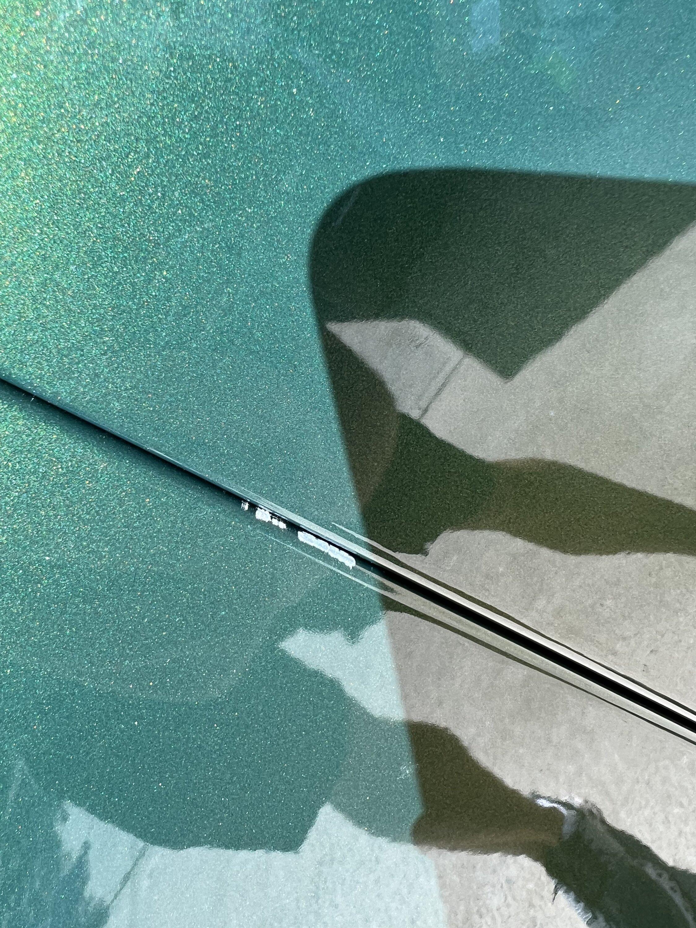

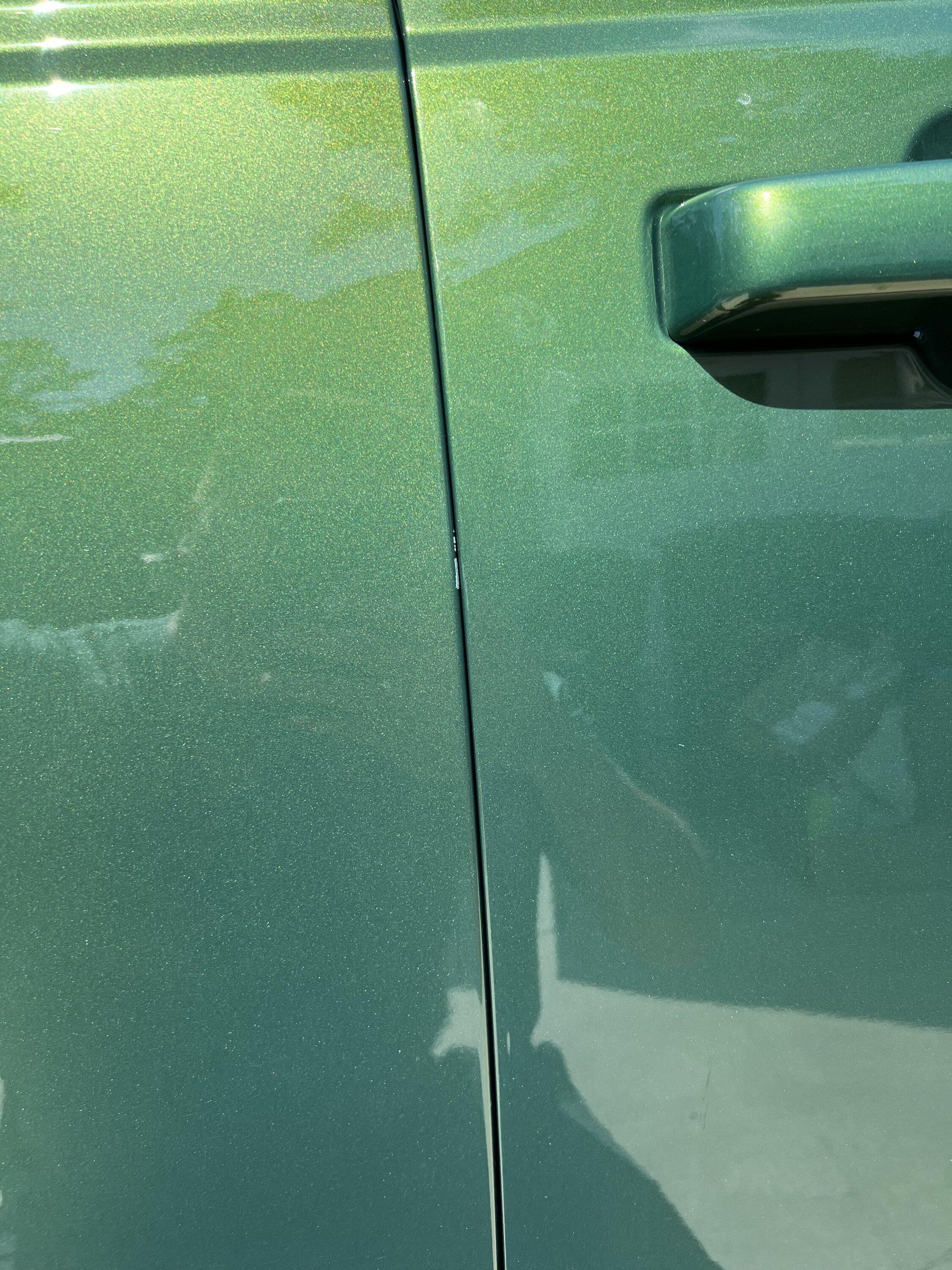

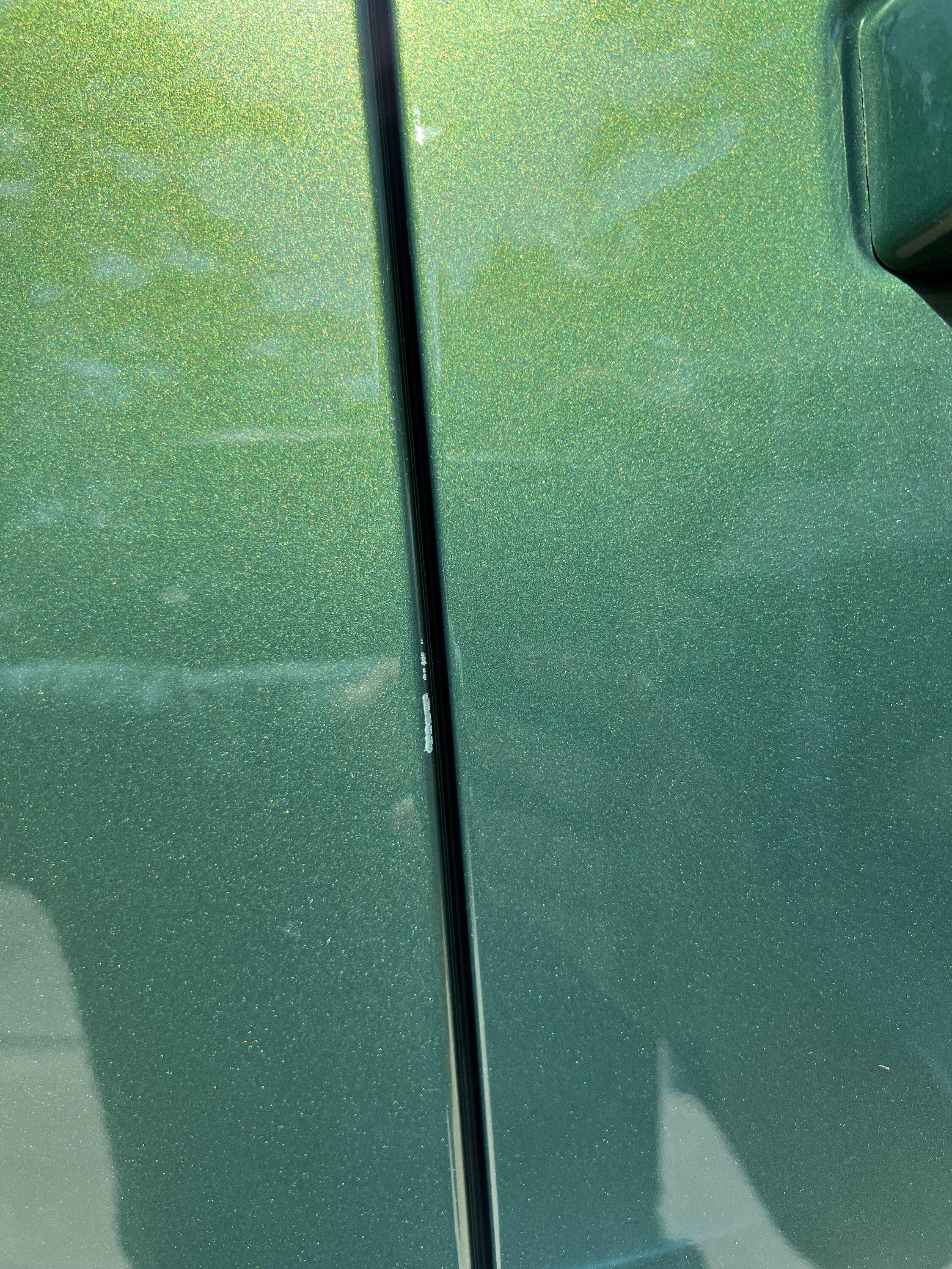

Guys—I’m livid. I take pretty impeccable care of my obx sas 4 door bronco. I’ve never taken the doors off, yet today I discovered a nasty rubbing issue between the passenger rear and front doors. See pictures for details.
This is somehow a new issue as I would have noticed this during washing and detailing. Door hinges and screws are all tight. Never had an impact on that side. I literally baby this vehicle. I now have an issue that obviously will need paint work done and I have zero clue how to fix it. Any optimism here for a dealer to cover the paintwork?
Gaps are all uniform the whole way down. And it only happens when the front passenger door is closed (obviously) and the rear door is opened.

While you may have never taken your doors off, check to see if the removable door pins are backing out....I have heard of this before.

Absolutely not normal….take it to the dealer. I’ve taken my doors off/on several times and don’t have this issue.

Are you absolutely sure that the rear door when opening is rubbing the front door? It looks as if the tapping is correct and I don't see how it would rub. And how that small area is spaced with paint remaining in between the scuff. It looks to me as if someone when to get in the front seat and scuffed the edge of the rear door. Is there a matching scuff on the that same area of the front door? Just my observation.

Checked all door pin bolts this morning. All very tight. Zero movement.
Anyone have any tips for trying to address the cosmetic in the interim? Wax? I don’t think I’m down to bare metal

Positive. I was able to recreate the issue after noticing the blemish. It’s a head scratcher for me too since the spacing is even down through the door jam.

I had a door not properly aligned on my truck. Took it to the dealership and they fixed it and corrected the paint scratch it was causing.
Mine was a bit different though - It was on the bottom right corner of the rear drivers side door was rubbing in the corner ever so slightly.

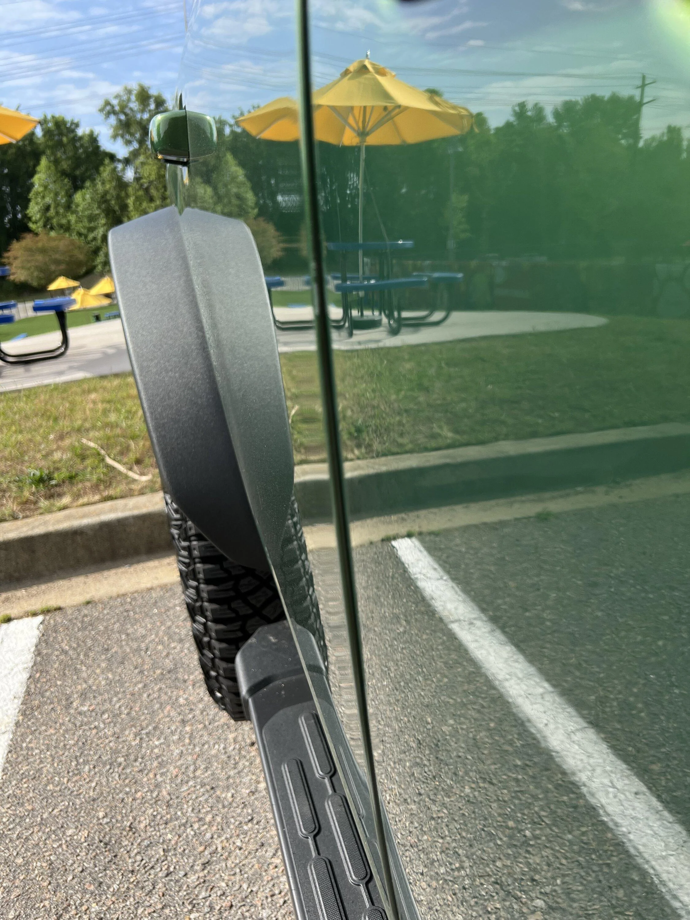

I think I may know the issue. It looks like the front passenger door is closing too far in relation to the back door. This offset i think is allowing for the rub. Does anyone know how to adjust this? I’m probably not going to do it, since I want a dealer to own up to it and fix the paint issue.

Anyone have any thoughts on fix for this? Video shines a lot of light on issue in real time
