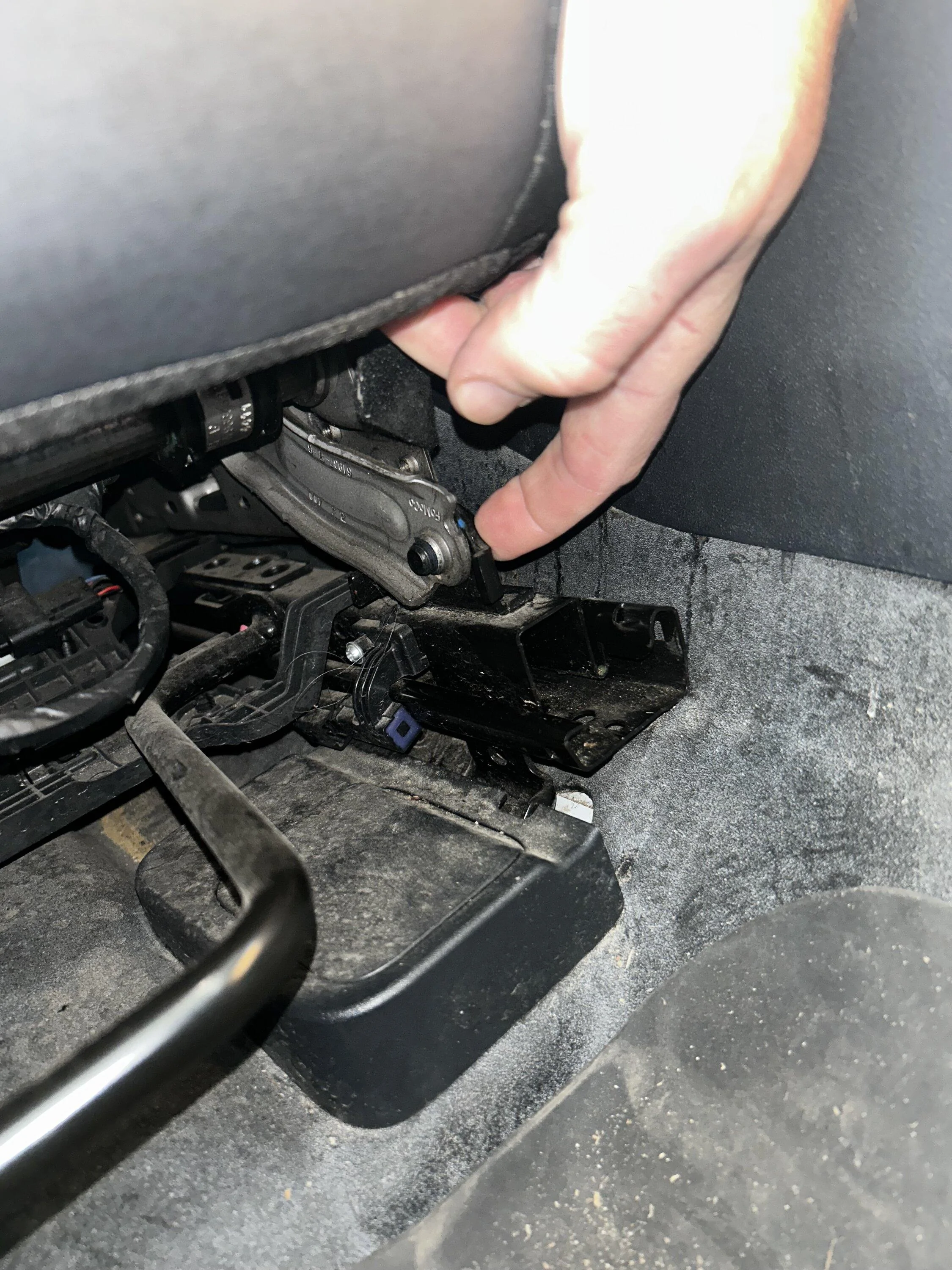

Happytown
Ryan
Nov 17, 2020
406
1,752
Zachary, Louisiana
2013 F150 Eco SCREW 4WD
On manual seats, Theres a bolt at each forward corner that loosens up. I,ve tightened mine twice, doing exactly what you are describing I’ll get you some pics

Happytown
Ryan
Nov 17, 2020
406
1,752
Zachary, Louisiana
Ford Bronco Passenger Seat Area Rattling IMG_3983
this is the bolt that keeps loosening up on mine. Its a very flat in profile shaped head with a star type head. If its loose, keep your eye on it and aggressively push the seatback back and forth, you’ll see the play in it. Your passenger may actually even complain of the seat feeling loose, that’s how I discovered mine
