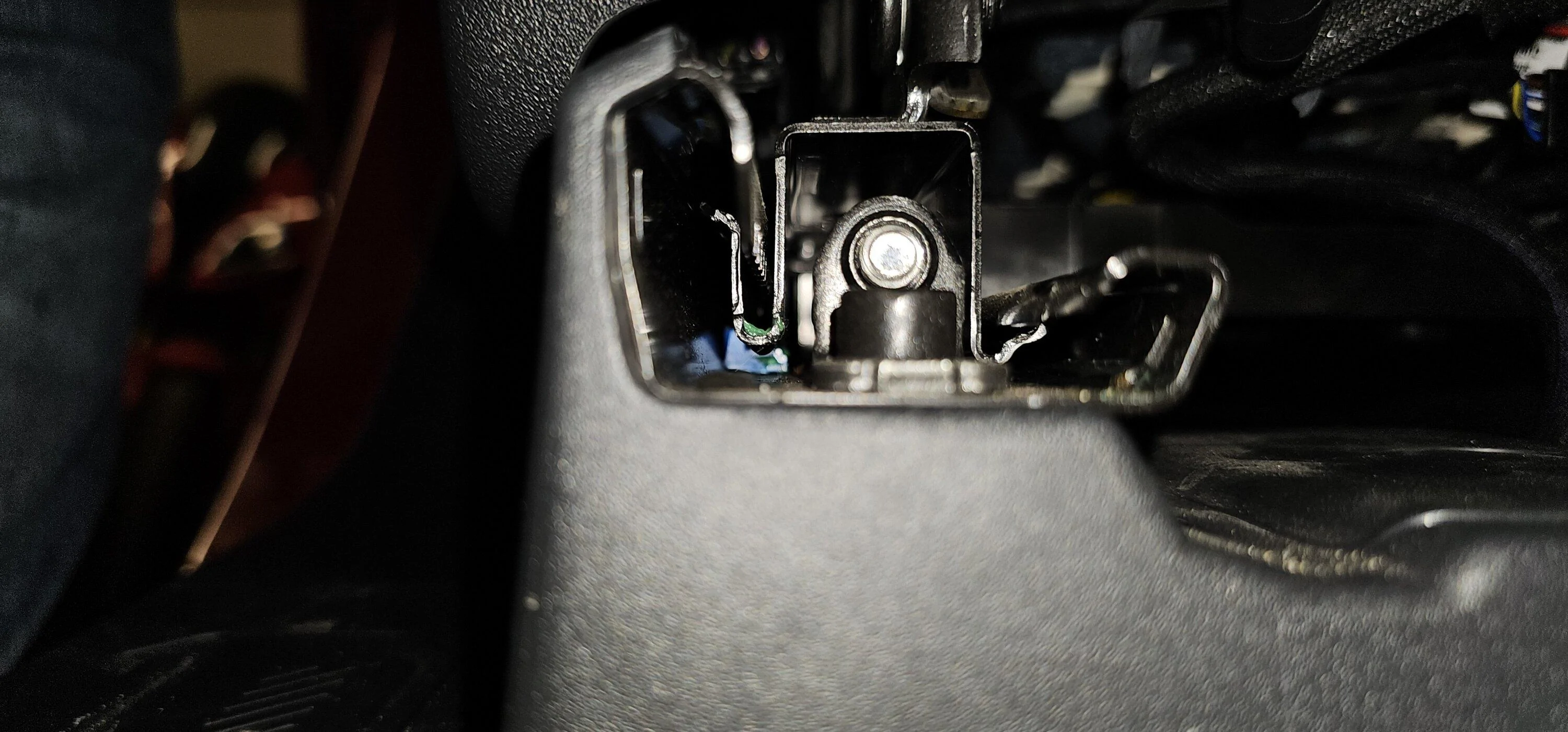

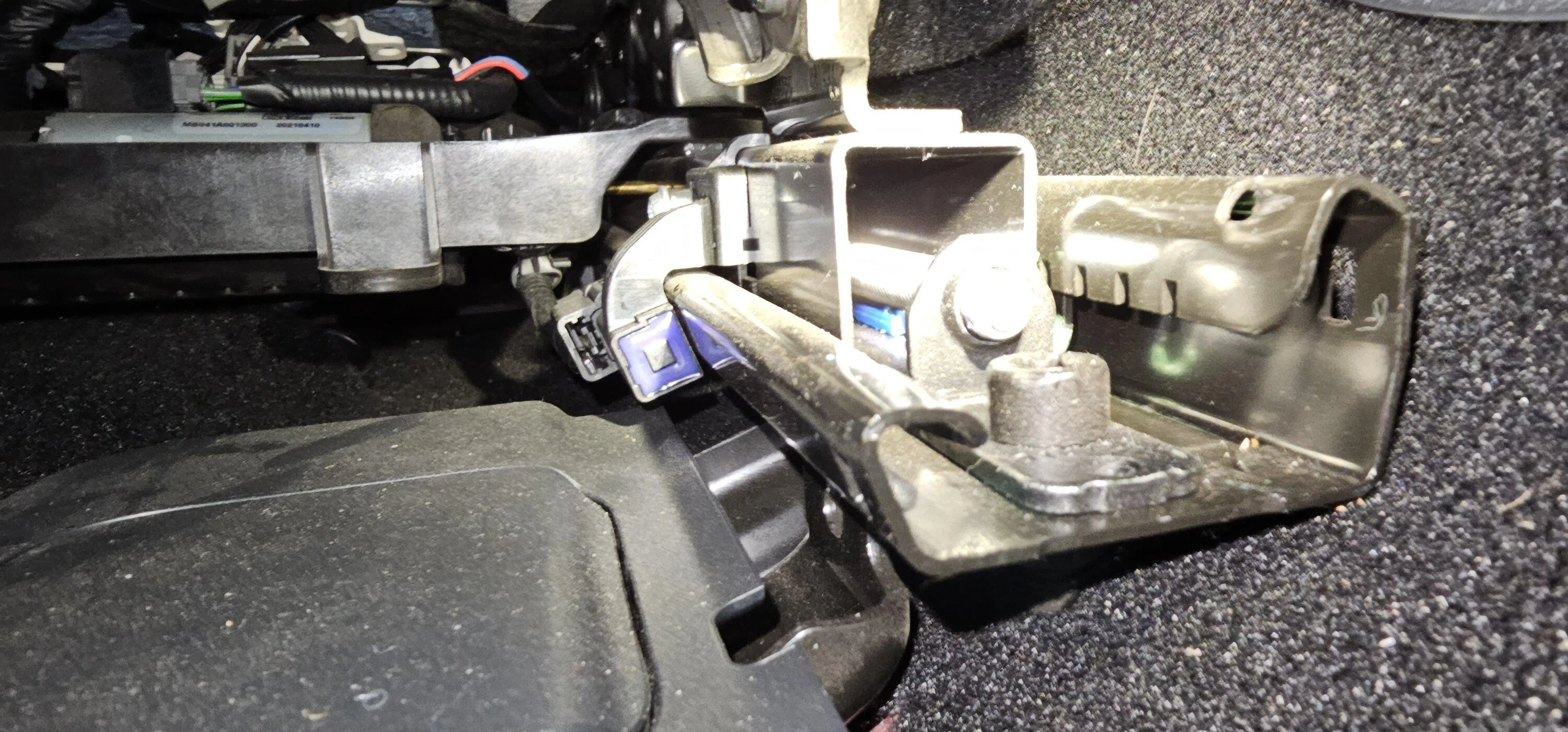

Here's a blurry picture of the guide plastic, from the front of the seat. Look from the back and you'll see it doesn't reach far enough back and those two rails rattle around because of that stupid decision. Thanks Ford.

Interesting. Doesn’t look like an easy fix and since we’re the only ones experiencing it, a recall isn’t likely anytime soon. Let me know if you come up with a solution. Thanks for the great feedback. Honestly I’m just glad to know I’m not the only one dealing with it and not the only one going crazy as a result. Lol
