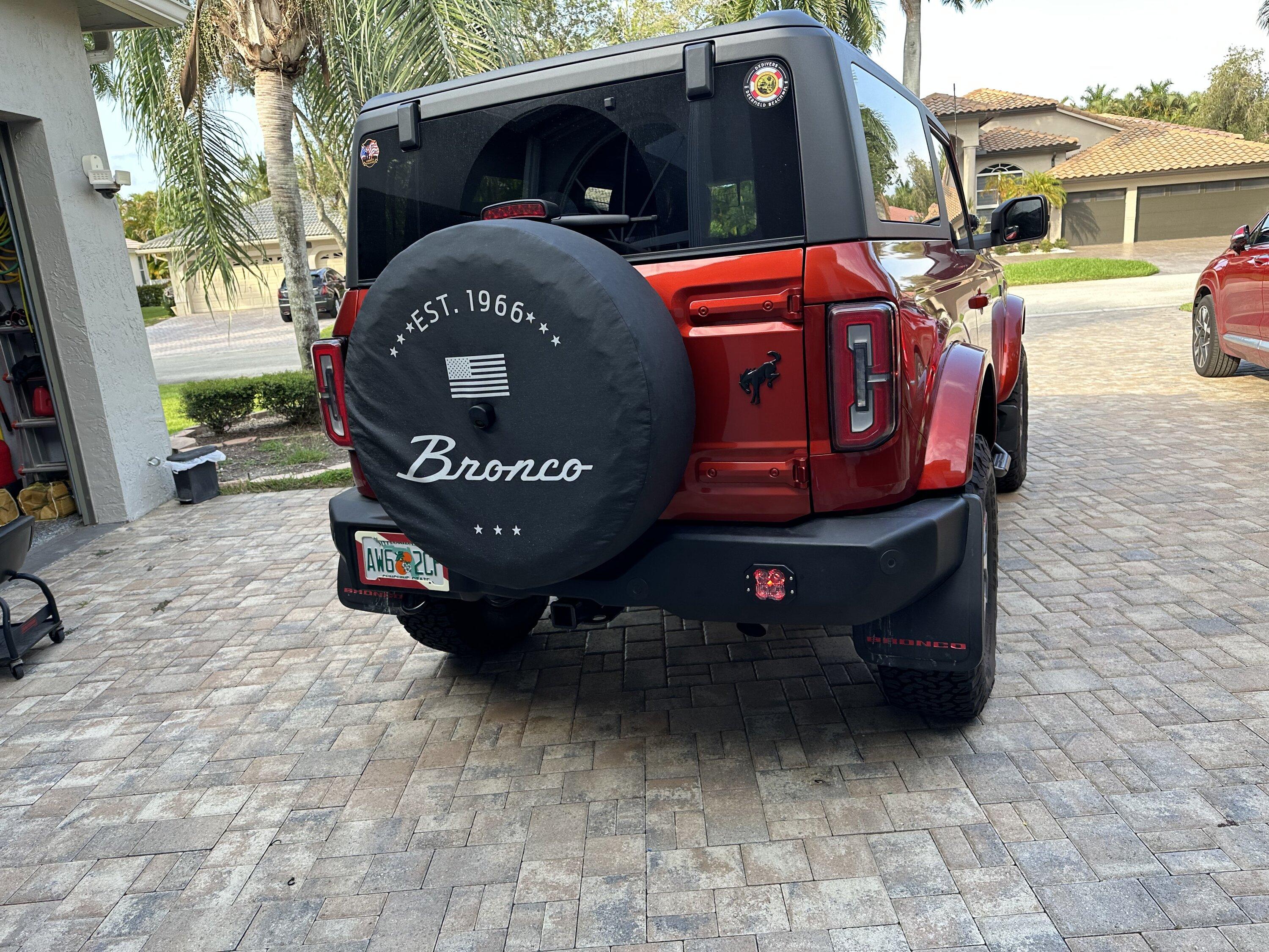

I just acquired both a capable and a rear steel bumper. Both need the sensor bezels, fronts have been ordered from Ford and will be here today or tomorrow. I also ordered the KR Off road dual aux light kit for the Capable bumper. That is this weekends project. Once the front is done, I will order the bezels for the rear bumper. Sadly most of the 6 parts needed are $9, but one is $88. It's a stupid plastic retainer. Anyway, I will order that once the front is on. Looks like a very clean swap. I just have to remove my backup light from my plastic bumper and cut it into my new steel bumper. Photo is the current plastic rear with light in it.

Was there much difference in weight between the rear steel and plastic bumpers?
There’s a difference but I didn’t notice it being a lot. Now the plastic front to modular front is a whole different story. It was drastically heavier.
