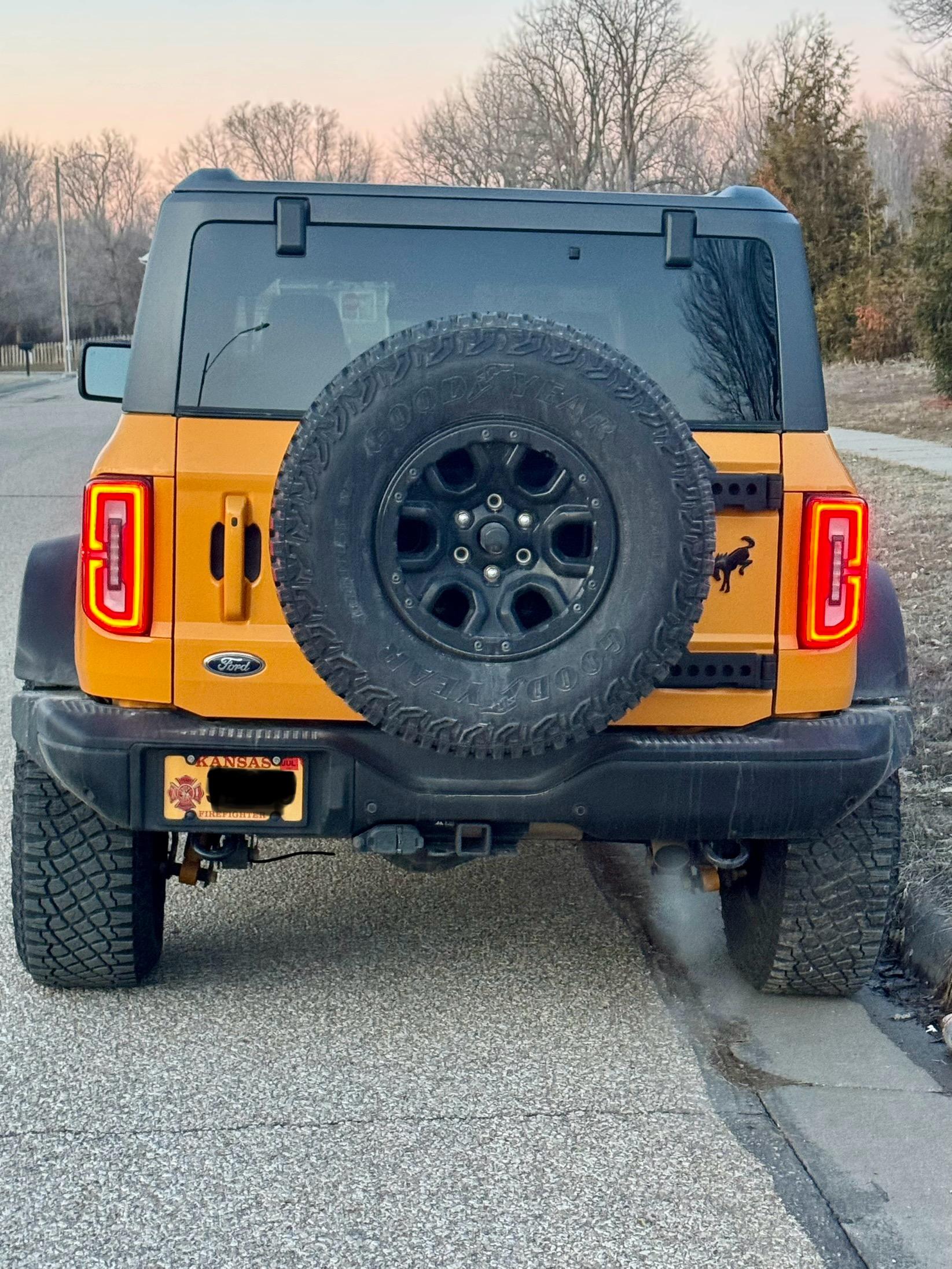

Got the bumper installed and the new keepers for the left and right sensors. Crazy that one side it stupid expensive and the other side was cheap. As far as the middle sensors, they just snap in without needing a retainer on the rear.
The only problem I had was the wire harness on the drivers side wouldn’t release from the body harness. So I damaged the body harness. Now just looking for the part numbers for the connectors inside the harness plug.

Looks great. I'll be doing this same mod soon on my OBX. So did you end up just buying a duplicate of the cheap retainer clip and it worked? Or did you buy the expensive one? Thank you.
